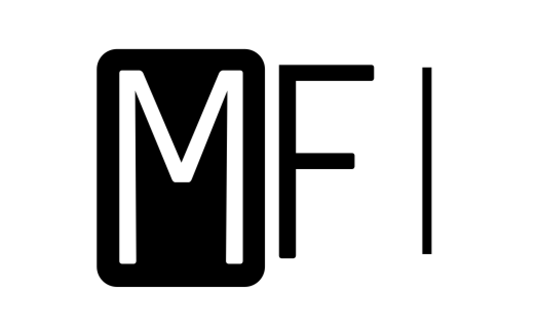

Decided to get rid of the F and work on the hard part (extended the M backdrop to even make it more problematic for testing). Getting decent at this, but think I've pushed the crayon to its limit.
Time to do some actual research about dye-subbing plastics with a laser (vs. just making $hit up). Unfortunately, this is pretty uncharted territory. We know enough about the properties of everything at this point to make some educated experiments going forward, but I would plan on Hajime being our go-to for MF caps unless a discovery is made (pretty sure we are the first to dye-sub PBT with Crayola with reasonable results... so it could happen), but who knows at this point. Orange turned out really nice btw.
At 1200 dpi with vector graphics, I know this is doable... Just have to find the right medium for the dye. The crayon, if I get the dye color right, distorts the resolution. I can get higher resolution, but bubble the wax causing color changes. If nothing else, a fun experiment

Added the SVG for the MF logo (key cap) to the GitHub repository. The document is saved as the size I need for cap testing currently, but it's SVG, so you can scale up without loss. Included a png representation in the repository as well (shown below).
https://github.com/lot-lizard/Model-MF/ ... ter/mf.svg
The more I look into our laser options, and the properties of PBT, I think we might actually be able to pull off pretty much anything we want to do with practice. Standard marking (black or close to) and foaming (frothy white) should be slam dunks, but even the color "sublimation" I was trying earlier looks very promising with proper additives. Pigmenting with various colors is a relatively new concept, so would be on our own for research... but the additive productive manufacturers should be able to give us a guess at where to start. Along with speed and power, wavelength looks like it will play a big part there (similarly to if you wanted to etch inside of glass). The problem is that we are not a thermoplastic with good properties for lasers. They have concocted polymers that make it easy to work with lasers, but PBT is almost on the opposite end of that scale. We'll get it figured out, but the window for tweaking here is much less forgiving.
WCass, I did try some cutting/engraving on a couple of caps last night, and was able to get through what I believe would be the depth of your dyed keys without melting the PBT. If we melt, it will just mix your dye with the underlying PBT ivory you are wanting to show through. There is a really fine line there it seems, but the results I believe were good.

Techno Trousers wrote: Is that the thinnest you can make the lines?
About ~1/2 the size of the F is probably realistic for a clean cut (attached a pic below for scale). 1200 dpi
Techno Trousers wrote: Like, could you actually do an infilled Shift key? I'm picturing infilled white on black, though I'm sure the cost and effort would be prohibitive.
E TwentyNine wrote: Filling in the etching with white wax ala my old D&D dice or some other more permanent substance. Selectric looking keys, white on grey. :mrgreen:
I believe this was where WCass was heading when he was thinking about dyeing the caps some color, and then etching just enough off to have the original color underneath. I got a little carried away just wondering how deep I could go. It would be about 15% of that depth to get rid of the dye in his previous pics I think (and that might be a big number... won't know till I try on the caps he is sending). Wouldn't take much. If nothing else, a fun experiment.
I think it would look nice even the same color all the way through on blue, purple, green, red, etc. in relief. Or as you say, if you come up with a clever way to fill, but that might get tricky because of the concaved surface of the key. Some brilliant white black caps dyed to the desired color, and then relief-ed just enough with the laser to bring the white back would be very doable. Could line up an entire set and pop at once with a trivial jig. As you were asking before, designs in relief would be pretty easy here too (now that I understand the settings).
The laser has the MASSIVE upside over dye-sub in that alignment will never be off (no sheet to position). So no wonky Unicomp alignment issues. Good times ahead I think.
EDIT: and with 2-piece caps, there is really no reason we couldn't cut all the way through in some pattern or font as well. Couldn't do with 1-piece, but might be a fun effect on 2-piece.
