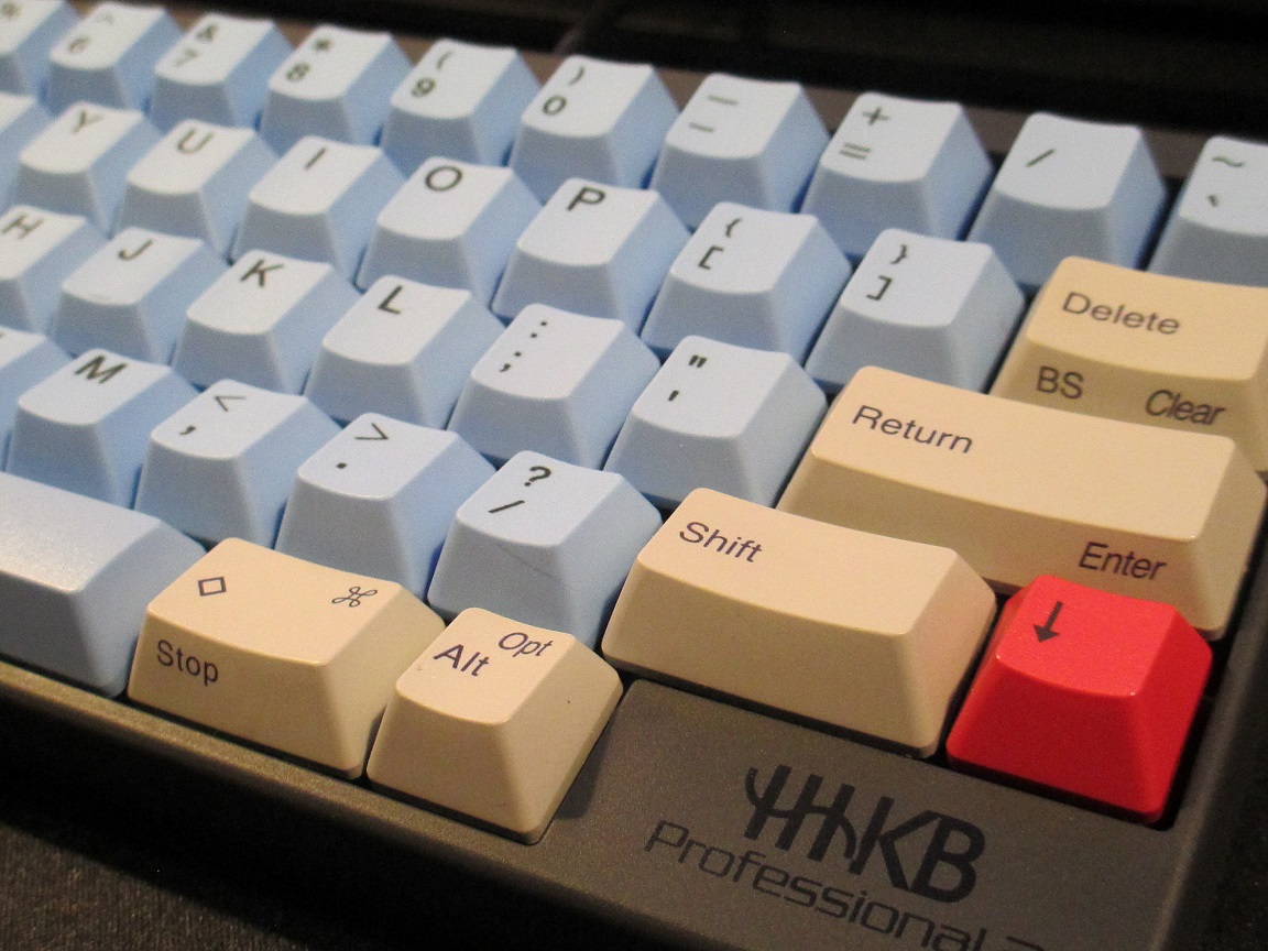

This evening, I installed a set of my Silencing Rings on a black HHKB. This time, I omitted the silicone foam that I put into the case on my first silencing mod, and the sound is actually much better. The silicone foam deadened the sound too much. With the empty case and Silencing Rings, the thock comes through much better, but the clack is gone. I also put the additional self-adhesive foam rubber pads (approximately 8 mm square and 1 mm thick) under the space bar as I did before, and this makes for a deep-sounding space bar thunk with no rattle.
I have installed my last remaining set of Topre blue alphas on the board. As far as I know, Topre is not making these any longer and they are not available anywhere. I hope that the blue color will be selected for matt3o's group buy for Topre key caps. The blue, red, and black in the above image seems fairly accurate, but the mods should be gray instead of beige or tan -- this is a function of the very dim and warm lighting in my study and my potato cam on autopilot.
In any event, I love the sound of my HHKB with Silencing Rings. I think it sounds and feels much better than my genuine Type-S.
