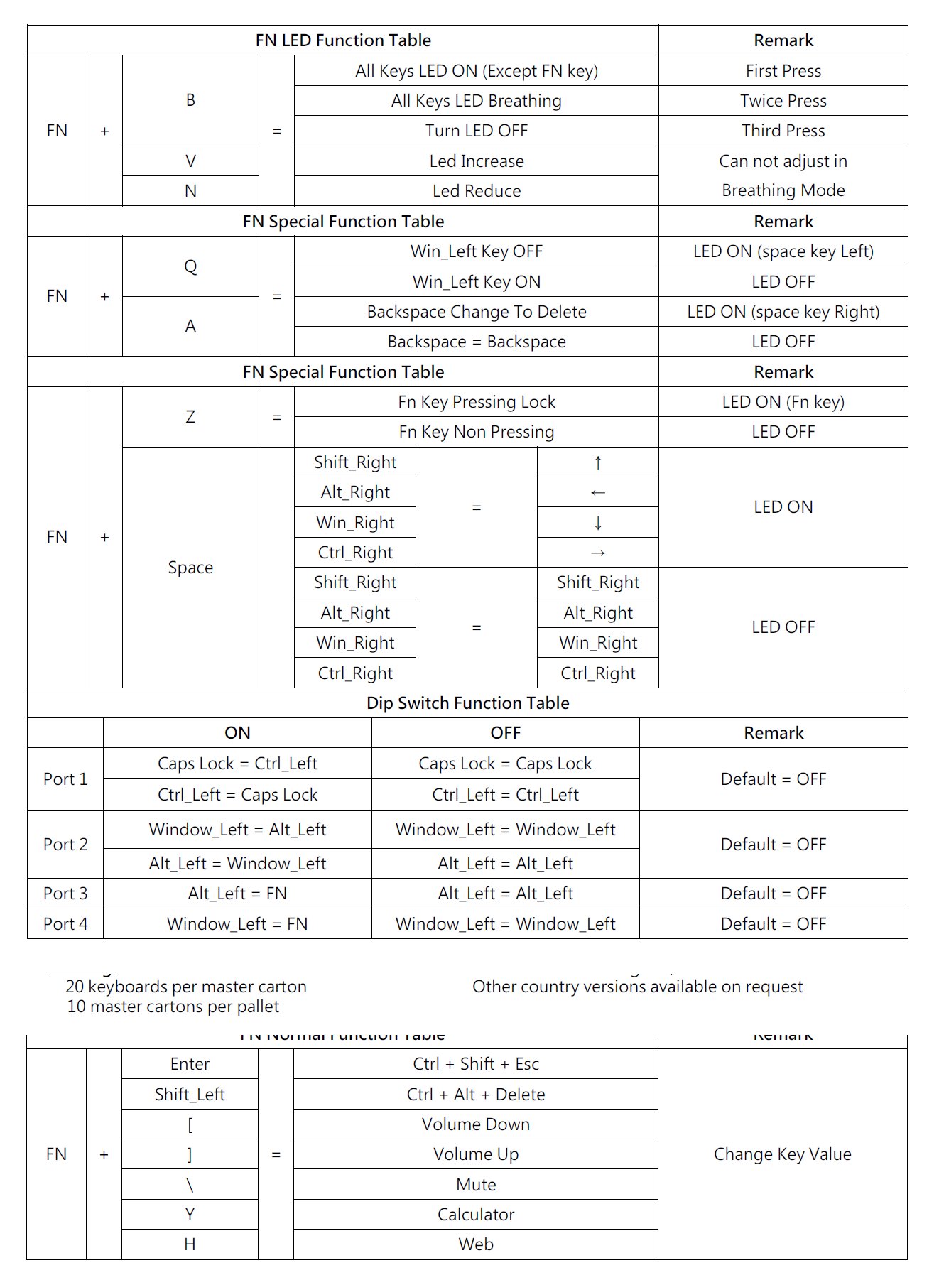

Also, the letters are not all completely translucent and they really could have packed are short manual with the dip switch settings etc :?

The Fn LED is supposed to be dimmer than the others. When it's fully lit, by holding Fn and hitting the key marked SW3, the Fn lock is on and that's the visual indicator.

The soldering sucks on this board. Hit the LED solder points with your iron and it should be good. FN is normal. Manual for the pure has been posted many times.

22 Jul 2012, 00:45
All the KBTalking Modes in PICS!
Nobody RTFM anyway.
http://www.reddit.com/r/MechanicalKeybo ... led_modes/

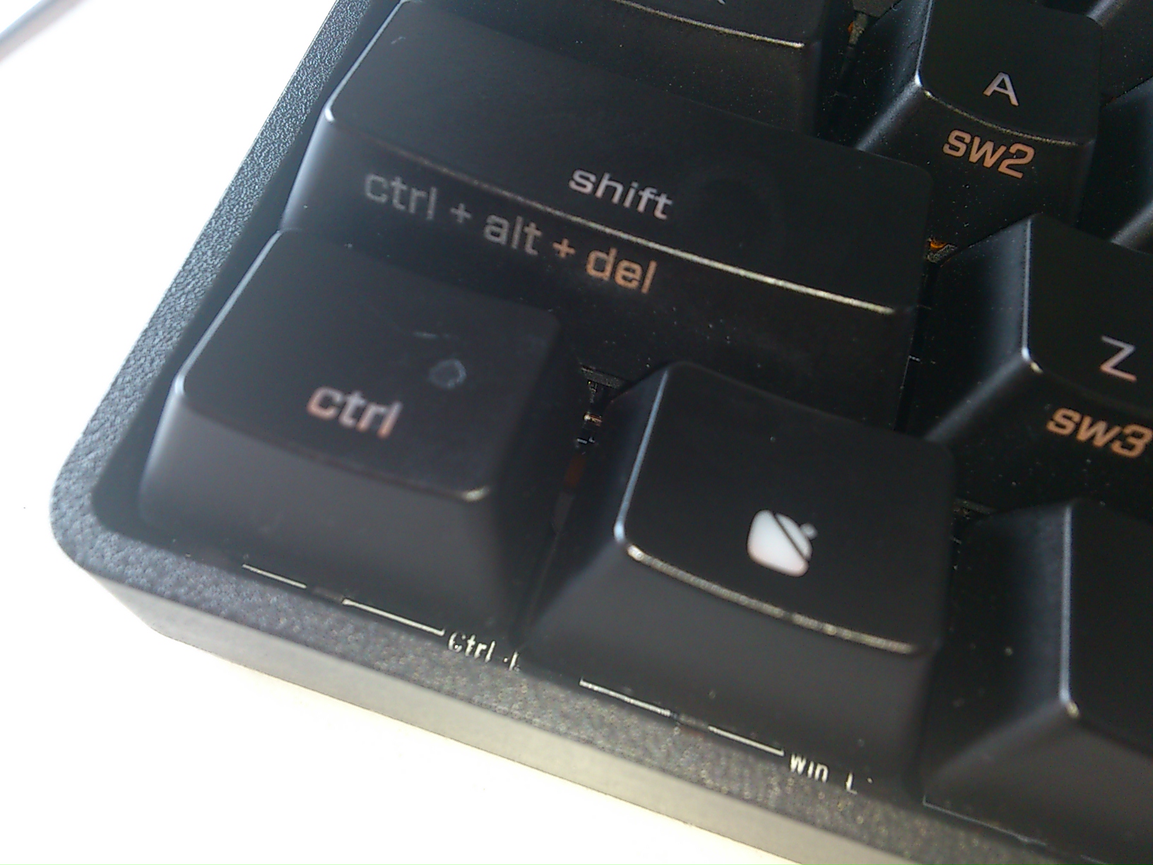

So much for how durable the key coating is:
KBTalking Pure peeling key coating
Admittedly, the coating looked a bit unclean (little "folds") before and i always hit ctlr-left with the nail of my pinky.
