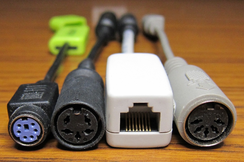

Posted: 06 Oct 2012, 01:05
by Soarer
Aha, well, that's even better!
I finally finished my set of adapters...
... by finding an ethernet extension cable and butchering it :D

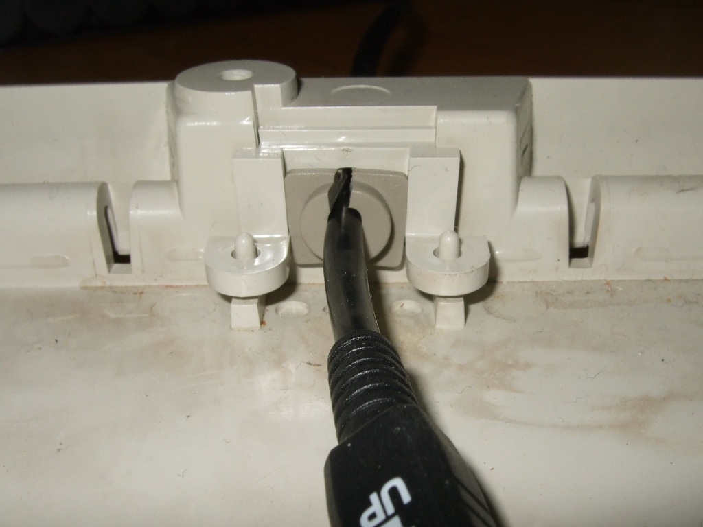

I've got a teensy coming for a 122 key terminal M. What would be the best way to connect it inside the case? Should I strip the wire or just remove the wire completely? What pins/wires are which?
Posted: 29 Oct 2012, 22:59
by wcass
fossala wrote:I've got a teensy coming for a 122 key terminal M. What would be the best way to connect it inside the case? Should I strip the wire or just remove the wire completely? What pins/wires are which?
I installed a teensy inside the case of my keyboard. i'll post pictures of how i did it when i get home.

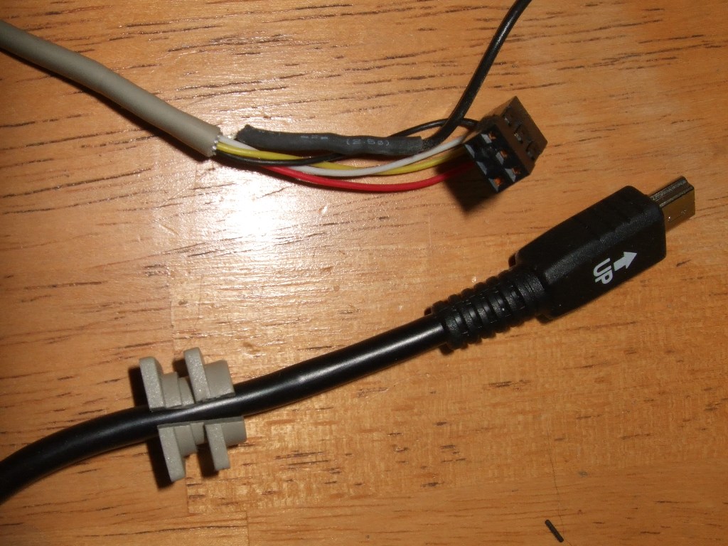

Posted: 30 Oct 2012, 05:02
by wcass
This is what i did and it has worked very well for me. You will need a 6' USB A-to-miniB cable. I just use old cell phone cables.
1. Cut the wire about 6” from the case.
2. Disassemble the case. The wire might be a bit tight – if so, lift the plastic piece around the grommet straight up while holding the cable and grommet down. The grommet should slide out the bottom of the plastic piece. Remove the wires from the controller. You might need to temporarily remove a mounting screw.
3. Pull the wires free of the wire casing if they come easily. Use a razor to slice the rubber grommet on one of the long sides (top or bottom). Slice all the way to the wire casing. Open the slice and pull the wire casing off of the grommet. Slide your USB cable into the grommet and check the fit. You may want to ream the hole to improve the fit.
4. Using the wires pulled free from the casing, attach as follows: black=VCC, white=GND, red=PD0, yellow=PD1. I prefer to use the VCC and GND from the pins furthest away from the USB port for this. I also like a caps-lock LED so I make a connection to GND and PF5. I feed the LED to a light pipe that replaces one of the rivets directly below the caps-lock key. Wrap the Teensy with electrical tape.
5. Attack the plug to the pins and USB cable and reassemble the case.
Posted: 30 Oct 2012, 07:38
by fossala
Looks good, lots of good info. I'll take mine apart and look at it later. I can see from looking at the back that it doesn't have a grommet though.
Posted: 30 Oct 2012, 15:14
by Soarer
That's excellent, wcass!
I'll just add my usual caveat about not trusting the wire colours - check that yours has them going to the same pins on the connector!
If you don't want to hack at the original cable you could try and find a connector to fit, or solder to the connector's solder pads on the back of the PCB (if you're confident with your soldering).
