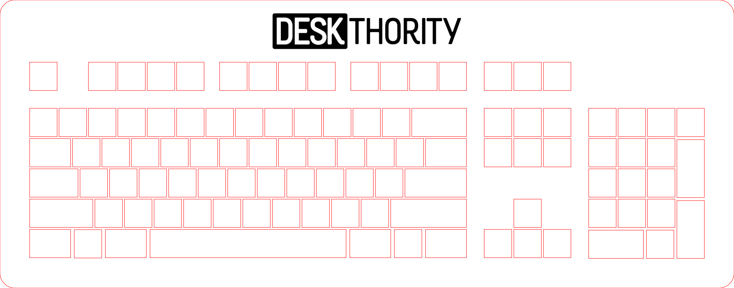

Back on the laser engraving front while we are waiting on a few components to wrap up. I put together a jig already that will do 121 1u keys at once (11x11 rows). But then thought we should do something a little more proper going forward. We talked about making this available as a "service". So you would send me your blank caps (potentially dyed), and I would etch into them how you saw fit. The costs will be minimal.
I have created the following SVG (posted here as a png) in Inkscape that I will cut the final jig from out of acrylic. The idea is you would take the SVG, ADD A LAYER so I can remove the jig footprint, and plop on whatever (text or images). Then it will line up to my jig nicely without me doing any mapping (the hard work). This is the start of it, but still needs cross-hair targets and key outlines so you center everything nicely. Let me know if you think we are missing any keys that should be accounted for. Acrylic is expensive, and I would like to avoid multiple attempts. The alignment is a little silly because I want bigger keycap gaps so the jig never risks breaking. Black (fills) are etched, and the red (eventual hairlines) are cuts
E TwentyNine
04 Oct 2016, 16:59
ISO Enter. Doesn't need to be in its proper position, that gap over the numpad should fit it ok.
Maybe a few extra 1u's up there too for whatever.

I guess an option for the ISO short left shift and extra 1u key would be prudent too.
I'm not sure how many people are going to attempt the double "code" space bars layout you're trying to support on the bottom row, but maybe a template for that too, just in case?
wcass
04 Oct 2016, 17:50
Left shift should be represented as [1.25 + 1] with ISO folks treating these as separate keys and ANSI folks treating them as one key. Right shift should be represented as [1 + 1.75] with most people would place text spanning both keys. Enter should be represented by [1 + 1.25]; ANSI Enter would be to place the text between both keys; ISO would be to place text between the [1.5 + 1.25]. I would also split backspace, and the 3 large keys on the numpad. Consider adding 4 1u keys above numpad and maybe 5 1u keys above the arrows. That should pretty much cover everyone.

E TwentyNine wrote: ISO Enter. Doesn't need to be in its proper position, that gap over the numpad should fit it ok.
wcass wrote: Left shift should be represented as [1.25 + 1] with ISO folks treating these as separate keys and ANSI folks treating them as one key. Right shift should be represented as [1 + 1.75] with most people would place text spanning both keys. Enter should be represented by [1 + 1.25]; ANSI Enter would be to place the text between both keys; ISO would be to place text between the [1.5 + 1.25]. I would also split backspace, and the 3 large keys on the numpad. Consider adding 4 1u keys above numpad and maybe 5 1u keys above the arrows. That should pretty much cover everyone.
Sounds good... I will add several 1u, 1.25u, 1.5u, 1.75u's, and ISO enter surrounding the perimeter. The process really won't care what they are mapped to as long as the person filling out the template keeps it straight.
I don't have a 1.25u key on anything I have. I can do the math, but if something could give me the EXACT measurements of the cap itself to validate, I will plug in.
Regarding combining keys, it would seem the smaller of the two keys wouldn't sit proper in the template, as well as the gap between the keys entering into the width equation.
lot_lizard
04 Oct 2016, 21:30
E TwentyNine wrote: Regarding combining keys, it would seem the smaller of the two keys wouldn't sit proper in the template, as well as the gap between the keys entering into the width equation.
They would be dedicated spaces. I will have the current layout "as-is", and then add extra keys 'round the outside (Eminem reference... at least I think. It's been a while)
