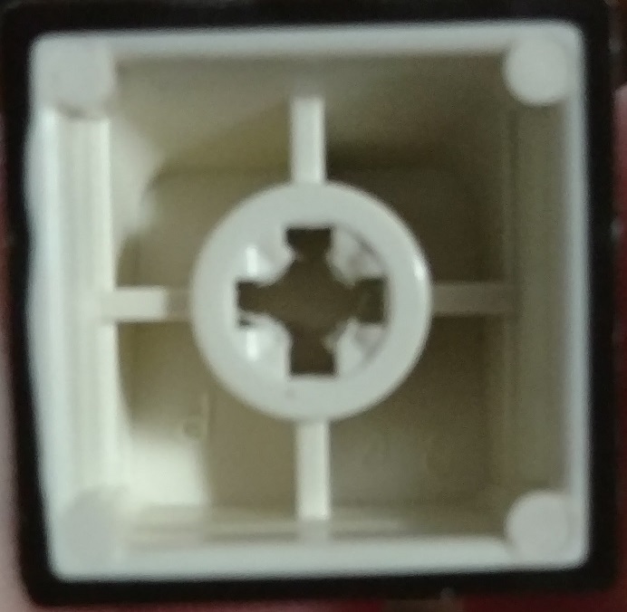

SaltyMcSushi wrote: The C64 doesn't use these switches, but I was able to get the caps to fit well enough with only a minor amount of mutilation.
Elaborate please!
Posted: 17 May 2017, 17:52
by SaltyMcSushi
just_add_coffee wrote: Very nice, but how in the heck did you get that Return key to fit up there?
The return key has three mounts, and the outer two are perfectly spaced so they can fit on adjacent posts. Unfortunately, the shorter modifier keys- Shift, Control, Restore, and Function- all have two mounts, one on the left and one on the right, which is weird and means I can't fit them in matching spots on the Pingmaster, which are designed for a single central mount.
seebart wrote: Elaborate please!
So the SKCC post is T-shaped, but the center of the post also has a square shape to it. This shape prevents usage of pretty much any keycap that's built for a simple cruciform shape.
My solution was to grind the inside edges of the Commodore keys so that there's space for the central square.

SaltyMcSushi wrote: My solution was to grind the inside edges of the Commodore keys so that there's space for the central square.
What did you use to grind the inside of the keys with?
Posted: 17 May 2017, 19:04
by seebart
Good point. And how long did all this take you?
Posted: 17 May 2017, 19:45
by SaltyMcSushi
I used a screwdriver that I got to adjust my mouse, the Torq X10. It's a hex-star shaped thing.
The screwdriver was the perfect size for it- I could stick it into the keycaps so that the nooks in the screwdriver matched with the inner edges of the cap. Then by rotating the screwdriver a bunch of times it wore down those inner edges. Took less than a minute per cap. If you don't wear them down enough, they'll go on crooked.
Posted: 17 May 2017, 20:01
by just_add_coffee
Thank you Salty! I asked because I'm still contemplating some way to put SA Jukebox on this board. Cherry MX stems probably have a smaller diameter than the Commodore keys, so I'm thinking I'll have to do more than grind out the center. But learning how people overcame specific issues can prove useful down the road!
