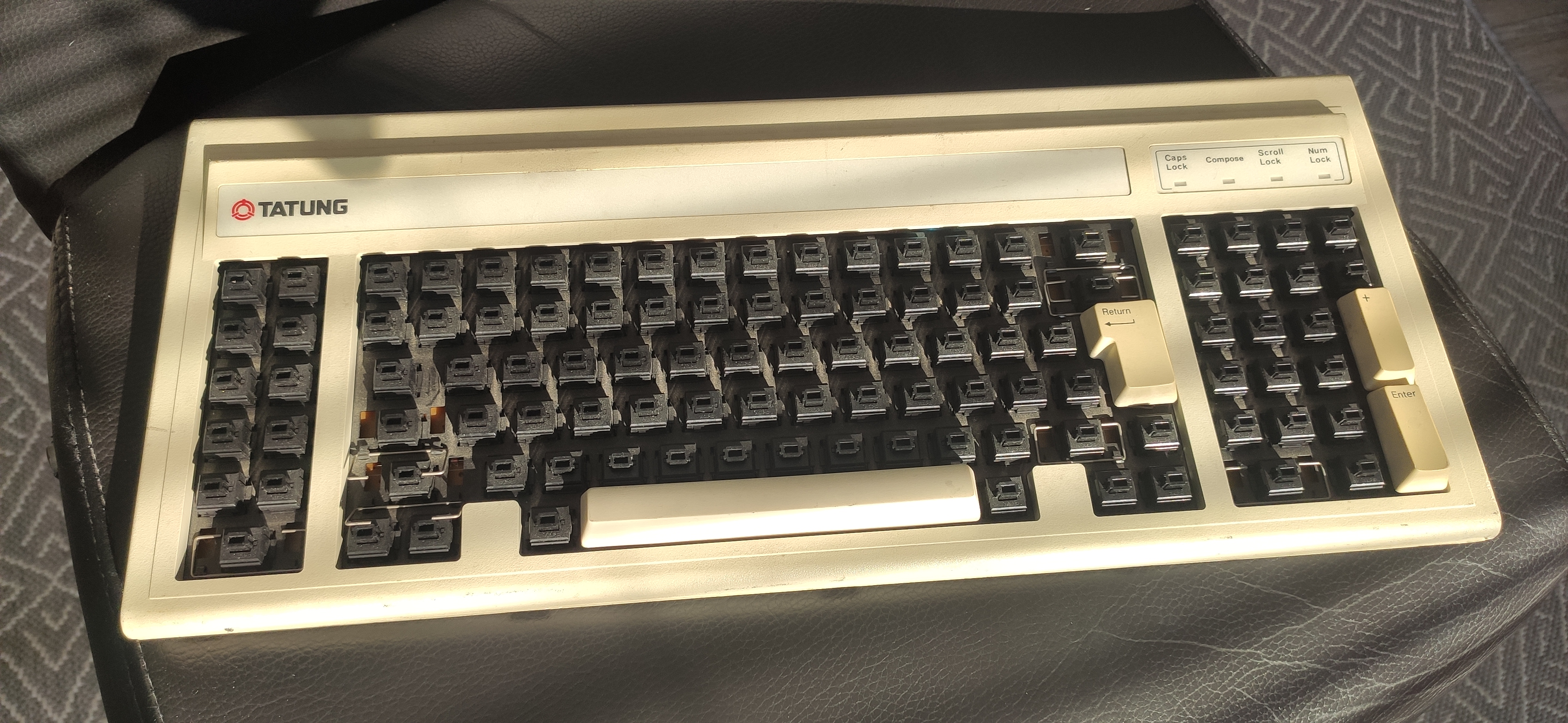

O.K., so the first thing to note about this mod is that it doesn't appear to be particularly time consuming/labour intensive. When compared to your typical MX lube job anyway. What does get you is having to dry out the insides of the sliders. On balance, I'd say it is still quicker than standard lubrication methods. But what about the feel!? Well, I have a few NOS Alps on hand, and also left a few of these used Greens stock for comparison (and because it was too challenging to remove the LED associated switches). I can say that the switches do feel the same as the uncleaned/unwaxed Greens. Both the cleaned/waxed and the uncleaned/unwaxed feel somewhat less smooth than the loose NOS Alps I have to hand. However, from past experience with lubing Alps and Topre, I have found lubricated switches can take a week to bed in. I remember this particularly with my BFK. A lot of effort when in to cleaning and lubing that and I was quite underwhelmed when I put it back on my desk; though, after a week of use, it was silky smooth - a large improvement. I have read that the Alps wax mod will take a similar amount of time to settle so I'm not going to pass judgement yet. At the very least, the switches don't feel any worse than they did.
Oh, and, it's alive!!! My Z-150 is finally ready to do some work. I think I've had this board for about a year and this is the first time I've had the pleasure. I'd try and find out how to turn the beeper off but I'm enjoying it too much. This is my first time with linear Alps, outside of linearised Bamboo Blacks anyway. I like 'em. Nicely weighted, and the slight tactility near the end of the travel entertains even someone tactile gang like myself. I'd be impressed by this board's build quality but I've had an F XT on my desk for some weeks now. It's good-looks however? Absolutely. I do not prefer this board's timbre over the ping of an F like I thought I would though. Fs have thock to go with the ping! I like the layout. Having NUM0 swung out to the left there is particularly comfortable. I never thought I'd appreciate having lock lights until daily driving an F XT. This Z-150 could take prime position over the IBM for that alone if I'm honest.
So, wax mod, we shall see. Z-150 though? Winner.
