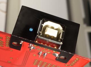

Posted: 03 Apr 2015, 21:03
by phosphorglow
Alright, Micro USB is annoying me.
I love this controller as a direct USB replacement using USB-B, but when it comes to Micro USB and bluetoothy stuff, I had a LOT of design oversights. Yes, it will work, but it's way more hacky than I care for. From an engineering standpoint, it's terrible. But it looks pretty! :P
2015-04-03 14.07.36.jpg (45.74 KiB) Viewed 6678 times
2015-04-03 14.08.00.jpg (61.84 KiB) Viewed 6678 times
So, the headers make it about 3mm higher than I had anticipated, which means only thin Micro USB cables will fit (here's my Samsung cable). On top of that, my desire to have the sub-board be modular and removable using the headers creates a small wobble. The smart thing would have been to include provisions for a mounting riser between the two boards that can be screwed into, and the other smart thing would have been to use the bottom mount USB connector as it was intended - as a bottom mount.
So, what I intend on doing (probably) is to have a batch of Micro USB sub-boards re-made with an updated layout.
In summary, Version 1.0 is great for regular USB conversions, and "meh" for bluetooth as long as you don't mind getting a little creative.
(Other thoughts for updating the design in Version 2.0 will be to center the USB-B connector and moving the optional reset button behind it, because it's a bit redundant. Both TMK and Soarer's Controller have optional key-combos to jump to the bootloader. Also, since the Lipo charger is based around a single chip, including the little guy on the layout would be pretty simple.)

USB-B Cover
2015-04-03 17.12.53.jpg (20.15 KiB) Viewed 6656 times
2015-04-03 17.12.14.jpg (19.85 KiB) Viewed 6656 times
Posted: 04 Apr 2015, 00:10
by phosphorglow
Aaaaaand fail. Micro USB sub-board definitely needs a redesign. Didn't take into consideration the plastic retainer dealy on the top case that's supposed to clamp down on the SDL connector. What little clearance I did have has moved past the borderline comfortable zone to the annoyingly inconvenient zone. Bah.
The dirty hack to this in the mean time is to cut the traces on the sub-board and flip it over and do the rest with point to point wiring. Dirty, but functional.
