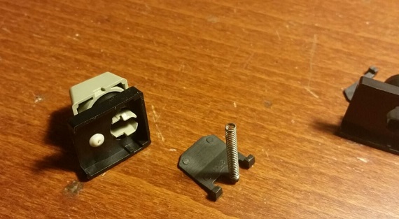

The metal shop forwarded me this picture (notice the barrel fitting on the bottom row where the tolerance is tightest). I am pleased with results, and thought others might find interesting

I tried myself a little bit on the sound dampening and so far not so encouraging things:
- trying to glue some vinilic dot on the same place you did on the barrel the sound does not really change at all.. so probably that's not the place where to work on..
- also trying to dampen somewhere else I noticed that the main point seems to be decoupling the barrel from the plate (probably that's also why there is always some strange foam-thing on ibm bucklesprings).. but if I take it to extremes and heavily decouple the barrel then I obtain actually a similar sound of that of a model m with a lot of usage and wear (!)
so to be honest I'd admit I think I'd actually then prefer to have the characteristic sound of model f and live with it since otherwise it seems it will kind of lose it's characteristics: what do you think?
What still is effective and I personally instead continue to do is reduce/attenuate the ring with dental floss (anybody tried or had ideas on alternatives?) because while the flipper noise is loud I find it nice but the spring ring is annoying to me because of the pitch more than because of the volume per se.
tent:wq

Excellent... Appreciate the help. When you say the following...
tentator wrote: trying to glue some vinilic dot on the same place you did on the barrel the sound does not really change at all.. so probably that's not the place where to work on..
Is this in reference to when the flipper returns to the barrel ("couples" using your terms), or on the decouple? I would have expected a slightly muted flipper sound when the key is released and returns from the PCB (though slight). It's good to know if you are not experiencing though.
Another method would be thicken the flipper paddle itself, but then we get into weight and spring actuation concerns.
tentator wrote: so to be honest I'd admit I think I'd actually then prefer to have the characteristic sound of model f and live with it since otherwise it seems it will kind of lose it's characteristics: what do you think?
Absolutely zero objections there... Just trying a few things to see if we bumble our way into an improvement. The more people taking a stab at it the better. Again... appreciate
Posted: 29 Jun 2016, 23:46
by tentator
you're welcome and actually the test with the vinilic glue is that white dot you see in the picture indeed that should attenuate the return of the flipper.. so far i could spot only a really tiny difference in sound but it might also be that the material I used and the positioning of that dot is not the best..
but the above has nothing to do with what I mentioned as a second test later on about decoupling the whole barrel (rectangle section of it at the bottom) from the pcb actually below it (and this is actually very difficult to test for me) and/or from the plate it is inserted in (there usually ibm put already some black foam that degrates badly with age.. ;))
so this above operation seems to mute the whole "click" of the switch a lot such as kind of muting it.. could you maybe try as well with some thin layer of something between pcb and barrel and experiment?
I'll try something again tomorrow..
