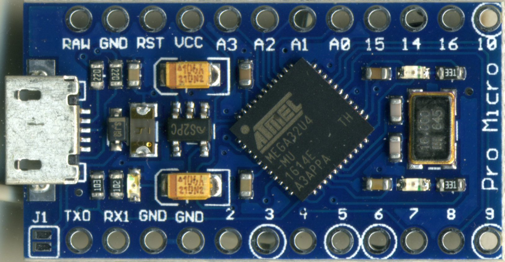

Maybe the native USB support in the atmega32u4 allows solid USB communication at lower speeds but I think when building AIKON controller based on atmega32 uC with a firmware USB stack, a speed of 12MHz is required.
Maybe that's a restraint of the bootloaderHID used ... meh
Would be too awesome if we could Soarer or TMK on the 8MHz version

If you're willing to experiment a little -
attached, find a version of Soarer's Converter that should work on an 8MHz Pro Micro.
If I found all places where the CPU frequency is relevant.
If that really works at all (I got no 8MHz device to experiment with).
(Attachment deleted, as it didn't work)

Thanks for the contribution. Just flashed it onto a 8MHz ProMicro but unfortunately, no success.
The ProMicro fails to identify as a proper USB device after flashing. This also happens when flashing the 16MHz version. Might be a little more to it than that. Is Soarers source code available somewhere?

I found another difference between 8 and 16 MHz external clock settings; this one's in the USB configuration, so it might well be the reason for the non-registering USB device. If you're feeling adventurous, have a go at it...
soarer_pro_micro8.zip
(14.78 KiB) Downloaded 543 times
... if this version still doesn't register properly, I'd like to take your offer; please contact me per PM for details.

Since I just went through the previous page of this thread -
Wodan wrote: I think you need at least 12MHz for USB communication. So the 8MHz version can be flashed through USB when in bootloader mode but not establish proper firmware USB communication. Please correct me if I'm wrong here! After all I guess the firmware must be recompiled for the 8MHz version to get the timing for the USB communication right again if poissible at all.
Based on the documentation, it uses a 48MHz internally generated frequency and can lock that to an external crystal. For the atMega32U4 there are two configurable settings, for 8MHz and for 16MHz crystals (and that's what was still incorrectly configured to 16MHz in my previous version). So 8MHz should be good enough for the USB side. As for the PS/2 side ... we'll see.

You're a god damn genius!!!
Just flashed my 8MHz ProMicro and it now identifies correctly as a Soarer Converter.
Haven't hooked it up to a keyboard yet but this looks promising.
Amazing job there, incredible potential here if Soarers work could really become a community project.

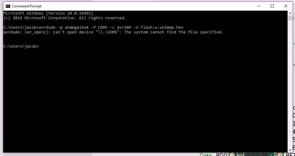

Hi all, I've been trying to get a .hex flashed onto my pro micro using avrdude on OSX, using the directions at the beginning of this thread. I've done some reading through the entire thread, but I don't think I've seen any actual success stories coming from people on that platform. If you've *actually successfully flashed* a .hex on OSX, I'd love to hear about it, as I'm having zero luck so far :'/
Posted: 06 Jul 2016, 01:54
by scottc
I have. It works fine on Mac OS X. We can't help you unless you tell us what's wrong and give us steps to reproduce.
Common issues you might have:
- avrdude isn't installed
- you didn't prepend "sudo" to avrdude command (might be required if your user doesn't have access to write to the device; there are instructions to do this on Linux on the Teensy website that are quite straight-forward)

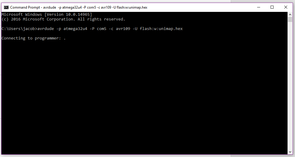

Ah, thanks for your reply! Here's an output of what I'm getting when I try to flash after resetting the device twice quickly in succession - hopefully this helps:
(I've also attempted to prepend this command with sudo, with the same result)

Connecting to programmer: .avrdude: butterfly_recv(): programmer is not responding
Posted: 06 Jul 2016, 02:20
by scottc
From a quick look:
- The error is a pretty generic one saying it couldn't talk to the board.
- This isn't surprising, if you want to flash /dev/cu.usbmodem46 then your avrdude command should say /dev/cu.usbmodem64 not /dev/tty.usbmodem46
- cu.usbmodem46 is almost definitely not the Pro Micro, so your board probably isn't in bootloader mode. It's tricky. See the first post for more info about shorting pins.
- Definitely do put sudo in front of avrdude, or else you won't have permission to flash the device at all (once you DO get the right device name under /dev, you'd probably get an error about "Permission denied")
I'm about to go to sleep but if those tips don't sort you out, maybe someone else will be around to help in the morning.

Using scottc's comments above and also putting
watch -n.5 ls -l /dev/cu.*
in another terminal window, I was able to squeeze in a sudo'd avrdude command to flash the pro micro. Now I'm working on being able to re-flash, which is its own ball of wax, but progress is at least being made! Thanks for your help!

I received the 8MHz pro micro - thank you very much, Wodan! - and could experiment with it.
For my purposes, the Arduino boot loader is totally unusable, so I created a version of Grendel's BootHID for the 8MHz pro micro. See my "adventures into pro micro land" for further details. I've attached it here, in case somebody wants it:
BootHID.zip
(2.71 KiB) Downloaded 536 times
This .zip file contains both the 16MHz and 8MHz versions.
Works nicely.
What doesn't work nicely, unfortunately, is Soarer's Converter. Obviously, 8MHz is not enough. In principle, it works, but every now and then a glitch on the clock line occurs, leading to lost keys and the like. The problem isn't in the PC/AT code; rather, it's somewhere on the USB side. Soarer's Converter sends a lot of debug messages which you can view on the PC with hid_listen; if I disable that, everything works nicely. Obviously, the USB transfer of the debug messages takes up too much time with disabled interrupts, so a PC/AT clock transition isn't processed in time.
I've spent some days on this problem, but couldn't find an obvious cause. Maybe there's an underoptimized code part in USB processing that isn't working fast enough (but does so on a 16MHz device), or maybe 8MHz simply isn't good enough.
Well, I'd rather call it a partial success than an utter failure ... here's a version of Soarer's Converter for the 8MHz pro micro that works (at least with all PS/2 keyboards that I could throw at it - haven't got any PC or AT keyboard for testing), but doesn't provide USB diagnostics for the hid_listen program:
Soarer_at2usb_v1.12_promicro8.zip
(14.52 KiB) Downloaded 543 times
... maybe somebody finds it useful.
Note: this entire posting was created with Soarer's Converter on the 8MHz pro micro :-)

by Norman_
Am i stupid or why isn't this working? :(
It hangs here completely, no change even after relatively significant time (20 ish minutes)
Edit: fixed the error by soldering in a switch to help reset and resetting, now i get this...ugh, something has gone wrong at every step...
Posted: 17 Nov 2016, 23:37
by Rimrul
You did verify COM5 is the correct port? IIRC it changes when switching to bootloader and I just tried them until I hit the right one, resetting again every few tested COM ports.
