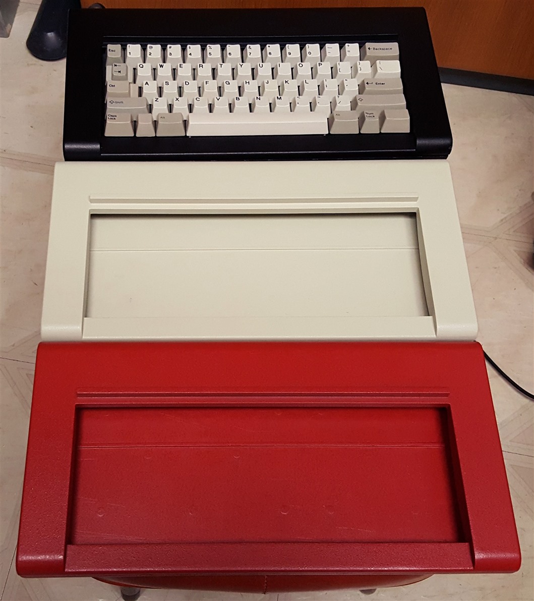

All the first run parts (except keys) are being sent tomorrow by DHL Express! They should arrive by mid-week and then I can start the final QC testing for all parts. I have extra batteries for my micrometer! Keys are expected to be mailed by the end of next week. They are working on the final adjustments of the key molds.
Here are the photos of the cases and outside foam being mailed. The other inner parts are also being mailed so in effect I will be doing the assembly and testing from all newly received parts.
Again please disregard any and all colors and lighting in these photos as they are not accurate or representative of what you will get.
Picture1 - Copy.jpg (63.34 KiB) Viewed 13018 times
Picture2 - Copy.jpg (45.93 KiB) Viewed 13018 times
Picture3 - Copy.jpg (49.37 KiB) Viewed 13018 times

The red is beautiful, I too look forward to a 3rd party review. It's not easy for me to drop half a rent check on an unknown.

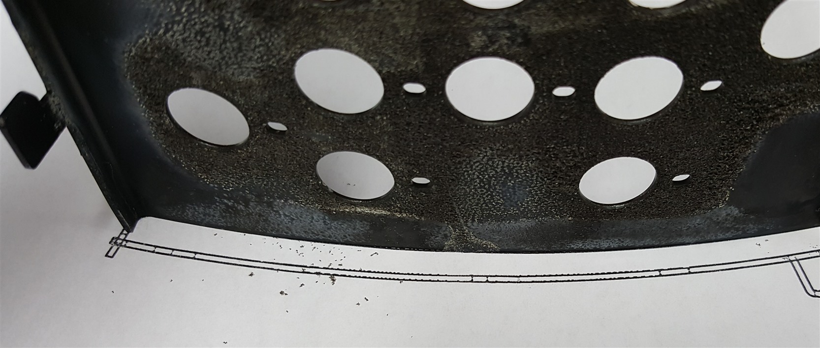

I am typing on a fully assembled new prototype F62!
Everything is working very well so far. The powdercoated die cast zinc cases are excellent quality. It was well worth the couple extra months to get the paint job right. The off-white/beige color is almost an exact match to the 1988 F107 case I mailed them as the reference. The texture is the same bumpy, mostly matte but slightly reflective powdercoating as the original. The True Red and Black cases look good. In the next week or two they will mail the Industrial cases.
The capacitive PCBs, controller PCBs, inner foam, and outside foam are all good. Every PCB is being grounded in two spots to the bottom inner assembly with 6-32 screws to eliminate the risk of stray capacitive signals.
There were a number of issues that I have told the factory to work on and prioritize for completion as soon as possible. Some notes:
The top inner assembly parts are very good but slightly off spec. The TIA curve is about 1mm off from the ideal. My XT sample has a perfect curve that matches my CAD files exactly so I have asked the factory to remake the samples to this standard. The perfect curve helps ensure a more even pressure on the barrels between the top and bottom inner assembly. The wrong curve can result in wiggly barrels and clicks that are not as sharp so it is important that they get it right. To correct this issue they are going to adjust their tooling and mail corrected parts ASAP.
The compact cases had some issues with the color of the hard anodizing being slightly off. They are adding another couple screws on the bottom to further secure the case.
The product boxes were 2.5mm thickness instead of the 5.0mm I had specified so those were rejected, though the box artwork is well-printed.
Finally the springs are very close to the originals but I want to see a few more spring samples with different materials before the springs go into production.
top inner assembly part size and bend issue - original part example for comparison.jpg
top inner assembly part size and bend issue - original part example for comparison.jpg (246.4 KiB) Viewed 12251 times
top inner assembly part size and bend issue.jpg (199.02 KiB) Viewed 12251 times

The springs have improved sound but the top inner assembly needs to be re-made and accurately curved before the Model F sound is at its sharpest. Currently it's well within the range of the original Model F's that have gone through my refurbishings over the years.

Update on the top inner assembly cases - the factory has agreed to change over to a different tooling setup to make top inner assembly parts that are accurate in their bend and size. They need a few weeks for setup and to send the corrected samples.
This is an important step to make sure the Brand New Model F keyboards sound as good as the best Model F keyboards in my collection, not just the 50th percentile Model F. The best ones have accurate top inner assembly curves like the XT example in one of my recent posts. The middle row should be as clicky as the other rows after the corrected cases arrive.
