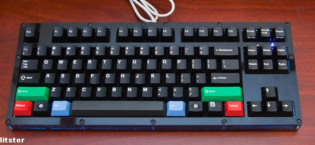

Posted: 14 Dec 2011, 23:40
by litster
With sunken, black-oxide hex cap screws:
- Acrylic Case Blue-2.jpg (169.28 KiB) Viewed 7398 times
The piano black finish does attract finger prints though.
Posted: 15 Dec 2011, 01:46
by N8N
Do want do want do want!
Finally, a fantastic use for a set of shiny doubleshots! (not that yours are, I can't really tell, I just mean that I think that shiny ones would look even better than new ones on that board.)
