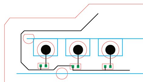

Well, decided to take a break from other things and at least translate the 122 matrix into a chart. Now to plug it into the config...
Here's something off-topic yet related to the degree that it would be usable with this controller, a silly little project that was bugging me so I had to take some measurements and see if it would be feasible. Red lines are cutouts for the separating layer and second layer.
Think 1206 SMT and ~.75mm thick diode.
(Don't expect it any time soon, but prototype will definitely happen eventually. Electric cutter/plotter + mylar + silver trace pen = dangerous.)
