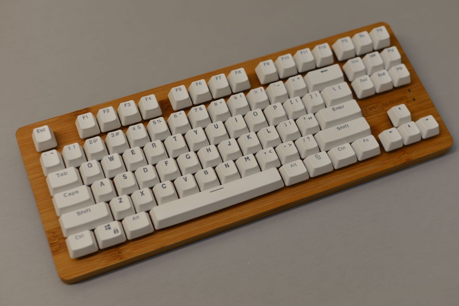

Here's a teaser shot of the production ready bamboo case with XMIT Keyboards logo and hidden screws! I'll take some more photos tonight.
Many iterations later, the final prototype.

Mate that looks amazing, i cannot wait to get one.....so i can put some decent caps on it :D.
Posted: 03 Nov 2016, 18:06
by ohaimark
No kidding. That's the first thing I did with my prototype. :P

looks neat. a bit too higher profile than i expected. any chance the bamboo case can be extended a little for a wristrest
anyone know keycap sets that go well with wooden case ?
Posted: 04 Nov 2016, 04:51
by XMIT
geostation wrote: [A]ny chance the bamboo case can be extended a little for a wristrest[?]
At this point the design is frozen as we move toward production, so, no, sorry.
