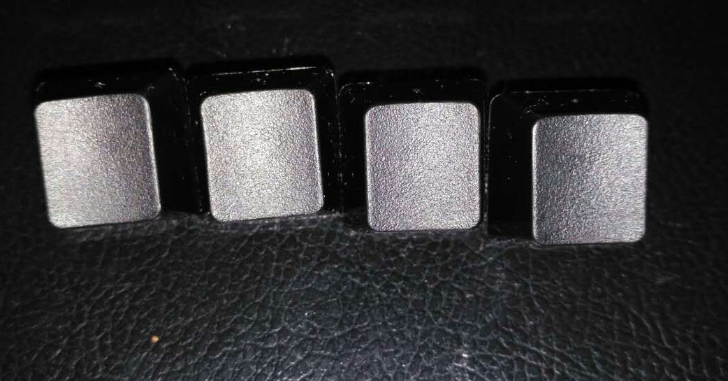

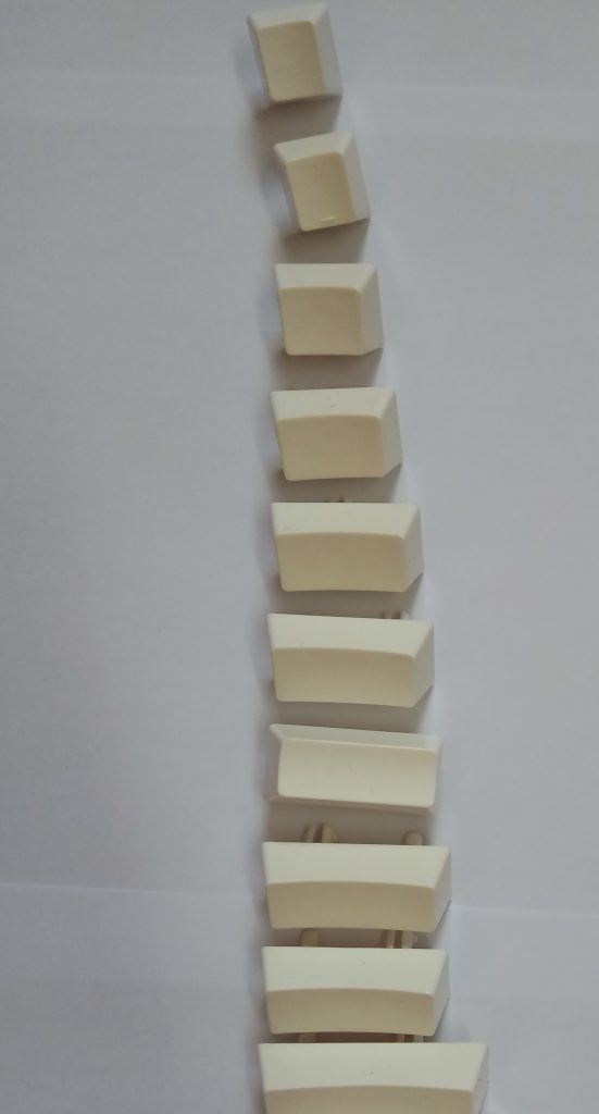

The very first one-piece keys just came out of the new injection molds!
Here is a video of the injection mold in action! Everything is so automated. All other keys also finished; will post photos later this week.
I will receive the samples from the factory later this month for evaluation.

Had no idea that they are producing only 8 keys a shot. Not complaining in any way here but will they in fact produce enough in 3 to 4 months time?
We all have to look after our keys here because this won't happen again ever, once this whole manufacturing process finishes.

No need to worry if the quality truly is as good as the original keycaps. My XTs caps still look brand new and that's a 33 year old board that saw heavy use.

So you think they are going through the trouble of making stainless steel injection molds and then use them for a single production batch?

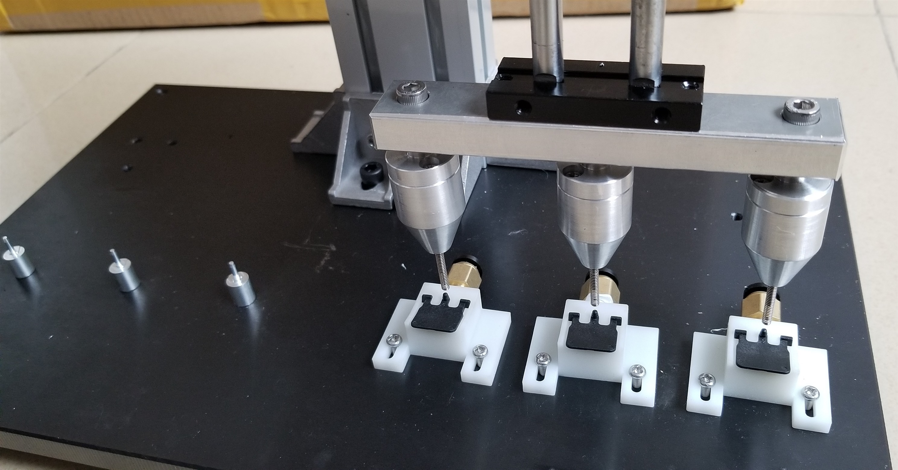

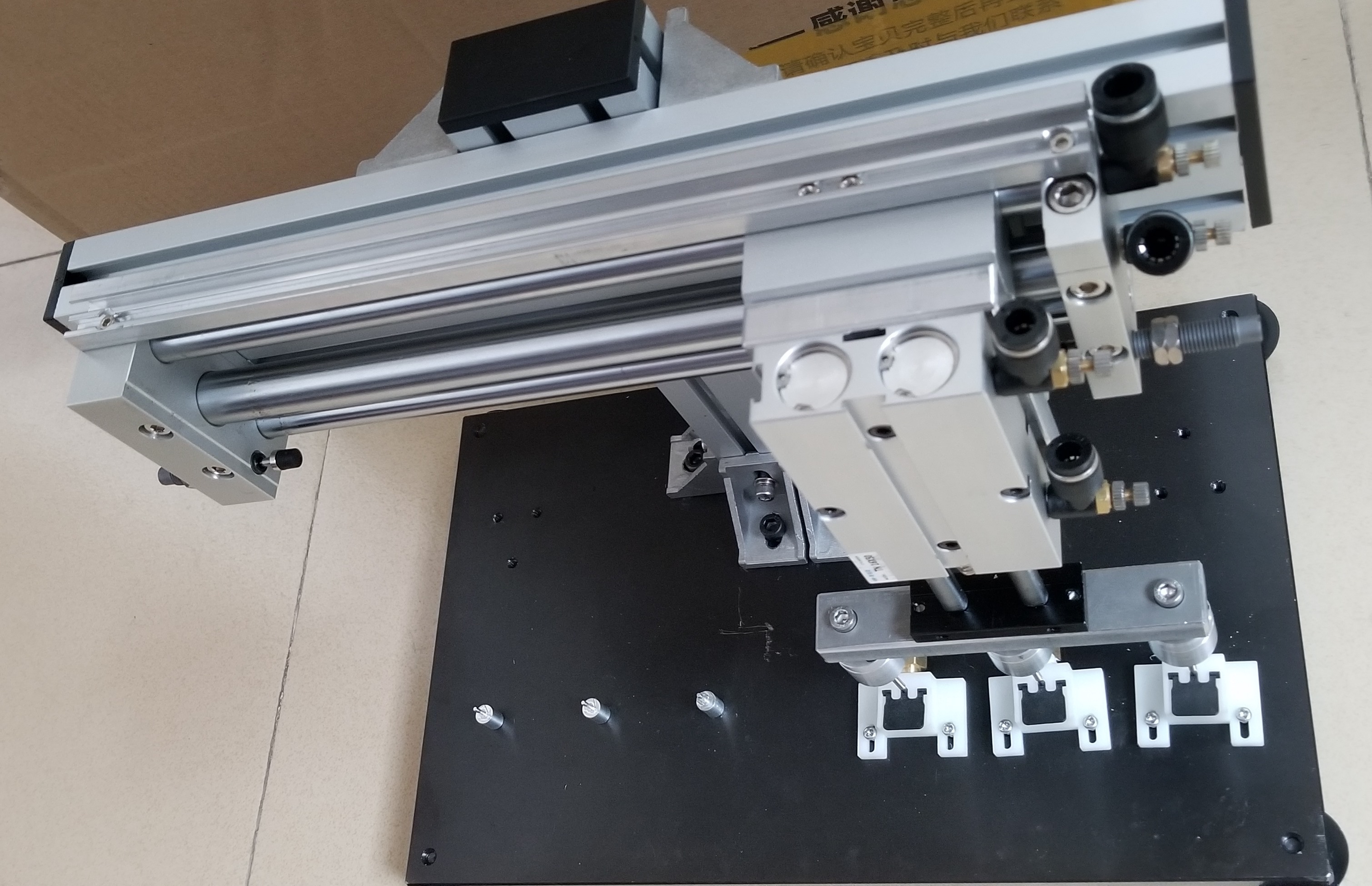

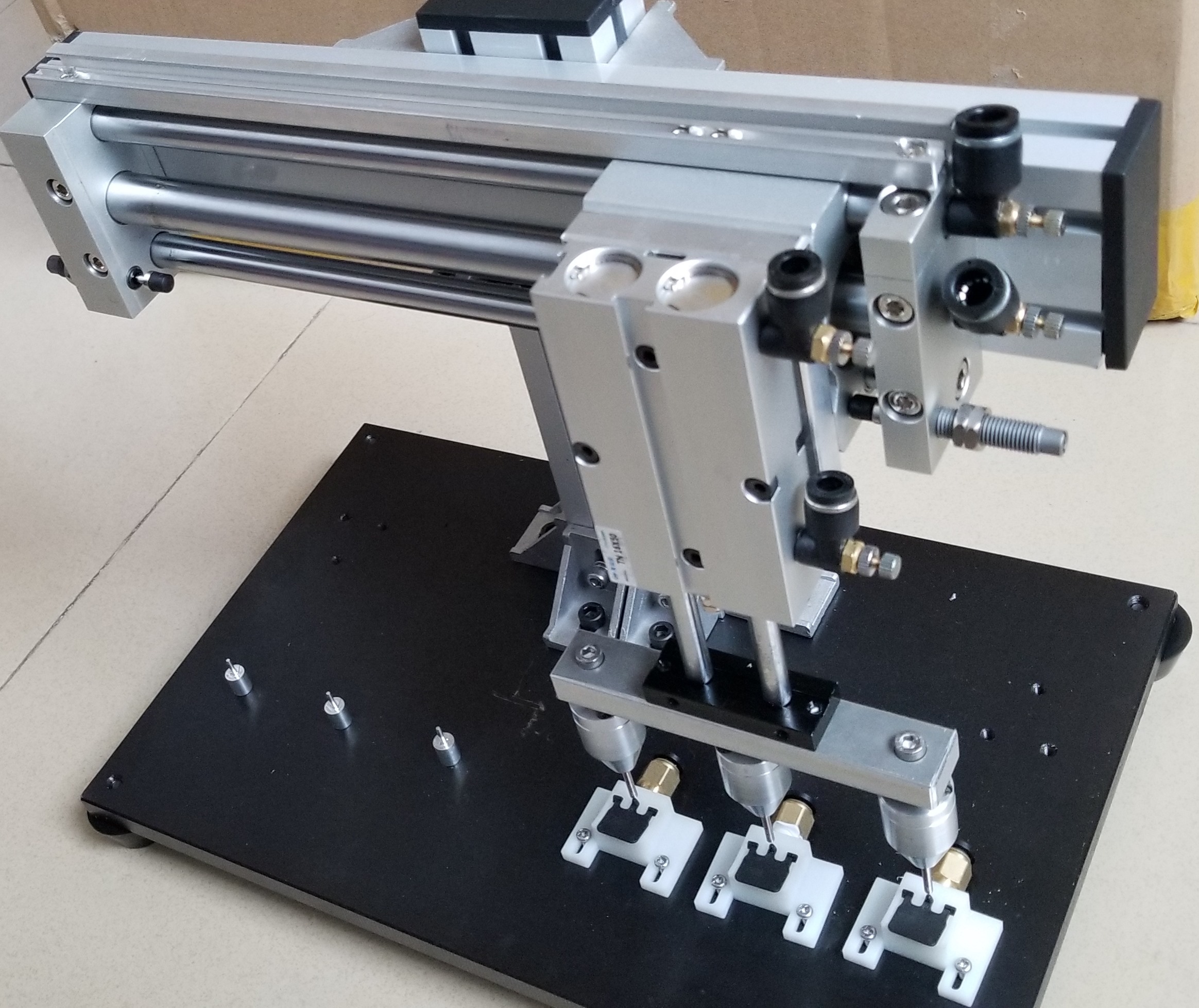

The factory has made nice progress on version 2.0 of the key-flipper assembler. It appears to work with pneumatics. This should save significant assembly time and avoid this part of assembly becoming a bottleneck to the project.

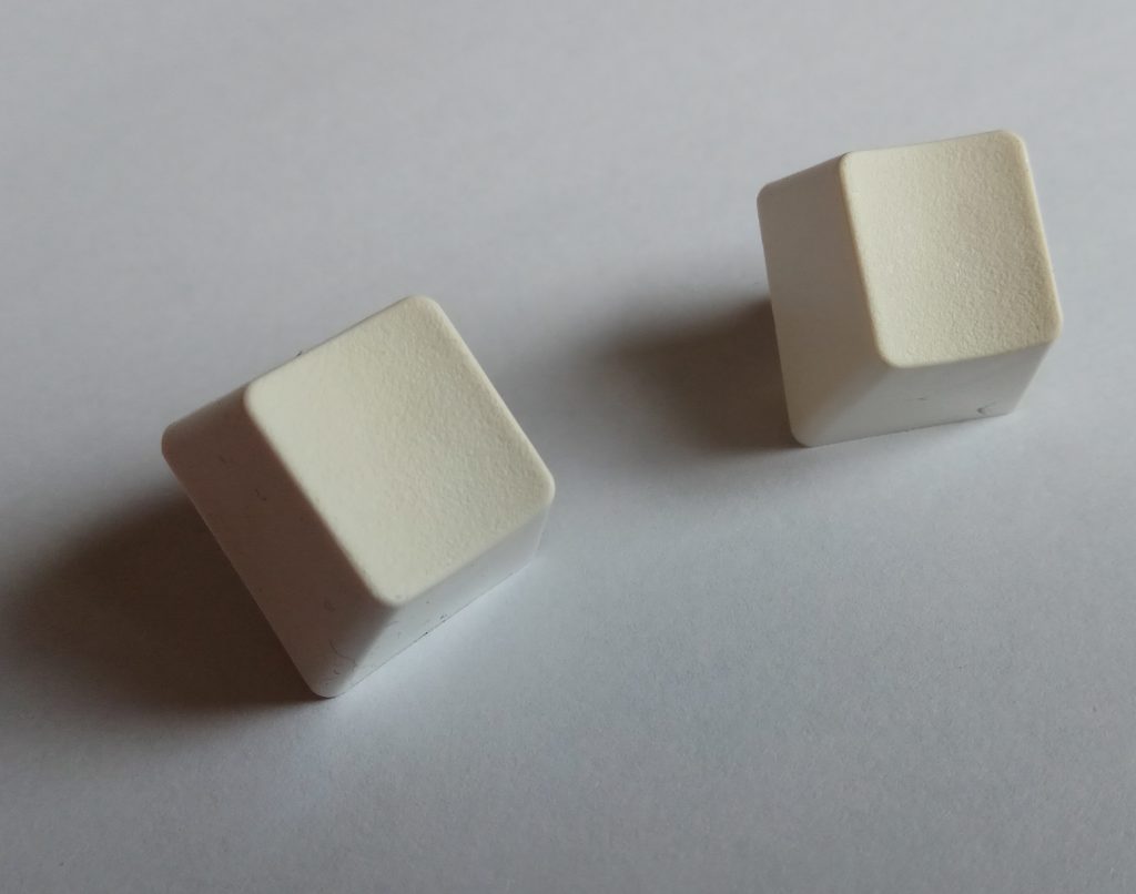

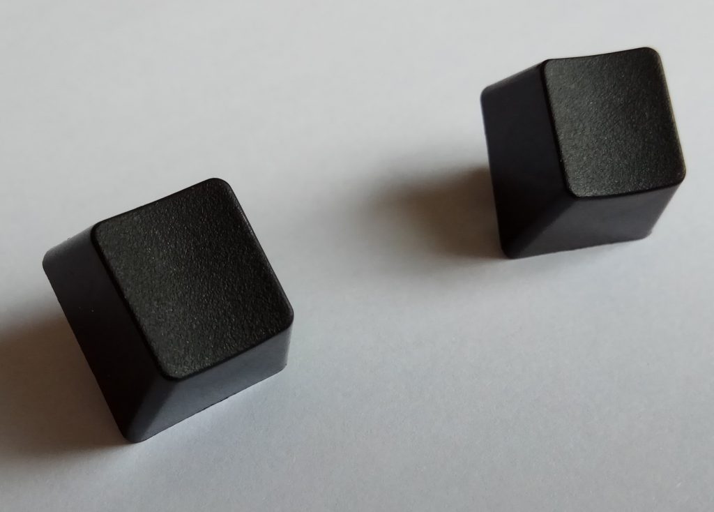

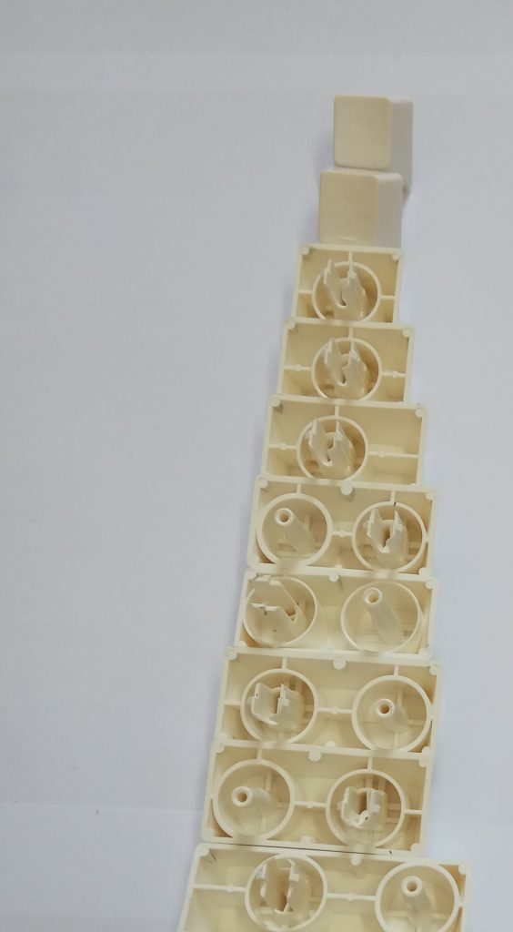

The key samples arrived and I can confirm that the key texture is an excellent match to the original XT keys. The keys are also great quality - nice thick walls, strong, high quality PBT.
With the next key samples arriving in a week or two, they should be within tolerance (these first sample keys were just to see the key top texture and PBT quality - they do not yet meet the strict tolerances). The factory is still working out the PBT shrinkage issues (PBT is a difficult plastic to work with because it shrinks during the injection molding process).
Soon after I am hoping for the correct key colors for the project to be confirmed (pearl/pebble, blue, etc.).

So it's just the keys, top and bottom inner assembly, springs, and compact cases that are not yet waiting to be assembled. Everything else is boxed and ready for assembly. For storage reasons the outside protective foam and boxes will be done last by the factory, when everything else is just about done.
spring-flipper assembler v. 2.0 (1).jpg (781.27 KiB) Viewed 11182 times
spring-flipper assembler v. 2.0 (3).jpg (910.67 KiB) Viewed 11182 times
spring-flipper assembler v. 2.0 (2).jpg (759.31 KiB) Viewed 11182 times
wobbled
27 Jan 2018, 20:43
Oh wow they look fab!
