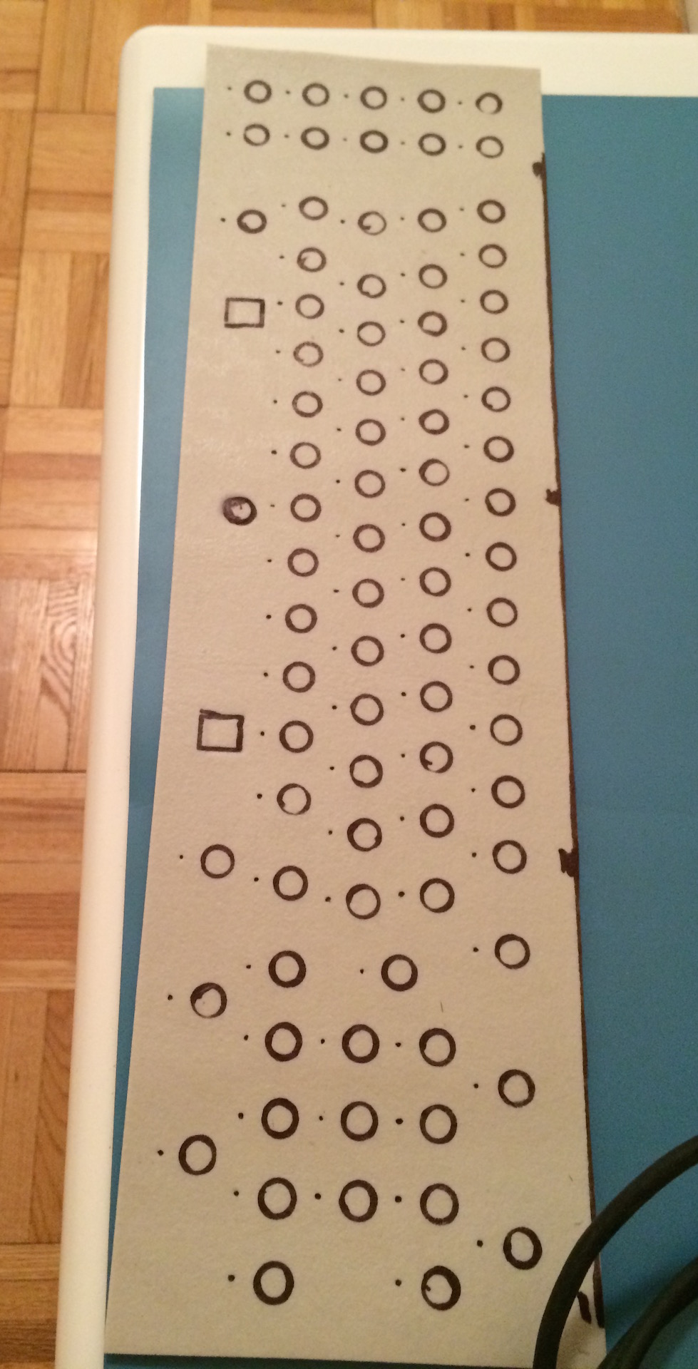

22 Apr 2015, 03:02
Foam mat
Foam mat
Got the mat... unfortunately this thing is ridiculously electric. If I ever build a Van De Graaf generator, this is a prime candidate for the belt. I'll have to coat it with an static dissipative agent.
On the bright side, this thing will probably last longer than the keyboard itself.

Don't know if it'll be any use, but there was a useful thread about the foam matting and possible replacements here. I had to replace mine and used some 3mm neoprene, but that was probably too thick and made reassembly, er, fun. I made a printable template for the XT layout that I found useful (it's attached to the foam thread) and punched out the holes with a punch set. Some application of clamps and a hammer did get it back together and it all worked fine, which was a relief.

I re-assembled the keyboard. :) Yea I guess I should have gotten the open cell, softer foam mat, as it was pretty hard to put it together, I had to use 5 small (35lbs) DeWalt clamps, a block of wood and a rubber mallet. Anyway, at least I didn't have to force anything, and the spacebar was a lot easier too than I feared.
I had difficulty re-installing a few keycaps, it would seem that the spring didn't settle in its proper place, and the key didn't click... My bets are on that the flipper was in a "pressed down" state at all times. After a few retries, shaking the keyboard and poking at the spring with a small screwdriver, all the keys are clicking. :)

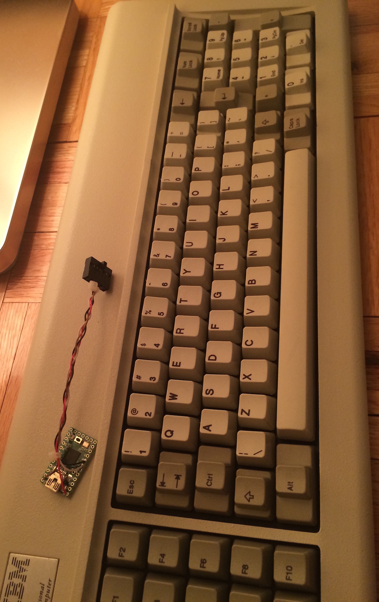

27 Apr 2015, 03:20
Getting there...
The assembled keyboard with the Teensy

Things aren't looking very good unfortunately... The keyboard isn't working with Soarer's converter, and it doesn't look very good on a scope... Seems to be acting weird.
It's quite possible that the electronics are fried on the controller board. :/ Are there any resources online for debugging and fixing these things? What about the availability of the chips?

It seems like it's not registering keypresses - it's the capacitive sensing part that is off. After reading up on the XT protocol I connected it up to the scope again, and I can see pretty proper XT protocol messages, the data line is the data line, the clock like is the clock line, only it doesn't correspond to activity on the keyboard AT ALL, but seems to change based on whim and where my hands are.
(XT protocol: http://kbdbabel.sourceforge.net/doc/kbd ... s2_adb.pdf)
Sometime it stops, sometime it starts, sometimes when I press a key the data line changes state, but more often it doesn't... Similarly, on the computer the best I got out of it was s flurry of random characters upon touching the ground plane, which sometime lasted long, sometimes not...
(Thinking about it, I may have been had. It was listed on eBay by someone who claimed to have started cleaning and restoring it, but then "realized he didn't have the tools to test it"... Well either that, or he realized it was borked. :/ F* me.)

The Teensy is soldered correctly.. and I snooped the keyboard without the Teensy on the scope, feeding it from my lab supply, and it def didn't look any good in itself either.
...anyway, I remember seeing some topic somewhere about designing a new capacitive board based on the XT. Could someone point me to it? There might be people who actually understand how this thing works and how to debug it. :D

Doing things depending on hand position sounds like faulty grounding.
If you open the keyboard again, I think you can test the PCB bare before closing it back up.

Yep, thanks for that tip, I was saving that for the last as putting it together was a pain... Anyway, the bare board works a treat, which makes me super happy as I don't need to worry about debugging an old logic board with unobtainium chips on it... but now the question is, what did I mess up in assembling it? :D

Is the keyboard in the case when it's acting up? Are you sure there is no debris or anything out of the ordinary touching the PCB? Is your foam mat really safe for capacitative use?
I've read a post once about someone testing the keyboard on his lap (without the case), contact with his legs was enough to freak out the original controller.
