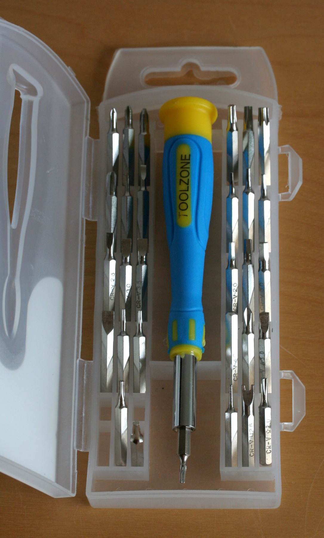

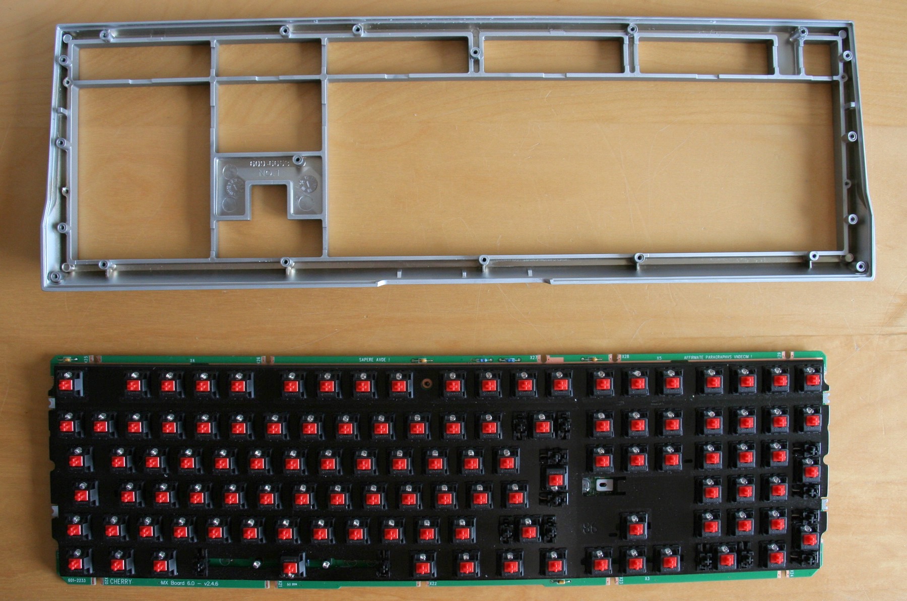

Okay, I finally cheapskated my way out of this situation with a £3 tool set:
Fortunately it has T8 and T6 because I needed both to get inside this bugger!

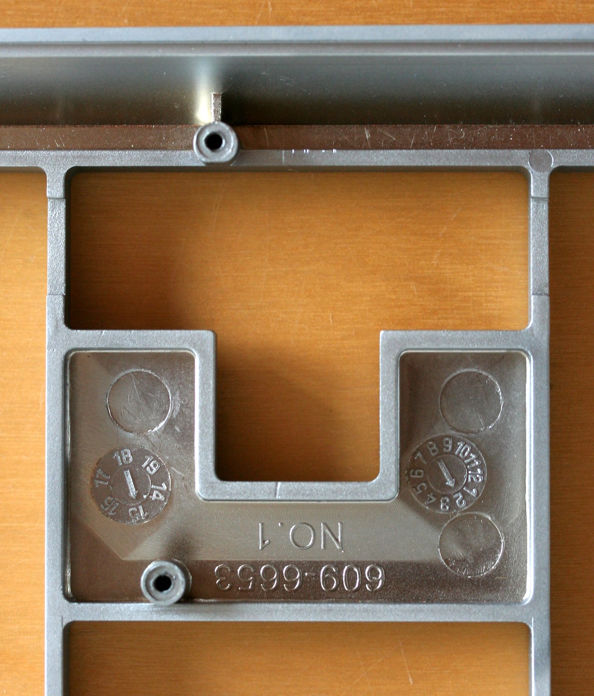

Behold Cherry's metal top:
Aluminium Markings.jpeg (361.56 KiB) Viewed 2702 times

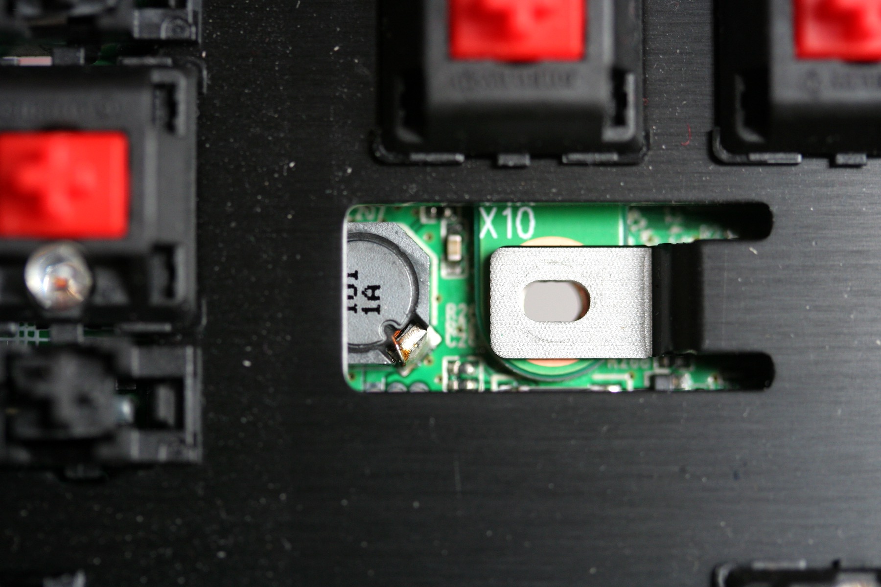

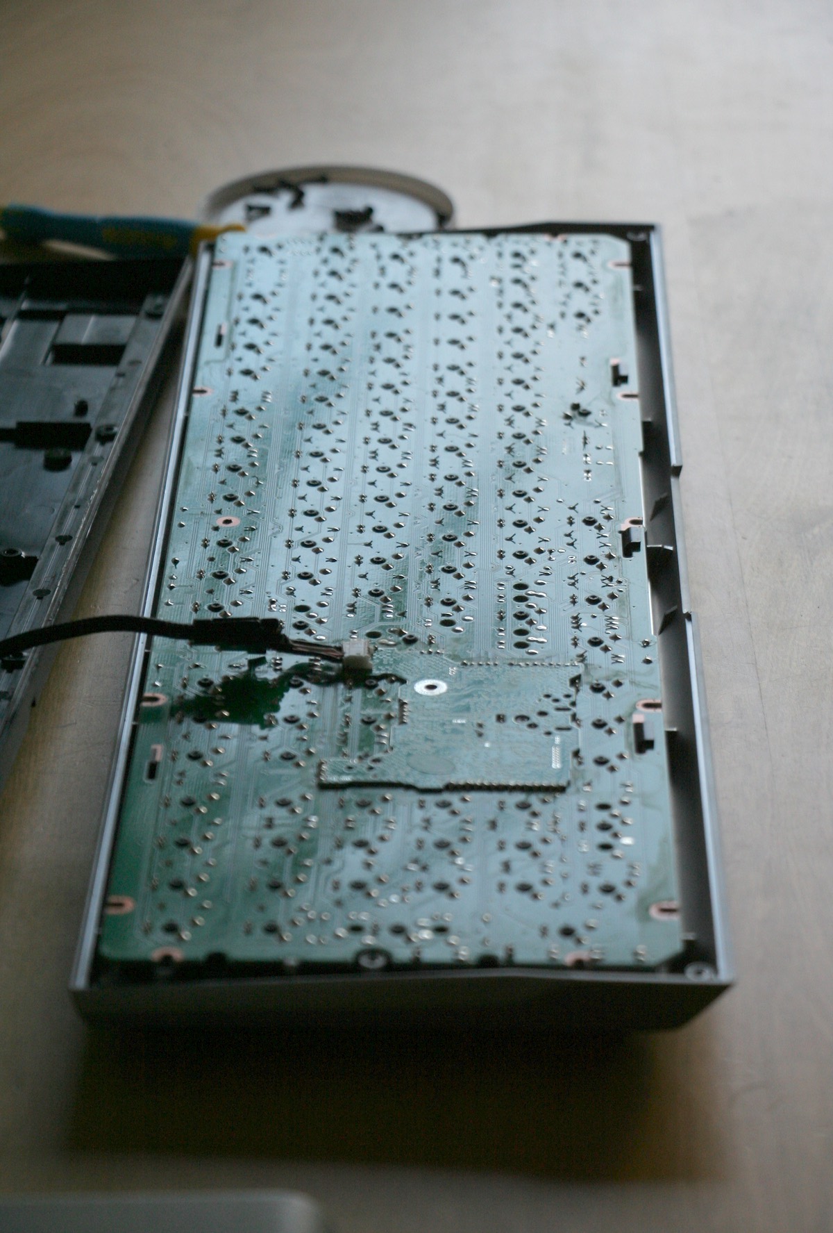

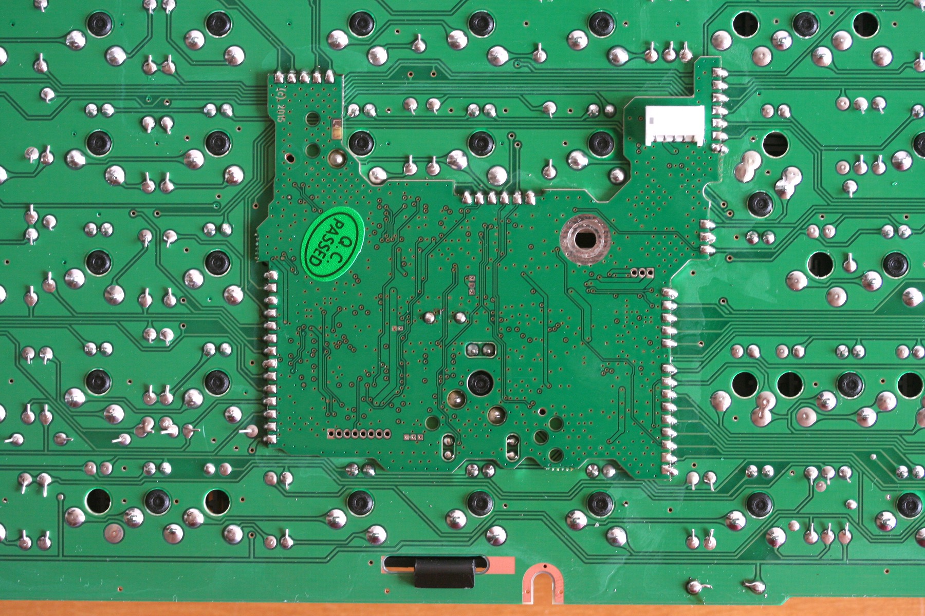

The PCB is a little interesting. As usual these days, every switch is accompanied by an LED, and one other component to add NKRO to the matrix. Usually that's a diode's job, but this board's "analog" matrix is meant to be different.
ISO PCB.jpeg (311.02 KiB) Viewed 2702 times

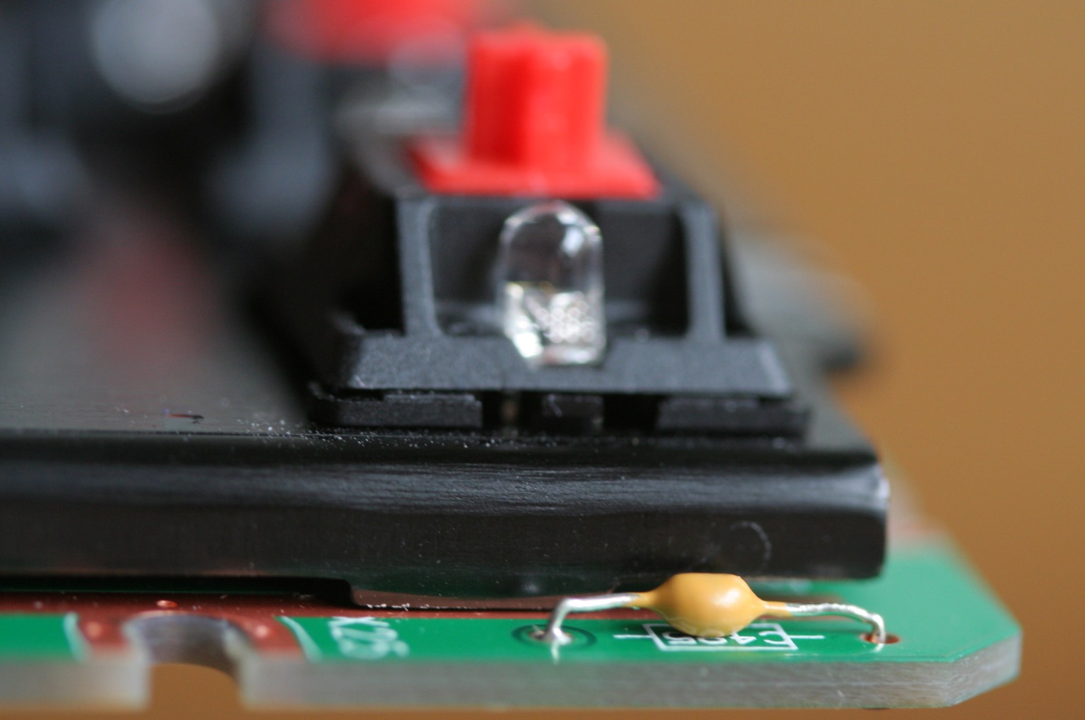

Those components along the exposed top and bottom edge of the PCB are capacitors…
Cap Red.jpeg (163.69 KiB) Viewed 2702 times
At first, I thought that could be the secret sauce in their supposedly analog matrix. Which sounds like crazy monkey balls to me, as capacitors surely slow things down? I'm no engineer, but I know they "charge up", taking a little moment to do. There is, however, an inductor visible on the controller module. Perhaps some kind of tuned circuit for quickly scanning them?
Controller Window.jpeg (330.46 KiB) Viewed 2702 times

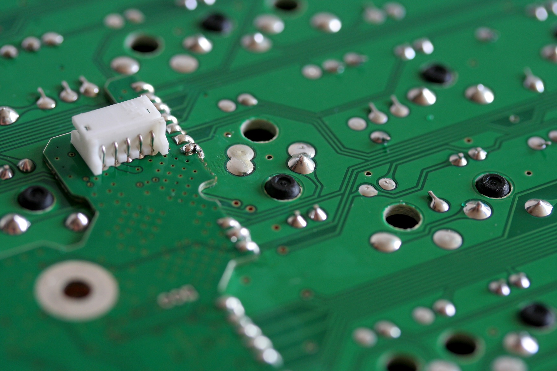

Is that an EPROM? Anyway, here's what the controller looks like from the underside.

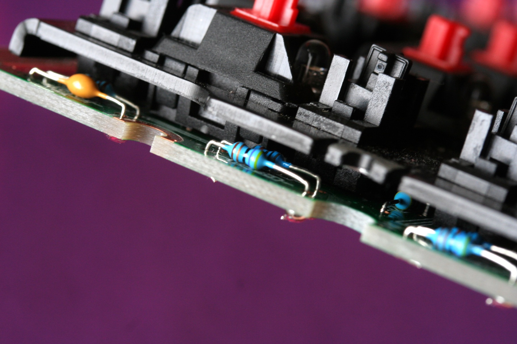

But then I noticed all these guys packed together at the edge:
Resistors Ahoy.jpeg (316.32 KiB) Viewed 2702 times
Resistors. Just like people speculated in the announcement thread. I think they're likely right, though these resistors are of course all tucked away under the plate where it's hard to see them.

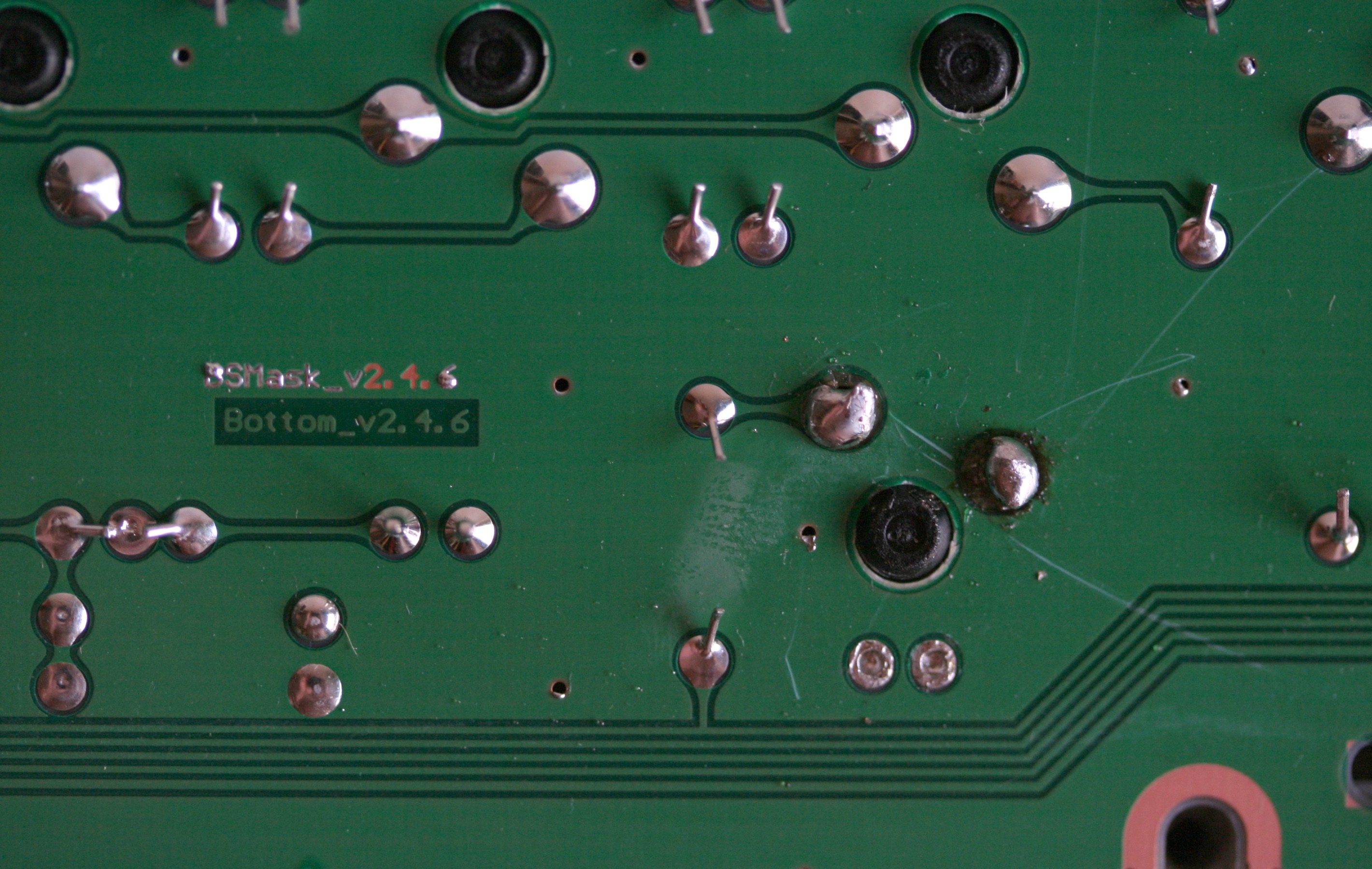

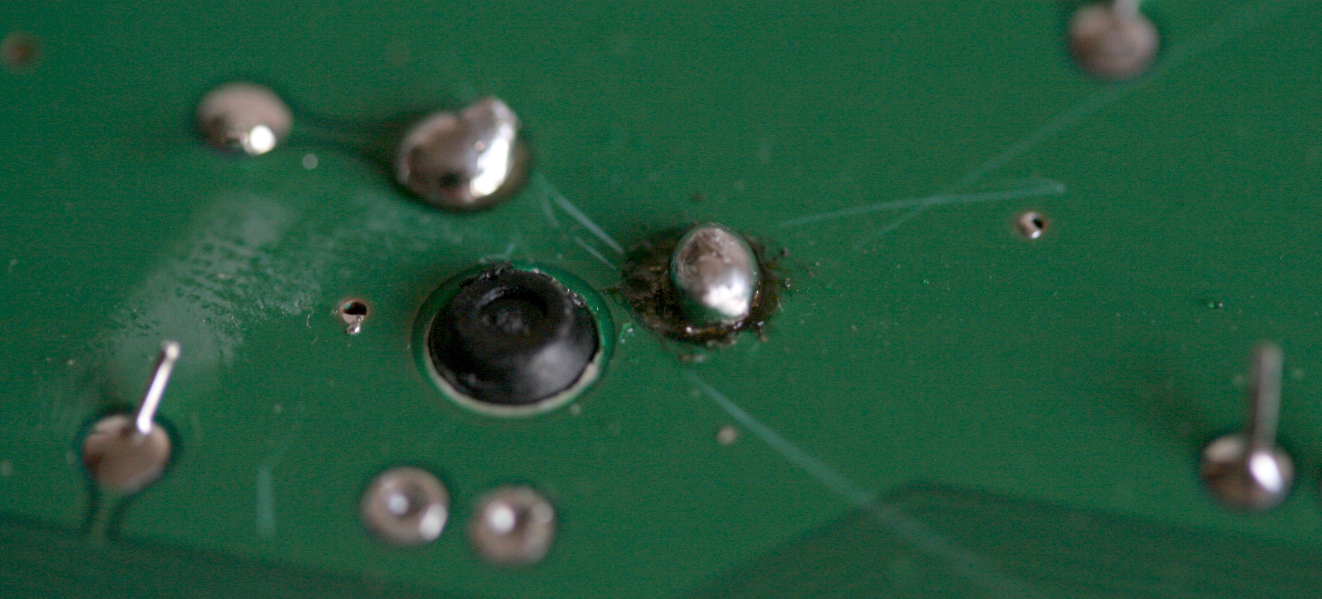

Okay, there is light. Let's get some grizzly details.
I removed a few of the most egregious LEDs — namely the ones that don't damn well turn off! — which worked well. One of the buggers even survived to tell the tale!
But then I had to go and desolder the spacebar switch, to put in a heavier spring. Not so great an idea. The spacebar feels better, no longer shows up on the host. Here's the damage:
One of these contacts ain't like the others. One of these traces ain't quite the same.
They put the trace on the back, didn't they? Oh brother…
