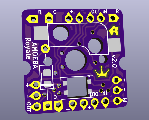

n00b question here: how hard would it be to create a design similar to the original amoeba - but with the SMD mounting points that support the SK6812MINIs (like the ones on the CRKBD) instead of the regular LEDs?
mtl
21 Feb 2020, 03:27
I designed a revised amoeba a while back with support for SMD RGB LEDs like that and Kaihl switch sockets. Had a few prototypes made. I think where it left off was it would technically work for a single key switch, but I wasn't sure it would be feasible to wire up a matrix of them due to the need for more wires between each PCB. Will look for the design and try to post some pictures.
mtl
21 Feb 2020, 03:36
Here are a couple of renders. The LED these were designed for is the SK6812MINI.
If there's any interest, I could try to resume work on it. But as mentioned in the previous post, it may not work out great to try to wire up a whole keyboard of these.
A little more detail on the connections: R and C for row and column, of course. + and - are power for the LED, and OUT/IN are the signal lines for LED control. Within a row, there is no need to connect the +/- lines going up to the row above or down to the row below. (So left to right, the PCBs would connect easily.) The top/bottom pads (other than C) would only be used at the end of a row to connect to the subsequent row above/below.
One quirk was that every other row would require the LED to be rotated 180 degrees and invert the meaning of OUT/IN and +/-, which would be easy to screw up during assembly.

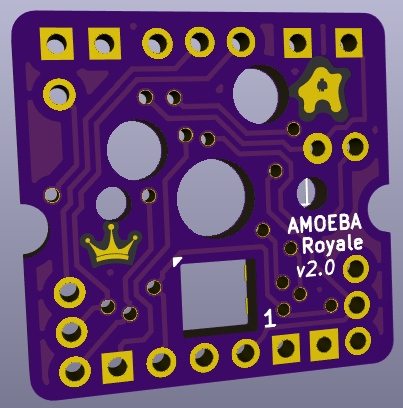

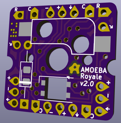

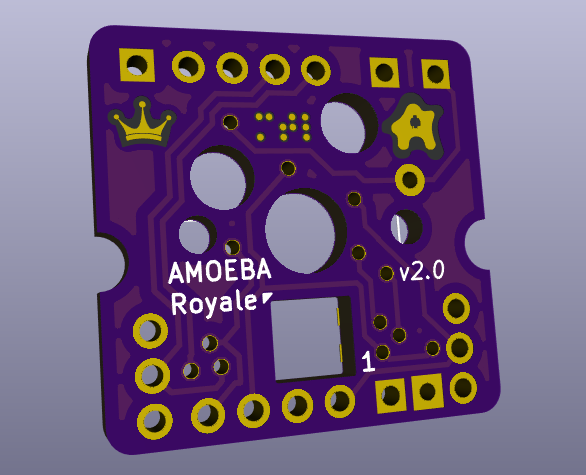

mtl
23 Feb 2020, 22:53
I've made some updates that hopefully improve the design. In this revision, redundant column pads were added to the top and bottom. (Thanks, Lolligagger!) Also, pins were added to support both left-to-right and right-to-left LED data flows across a row. This will allow for the LED to always be mounted in the same orientation, which will simplify assembly and should reduce the possibility for wiring errors. Finally, the pins for data-out on the top and data-in on the bottom were removed. This removes some flexibility but seemed to be the right compromise.
Dimensions are 18.8 mm wide by 18.3 mm high.
I hope to create a wiring diagram to show how these would be connected in a matrix.

mtl
01 Mar 2020, 05:23
Below is a pinout for the 2.0 design. I've ordered some prototypes to see if any other changes need to be made. Also may take a shot at creating a panel to have more control over where the mousebites end up.

mtl
07 Apr 2020, 04:25
Thank you! I plan to release the gerbers and sources. However, there are a few issues that need to be worked out:
  • To make use of the Kaihl switch sockets, one really needs to use the screw mounts on the left and right sides to stabilize the PCB when a switch is inserted or removed. I don't think I've seen anyone use them before with the 1.x series.
  • A 2u version needs to be created to support stabilized keys, as the screw mounts on the 1u would interfere with the switch plate stabilizer cutouts on 2u (non-space bar) stabilized keys.
  • On the second prototype run, the SK6812MINI cutouts were made with too coarse of a drill bit and thus were too small for the LEDs to fit into. OshPark says the finer milling bit is not guaranteed, so the Amoebas would need to be manufactured with tighter tolerances, perhaps at a different fabricator.
All that said, if anyone has thought through the mounting issue and is eager to use these, please speak up and I will work on publishing the design.
