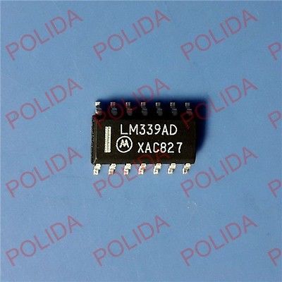

I have found this (x25 for $2)
http://www.ebay.de/itm/361426485831?_tr ... EBIDX%3AIT
Also, if done, I would try to ensure different thresholds for each key ...
