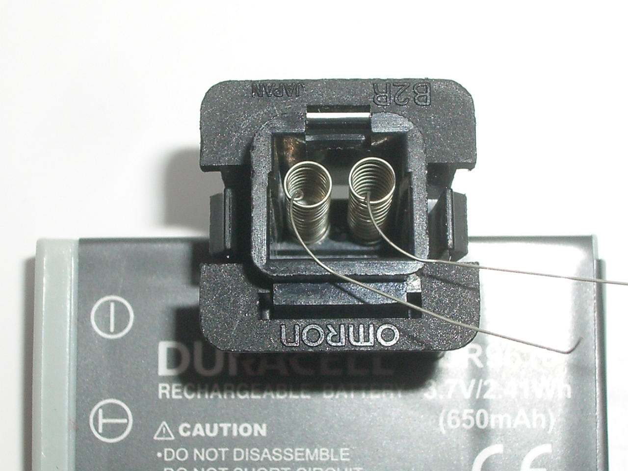

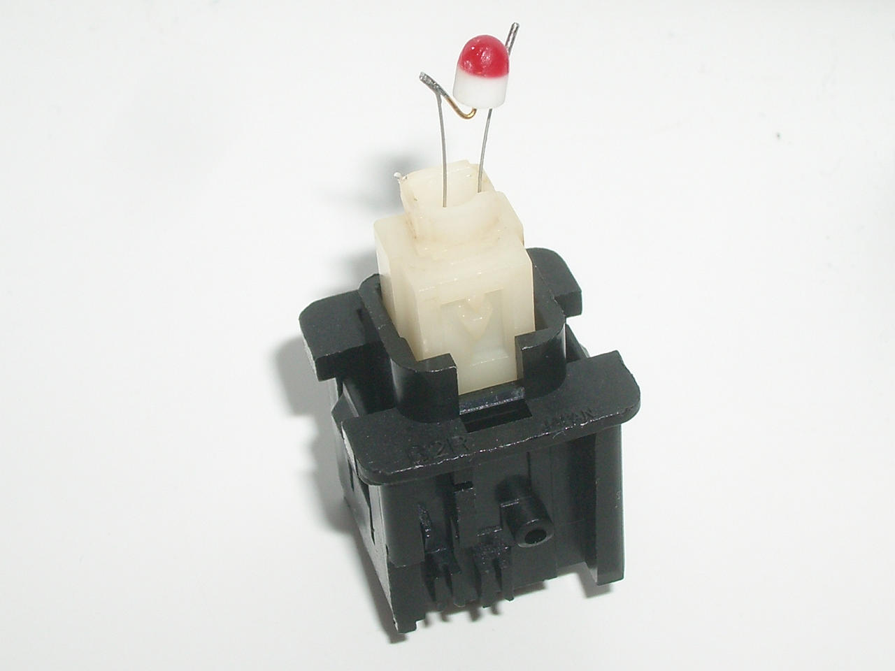

I knew that the LED version (now suggested to be B2R-ME1) couldn't use the same internals, but I didn't know what I'd find inside. It's definitely not what I was thinking:

"ME1" is written on the switch but you can't see it in the photo; the corresponding non-illuminated switch is M1, which is otherwise identical to M.
It's hard to see in the photo, but there's a cam track on the slider, so an alternate action version exists, and therefore this confirms one reason for the greebling on the shell.
I can't get the magnet out, as my tweezers have been stolen by evil leprechauns.

Very good pictures though.

I'm contemplating opening another (I have three) but leaving the LED alone — if executed correctly, the slider and both springs will all come out together. The conductor springs just rest in the bottom of the switch (giving you in effect sprung terminals). However, the POM slider is very slippery and since the pliers are likely to slip, it could end up crushing the LED. Getting the slider out isn't easy, and I've broken the keycap mount off one slider in the process already.
If I could get it right, I'd have the springs intact. However, you can't then remove those as they're soldered to the LED.
I'd like to straighten out the wires, but I'm not sure quite what shape they're meant to be. Largely vertical, since they go up inside the slider.

That construction with the LED atop those wires seems generously intricate.
Posted: 22 Mar 2017, 18:55
by Daniel Beardsmore
The LED is wedged in fairly securely.
