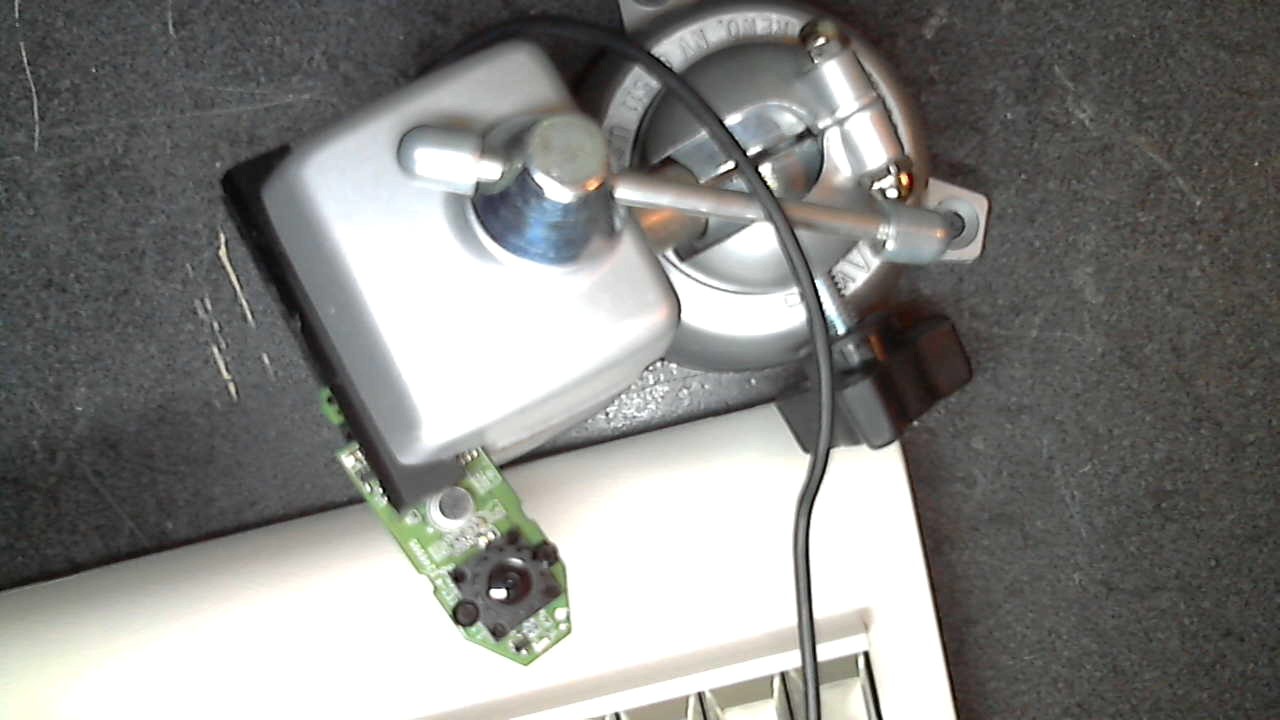

by __red__
just_add_coffee wrote: I'd be up for it! I could adjust my schedule to whatever is most convenient for everyone else.
So what do you have in mind?
Okay, I just set up a series of cameras for my workspace:
I attached "solder-cam-0":
... and as it's on a boom, high:

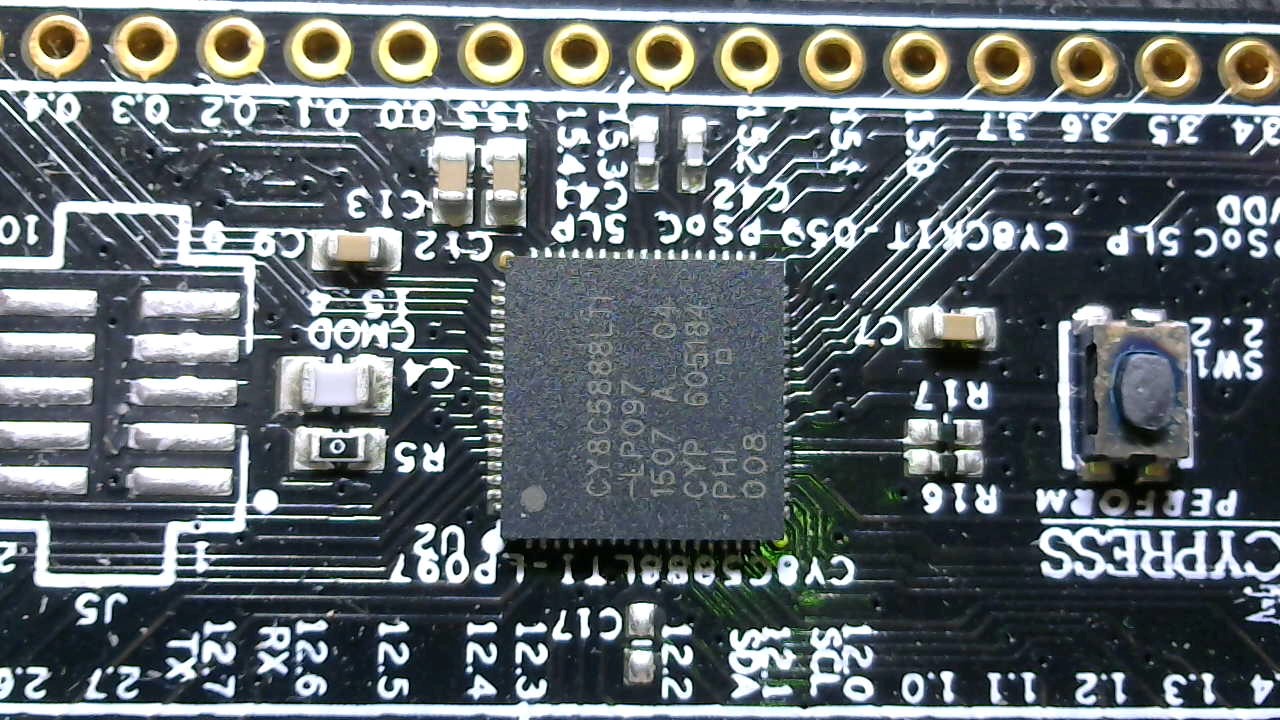

Low (has focus issues):
so we have "solder-cam-2":
Which has this view:
