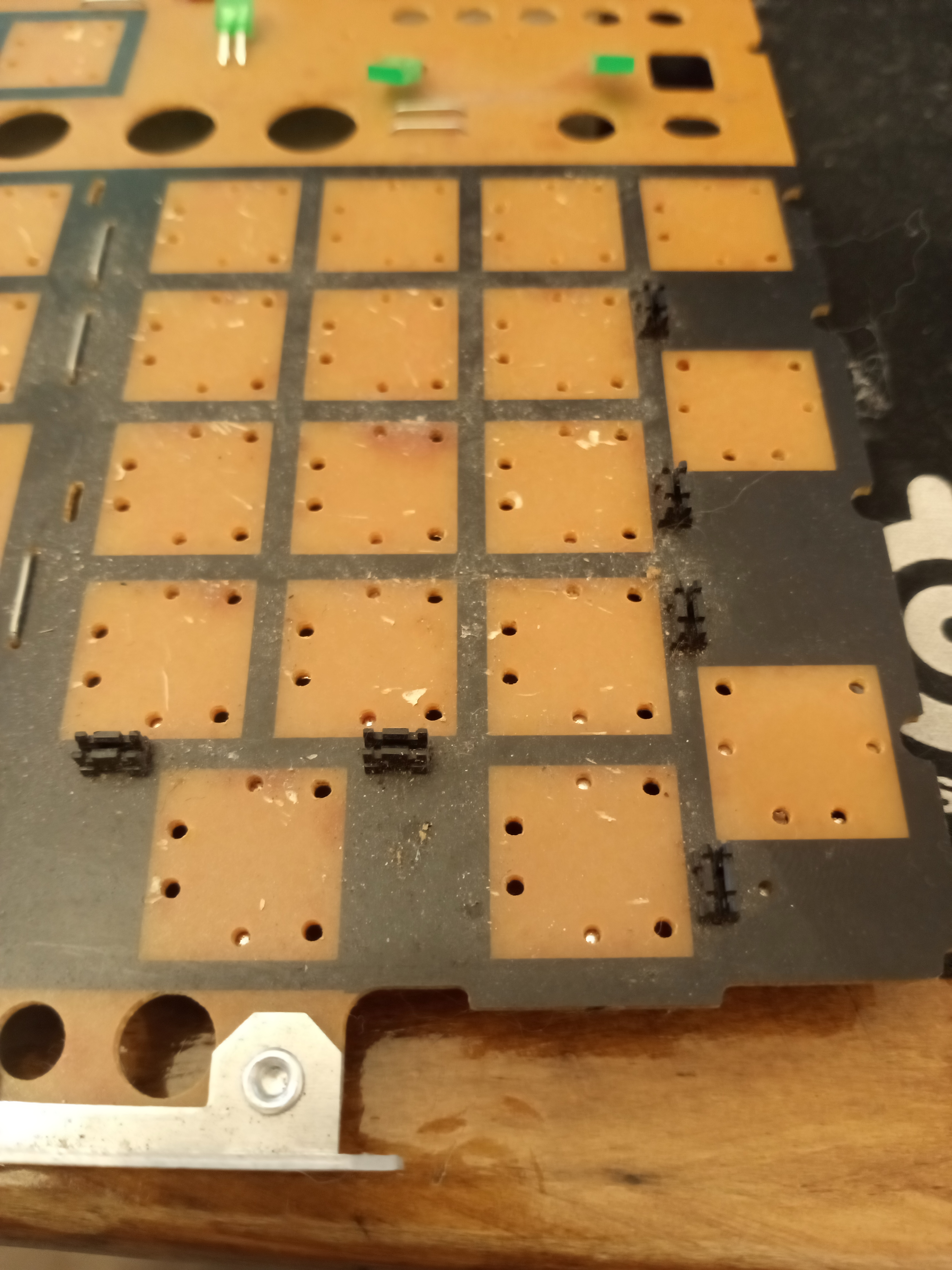

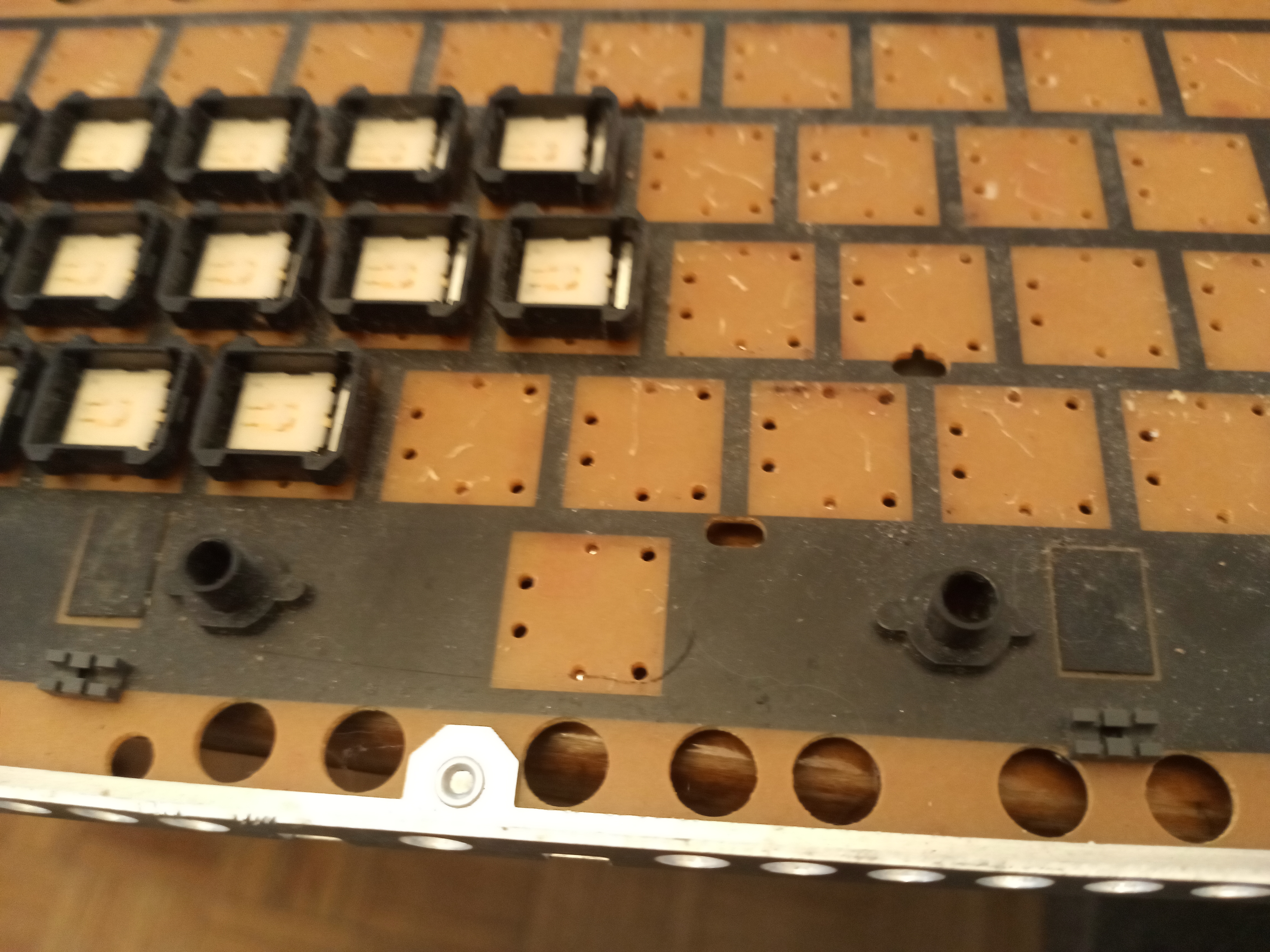

These are the stabilizers on the broken PCB P70 I got.
I could remove them and then model them for 3d printing from something like Shapeways.
The original ones are plastic melt riveted but you could have ones that clip in. That way they would be optimal height

Robb: *gives actual solution*
Me: durrrr use glue t(〃⊙౪⊙〃)/
