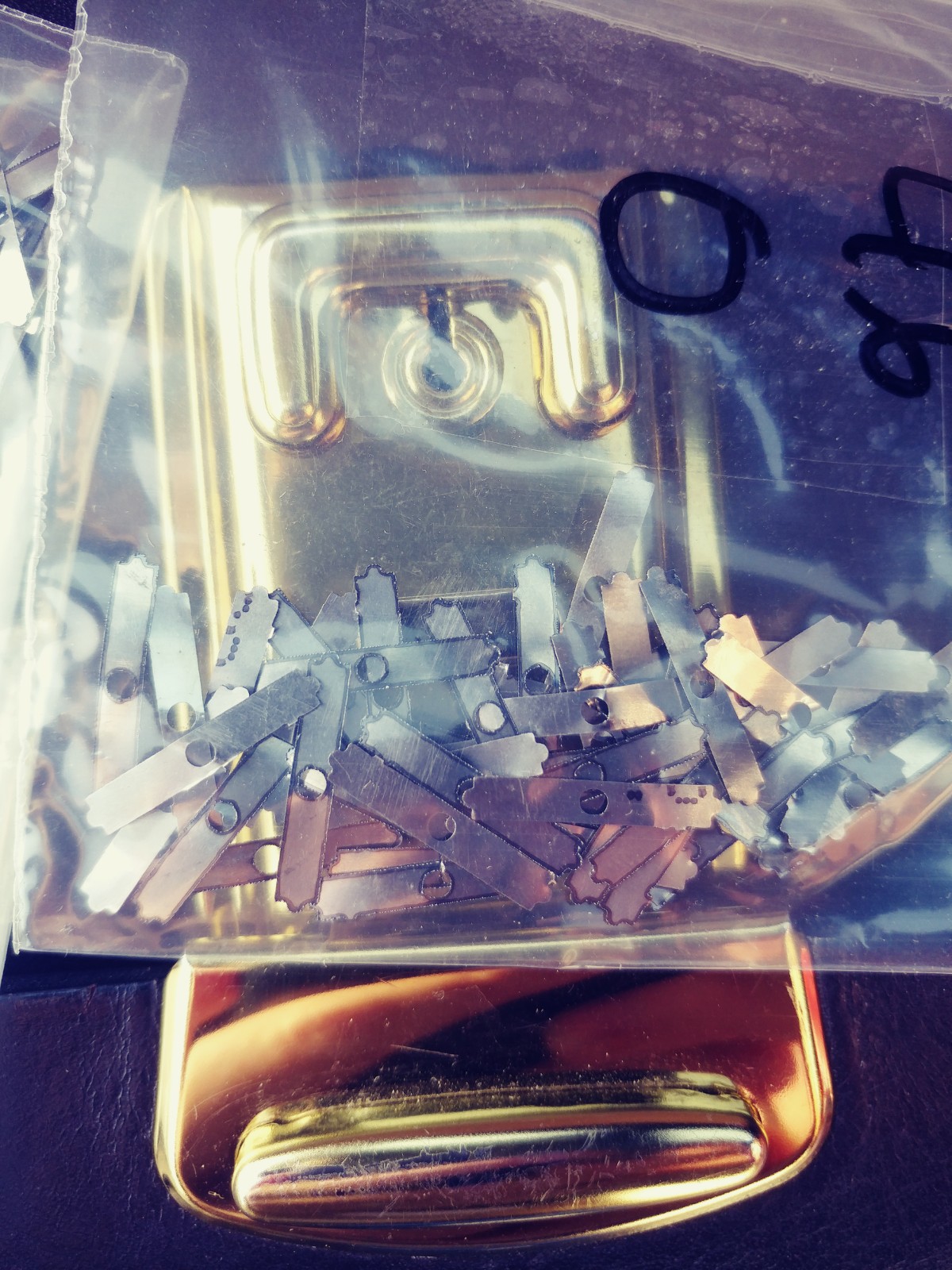

I have due to a stencil manufacturer error only about 50 flysprings in these packs. I tried for 0.003 inch thick steel this time. I think it will allow for a nicer* feel. We will see.
I will be begin bending these and combining them with my carbon 3D printed feet. I still don't know if I like the screw mount or the press mount better. I don't think it matters too much for the capacitive foot. The beamspring mount is much more critical.

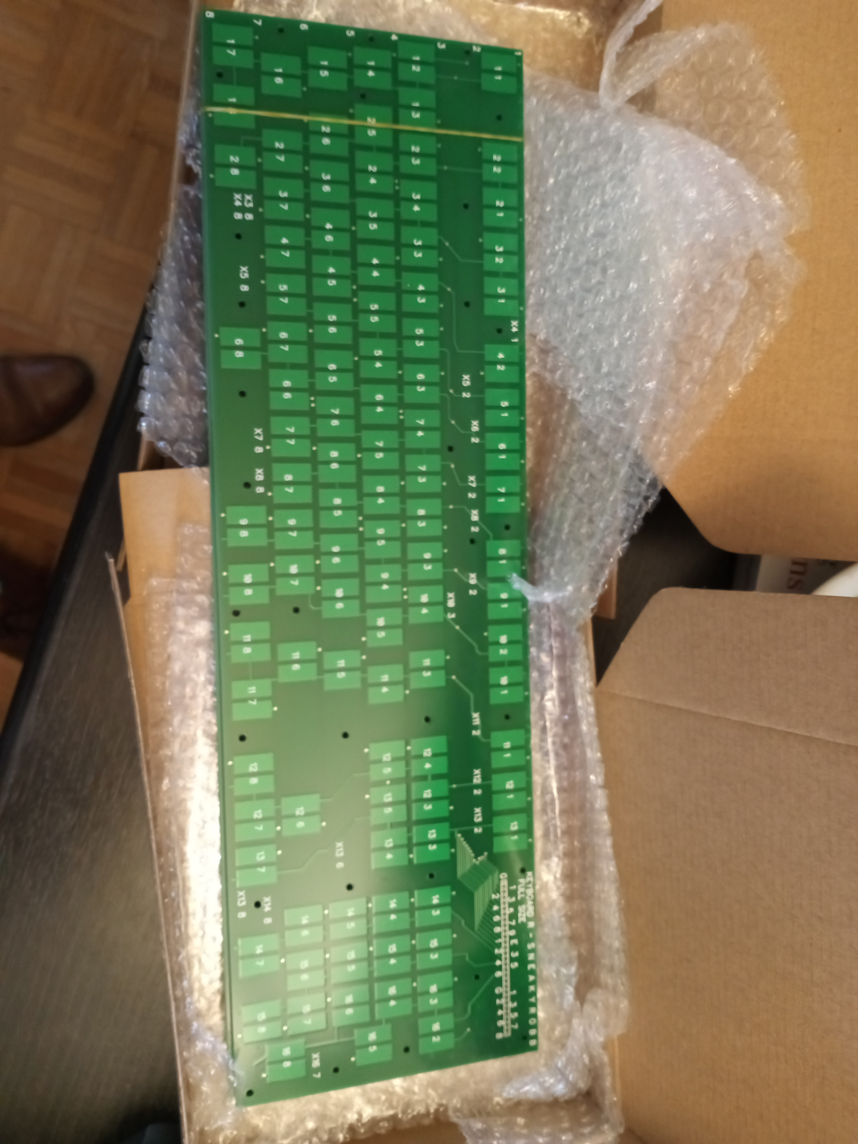

I have now received... Hopefully... please.... please?... my 4th pcb revision for the 60% beamspring keyboard. I think this one will work. I ordered it to the specs and requirements that DMA laid out for me. I think it will finally 100% work.
After this pcb, I will be begin working on my end game. The Full Sized model M style beamspring keyboard with 100% new construction parts.

Flyspring bending.
So for the beamspring flysprings. The 3d printed aparatus works just fine. ALL it takes to make beamspring flysprings is the metal and the 3d printer object to shape them on. The real key thing, is to get them square. This can be done by eye and just requires perpendicular angles. Once you get that. You can align them to perfection. The final shaping here was slightly off.
I think ill just make the bending tool which is just a quick 10 minute 3d print, have alignment slots.
Pretty okay/10

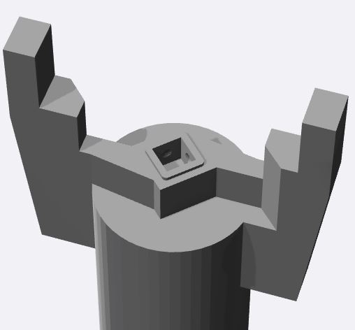

Hi, long time no see. I am still alive. I am now trying to figure out the best way to affix beamsprings to the stems. My current idea is to use resin casting to make stems with a small hole in the bottom that can be filled with more resin.
My 3d printer is okay but not the best resolution, so I have ordered the stem piece from a higher quality printer service so that I can cast it and make more.
Here is that design. It has a raised area slightly smaller than the original size cutout so it can fit on without rotating. It also has some interior texture so the resin or other can hold it in place.
- stem boi.JPG (21.45 KiB) Viewed 20190 times
Aside from that I have finally got a supply of new beamsprings!!!!!!!!!!!!!!!!!!!!!! Has taken forever to get a quote that wasn't in the thousands of dollars. They had a hard time cutting them so there were many failures, but they seem okay. Some are a little rough, but they should still work.
Will get some better photos later. Might be January before I post again but, the factory is back open.

Okay I am home. I have handled these beamsprings. They are 0.0015" thick vs the original 0.001" thick. I thought this would be enough, it isn't.
They still crease too much and are soft. The original ones are much harder and much more rigid. I got special shim spring steel but still it is no where near as strong. I am honestly going to get a blow torch and try to quench them.
Will report back.

Hi, okay.
I got some shapeways sliders to experiment attachment methods with. So I am now trying to figure out how to best attach beamsprings to these various sliders. I was thinking that I would put the beams onto the sliders with an alignment square shape. Unfortunately the square I made wasn't high enough to align the beamsprings. I will order them next time with a higher alignment square.
I would then after alignment put some resin in. This kind of worked, but maybe Ill design it with a plug, or even with a peg that I will melt/rivet them together with. Must experiment.
- beamstem.jpg (44.27 KiB) Viewed 19967 times
- alignment tab not tall enough.jpg (204.5 KiB) Viewed 19967 times

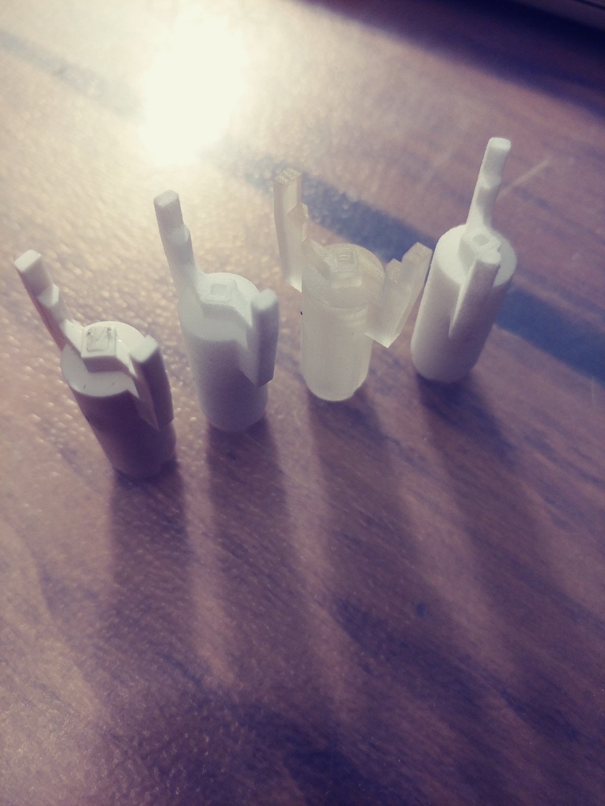

I got 3 types of plastic from shapeways from basic to very smooth clear. The basic one was actually perfectly fine and usable in terms of smoothness. There is no reason to get a higher quality plastic from shapeways. Not sure if ill print more sliders like these myself or order them.
All the stems from left to right
1 Original
2 Super smooth high quality clear plastic
3 normal plastic with finishing
4 most basic plastic
- 4 stems.jpg (244.92 KiB) Viewed 19967 times

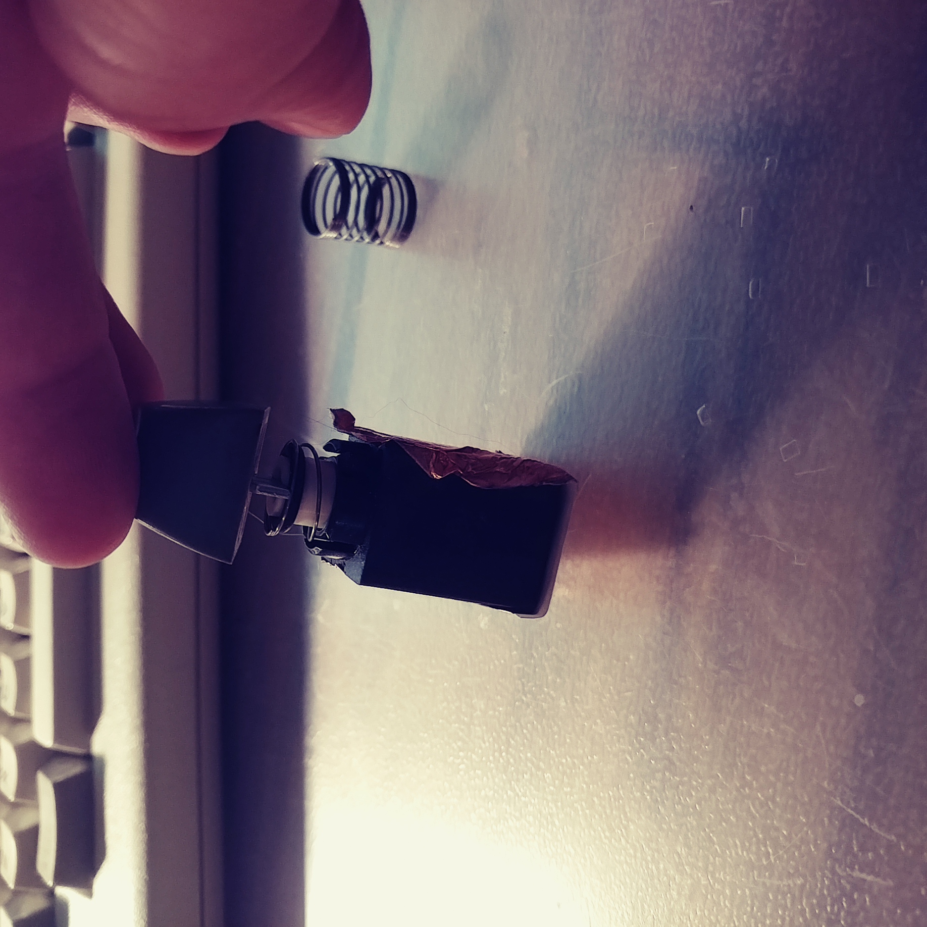

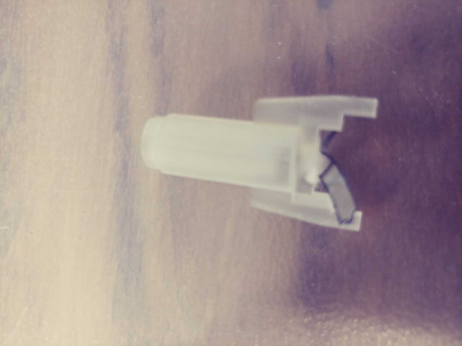

I put the resin onto the stems and hope it goes into the hole. This kind of worked, but I will improve it. 2 had too much resin, 1 had not enough.
- too much resin on all.jpg (221.33 KiB) Viewed 19967 times
- too much.jpg (117.91 KiB) Viewed 19967 times
The one without enough resin immediately broke off.
- too little resin.jpg (152.46 KiB) Viewed 19967 times
The other 2 worked great.
- stems up.jpg (188.37 KiB) Viewed 19967 times
- stems down.jpg (182 KiB) Viewed 19967 times
Then one broke. Sad.
- second casualty.jpg (186.58 KiB) Viewed 19967 times
Otherwise I am pleased with the situation. I will try to refine this attachment method.

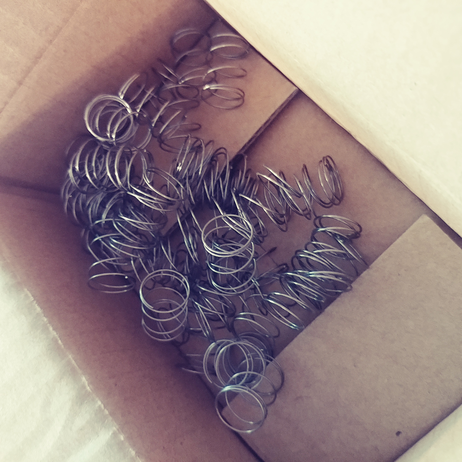

The external coil springs are probably the last unsolved element at this time.
I will eventually probably buy some of
these
https://us.misumi-ec.com/vona2/detail/1 ... wyg_area_2
or these
https://www.thespringstore.com/pc020-50 ... -n-in.html
These springs are both... roughly about where they should be. I have found that my original beamspring coil springs have a slight hard time returning up after each press. Not exactly sure why. These ones are somewhat heavier which I don't necessarily mind.
I haven't got them yet, because it costs a lot to buy them and then ship them. I will at some point though!

by SneakyRobb
Hrmm, that actually looks like it could work size wize... I'll risk it. Ordered. Thanks for the recommend!
The 0.5mm wire is actually slightly narrower as well. I think the inside diameter should still clear the middle. Spring cavity is...from memory 13.3mm at the outer, and 10.4mm on the inside..? So this 12mm OD spring with 0.5 mm wire, should be 11mm along the inside part. So it should fit as far as I can tell. Away from main pc right now.
- inside diameter spring cavity.JPG (105.74 KiB) Viewed 19799 times
ZedTheMan wrote: 07 Feb 2020, 16:54
What if you used acetone to bind the peg and slider?
Hi,
That is also a good idea. I got these from shapeways for fun because I had a gift certificate. I will also try printing in ABS for that reason.
As well my milling operation has been very very slow to develop but I can now reliably cut holes. So stay tuned for that!
- 20200202_144040.jpg (2.59 MiB) Viewed 19799 times

So the springs lucar recommended finally arrived.
They have many less coils than the original ones but are taller so will be compressed. Will upload some more images later of an original switch assembled.
They seem to offer about the same resistance but I don't have a thing to measure.
They are the correct diameter and do fit in the switch. They came in a giant ball so it was hard to get them apart.
I am building up the nerve to disassemble an original switch because I always somehow slice my hand open doing so.
On a reproduction switch, they do work, but I want to make sure on an original switch that they could work.
I hope to report back soon they do, fingers crossed.
Hopefully this month the teflon tubing will arrive so I can affix it to ABS printed sliders.
Robb
- side by side.jpg (912.16 KiB) Viewed 19478 times
- old.jpg (829.79 KiB) Viewed 19478 times
- new.jpg (916.67 KiB) Viewed 19478 times
- box.jpg (1.34 MiB) Viewed 19478 times

Okay. I can confirm that every other piece being original. The springs user lucar recommended, work.
A video ( the tape method is responsible for noise differences. Also my wife was listening to some music in the background...)
https://youtu.be/3N6w2Tx058s
Another video where I remove the tape on the original so you can hear it held against table.
https://www.youtube.com/watch?v=R_Ef86WL1gk
So, thank you lucar, springs WORK.
- 20200314_192239.jpg (1.12 MiB) Viewed 19452 times
- 20200314_192501.jpg (1.11 MiB) Viewed 19452 times
- 20200314_192505.jpg (1.08 MiB) Viewed 19452 times
- 20200314_192613.jpg (943.2 KiB) Viewed 19452 times
- JPEG_20200314_192538.jpg (1.15 MiB) Viewed 19452 times

I should really try making the dual stem pieces ive mentioned out of metal this time. I think this could make for a sturdier keycap interface for mx keycaps.
I don't think i've posted this image before...?
regardless I will mill some of these in aluminium to see how they work with mx keycaps.
I was thinking of some 1/4 circular pieces that would slide in the plastic stem-tube part to make the metal-stem not rattle a lot. When you pull out the locking metal stem piece, the circle parts would not be held in place anymore and would just fall out.
- 2 piece and a keycap.JPG (80.55 KiB) Viewed 19150 times

by SneakyRobb
Hi sorry about this question. I have just received this new pcb so I will update this tomorrow.
Will finish this project soon.
Beamspring model m is soon.
