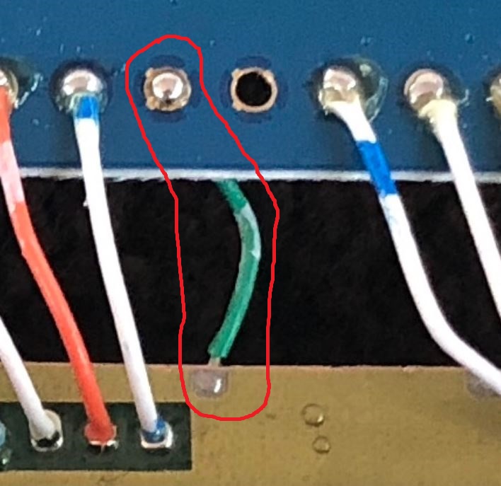

I've got just one question. Where does this green and white wire goes? To the ground on the back side?
