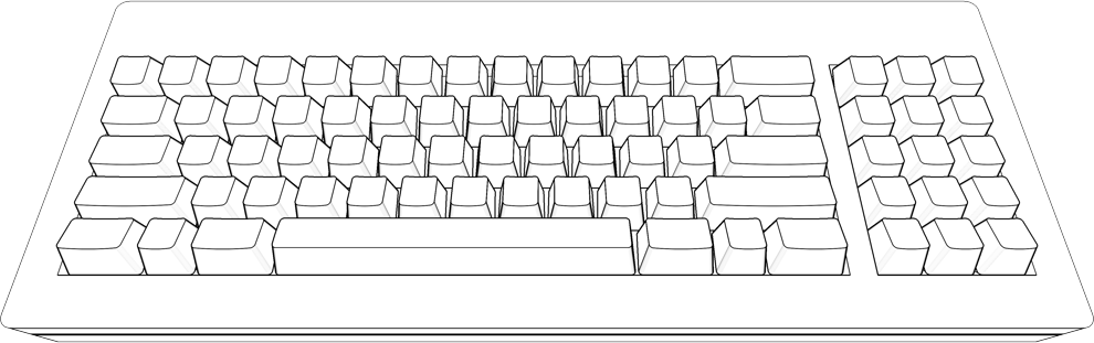

The first version of my ISO enter render had an artifact:
All the later renders have that fixed:
I'm pointing this out in case darkcruix cares enough to change the images.

Zcool31 wrote: 01 Sep 2020, 17:54 The first version of my ISO enter render had an artifact:
He definitely does ;) and will change it today (I have planned to make some more cosmetic changes later...

The pictures in section 2.1 look fine on my 1440p desktop display, but unfortunately they look quite atrocious on my tiny 1366x768 laptop. I need 250% zoom for the lines to resolve.
Re: Model F Technical Manual Project
Posted: 03 Sep 2020, 14:00
by darkcruix
Zcool31 wrote: 03 Sep 2020, 12:14 The pictures in section 2.1 look fine on my 1440p desktop display, but unfortunately they look quite atrocious on my tiny 1366x768 laptop. I need 250% zoom for the lines to resolve.
The PDF is created for printing ... I try the lower res PDF at: http://www.linux-tin.org/ModelFManual-Small.pdf. I have automated the creation of a lower res version that should look much better on screens.

Posted: 03 Sep 2020, 16:09
by Zcool31
100%:
250%:
My shader produces lines in screen space. If I render at lower resolution, it will look very different than scaling down a high resolution image.

I only have a MacBook Pro with me and the pictures look good - wither directly in Microsoft Edge or in Preview.
I did re-run your pictures through a 300dpi dither filter. Maybe this is causing some issues, too. Both of your pictures look ok to me.
Posted: 03 Sep 2020, 16:23
by Zcool31
720p:
480p:
Note: that isn't the actual final resolution. It is the size of the buffer to which I render before cropping empty space around the keyboard.
Edit: Original resolution scaled to 480p:

I can create two versions - one for screen view at e.g. 720p and one for printing @ 300dpi or more.
For the re-creations in Photoshop (e.g. Split Keys) it is a bit more complicated, as it will take me some time to re-create them all in low resolution manually.
Best way would be a SVG file and line-art (nothing that can be rendered). Any thoughts, how we could do this in a better way other than having a low and high-res version?

The key layout views actually look fine - possibly because most lines are perpendicular. Only the perspective projection case views look not great.

Zcool31 wrote: 03 Sep 2020, 17:19 The key layout views actually look fine - possibly because most lines are perpendicular. Only the perspective projection case views look not great.
Oh great - then let me get the two versions of the PDF done. I will re-create the low-res version done with all pictures converted from the original version to a width of 1280 and replacing the perspective projection ones with the new versions you have attached...

OK, uploaded a new small version with the 720p versions of the compact keyboards. Can you check?
