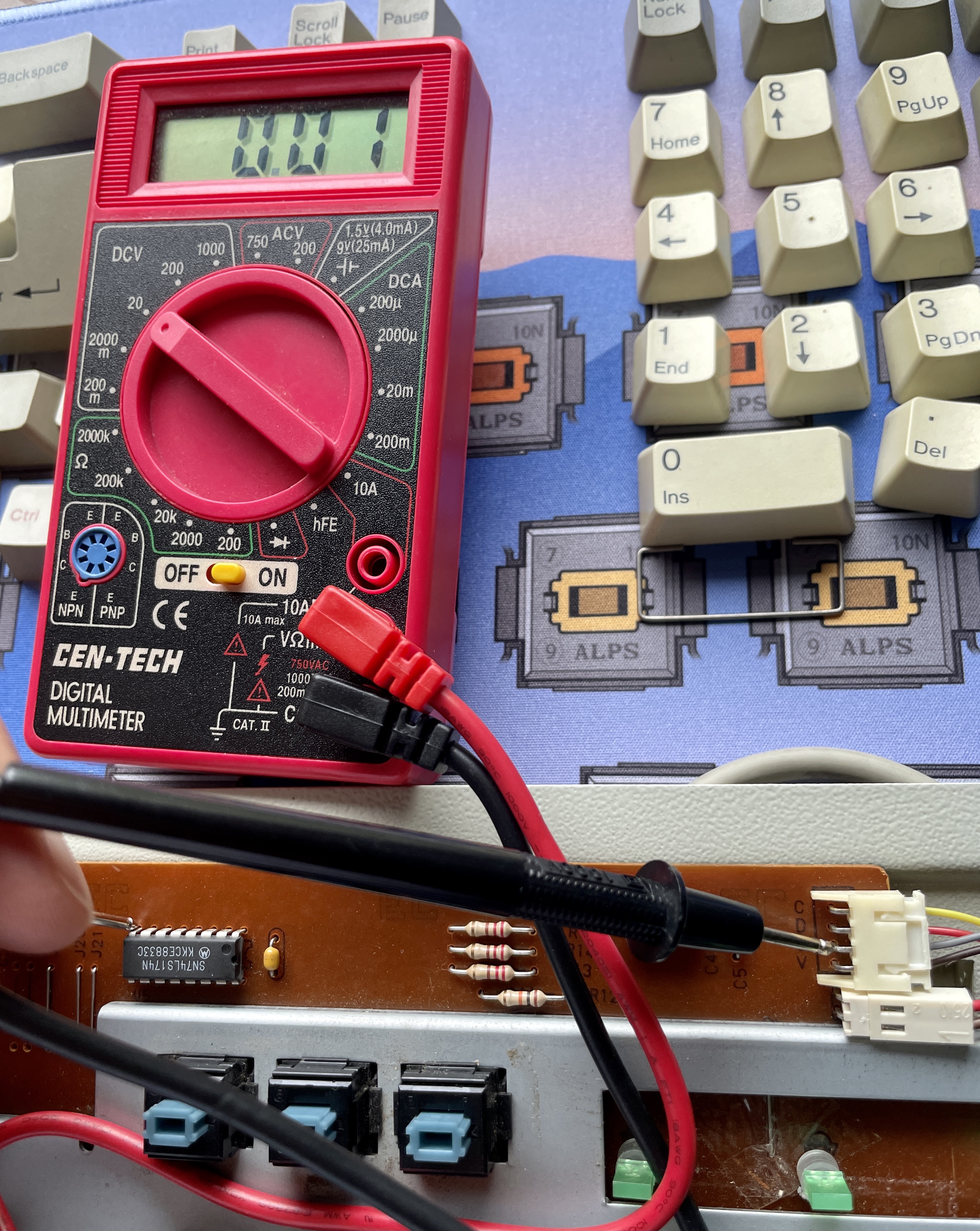

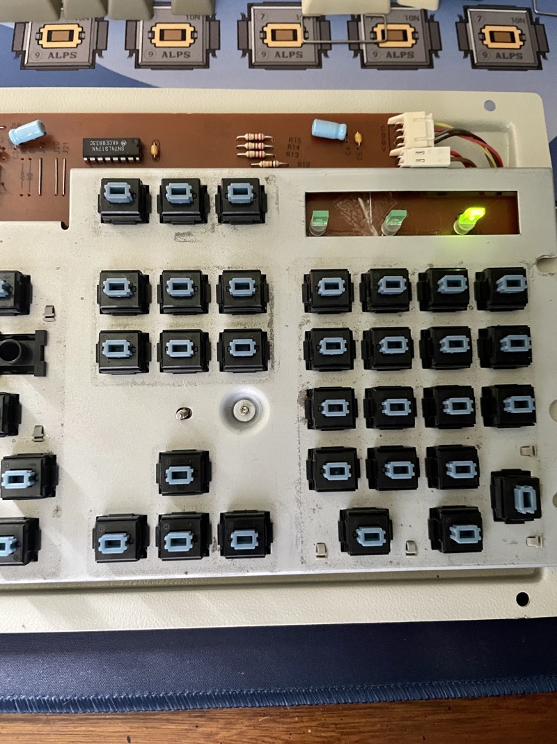

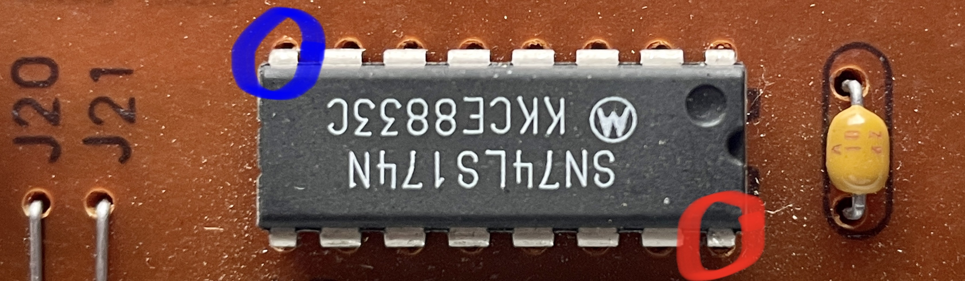

Update. I followed jmaynard's advice and tested the SN74L chip, looking to see if pins 16 and 8 had +5 volts. For reference I included a picture of the SN74L chip below and marked pin 16 in a red circle and pin 8 in a blue circle. If I misinterpreted please let me know and i can remeasure.
SN74L chip
SN74L chip

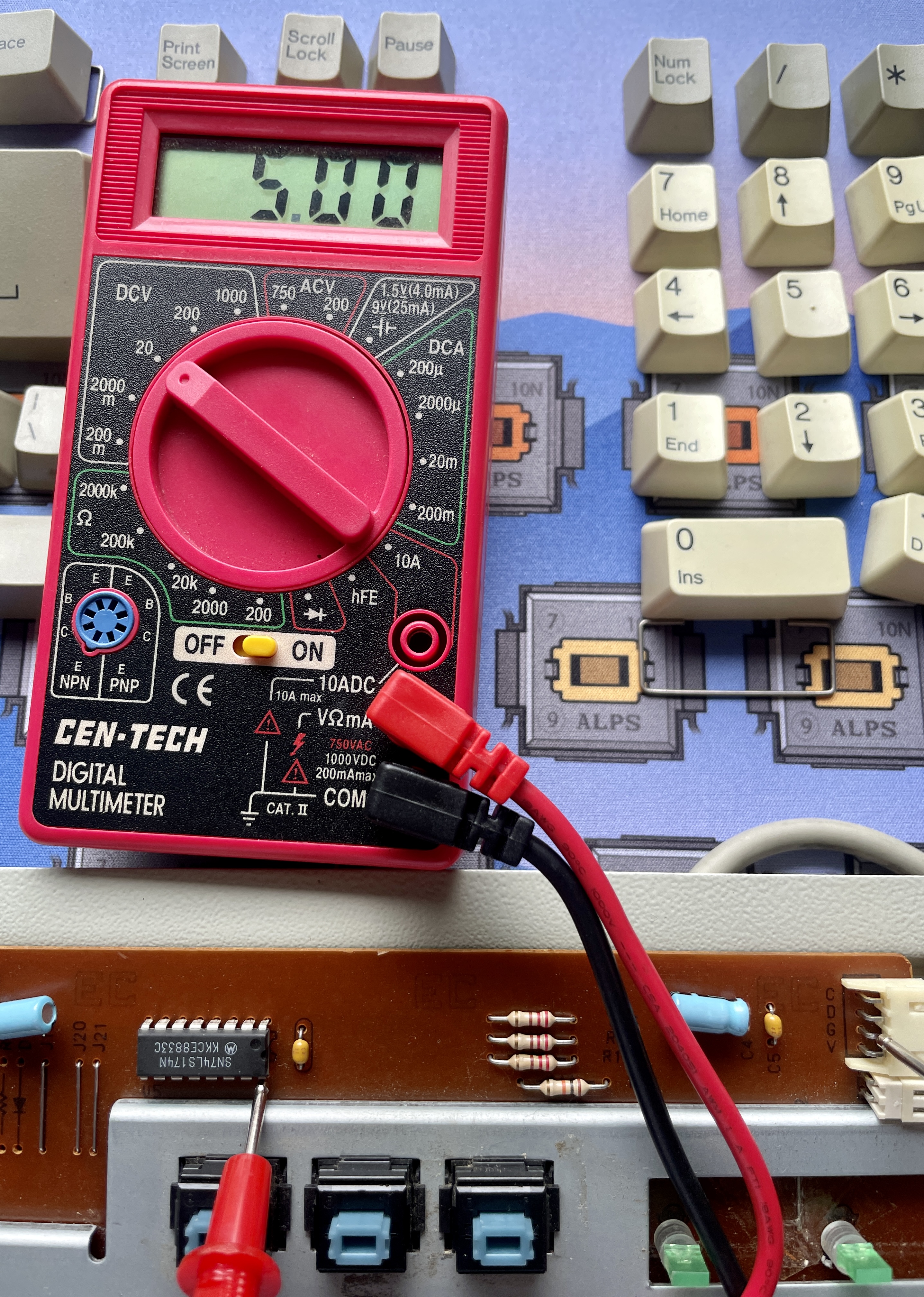

I measured the voltages by placing the common on the multimeter to the ground or "G" as indicated on the connector for the main (bottom right of the picture below) wire and placing the red terminal on each pin in the SN74L chip. The pictures below show my method and results for measuring each pin. I measured +5V on pin 16 and almost nothing on pin 8. Below are pictures of my measurements. Would the low voltage reading on pin 8 indicate a problem?
Pin 16 measurement
Pin 16 measurement
Pin 8 measurement
Pin 8 measurement

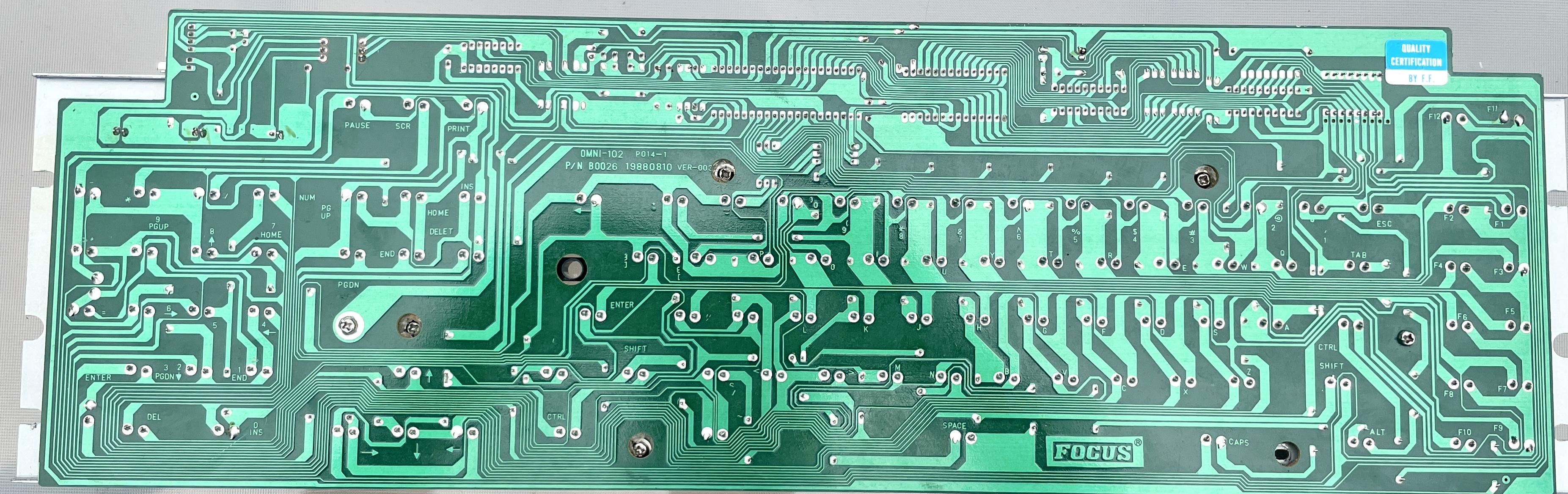

Willy4876 suggested checking out the solder joints and PCB and I examined the back and everything looked mostly normal. I did notice some scratches on the back that go across several connections, but the scratches don't look deep and I would think the scratches would only affect the keys with the broken trace. Below is a high resolution picture for reference.
Back of PCB
Back of PCB

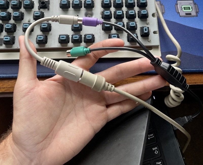

It occurred to be I'm using two adapters: an AT to PS2 which connects to a PS2 to USB, and I wonder if that could be the problem. I'm going to seek out another adapter to further troubleshoot, but I don't think it's the adapter based on another new observation.
I have two PS2 to USB adapters and while connecting in each one to see if there was any difference, one of them started showing the Scroll Lock light. Pressing the School Lock button would turn the light on and off, but none of the other keys or function lights would appear. After ~10 seconds the Scroll Lock light would turn off and the keyboard wouldn't respond until the adapter was reconnected. Below are pictures of the adapter setup I'm using on the Scroll Lock light.
Adapter Setup

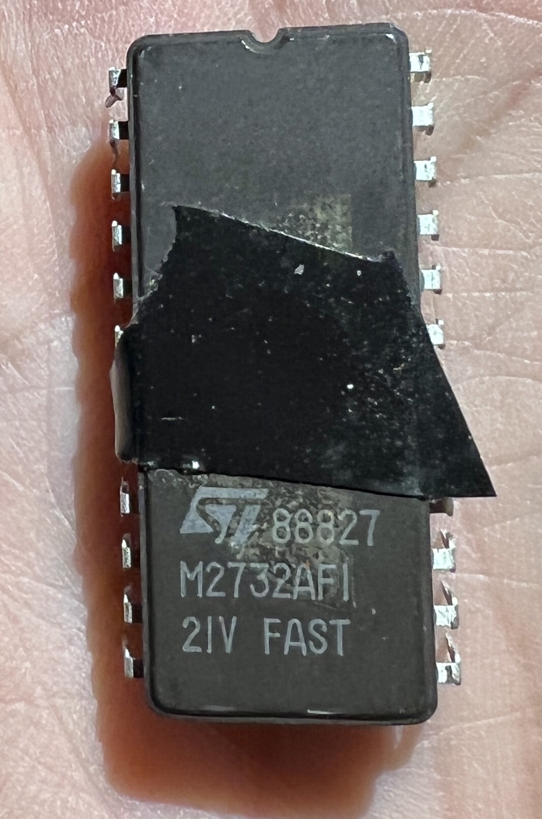

I have a final update and good news. My Omni Key 102 is working and I am typing this post with it! I decided to reach out to "Northgate Bob" to see if he had any advice and he recommended sending it to him for evaluation. Bob determined the controller was bad and he didn't think it was the correct controller for the keyboard. Luckily he had a spare and replaced it. When I take the case off to clean and retrobright I'll post a picture of the controller he used. He also found a dead F10 switch and replaced the anti-slip pads.

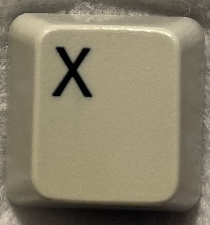

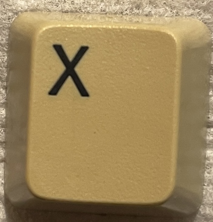

My next steps are to clean and retrobright the case. I retrobrighted the keys and they came out great, so I'm hoping to get similar results with the case. Below are some before and after pictures of the keys. I have a lot of the liquid version of salon care so my plan is to completely submerge the case and use a UV light. To be safe I'm going to make a high resolution scan of the labels and cover them with tape just in case the retrobright process alters the colors.
Before retrobright:
Before retrobright
Before retrobright
After retrobright:
After retrobright
After retrobright

Below is a picture of the bad 24 pin controller Bob removed and replaced with a 28 pin. I’m not sure if it’s completely dead or if it’s possible to repair. I think it’s the EPROM because it isn’t soldered in place. I don’t have any use for it and if you’d like it let me know.

thefarside wrote: 26 Feb 2022, 03:25
Yes, that's the EPROM. The controller is a 40 pin chip, either an 8039 or 8049. There's probably a jumper to select the EPROM size. They usually don't go bad electrically, but they can lose their programming if exposed to UV light with the label removed. That's how you erase them before reprogramming. Thanks for the offer, but the only reason I'd want it would be to save the programming, and if it's bad that wouldn't be possible. Good to know the 28 pin (2764) will work in place of the 24 pin (2732) (possibly with a jumper changed?).
