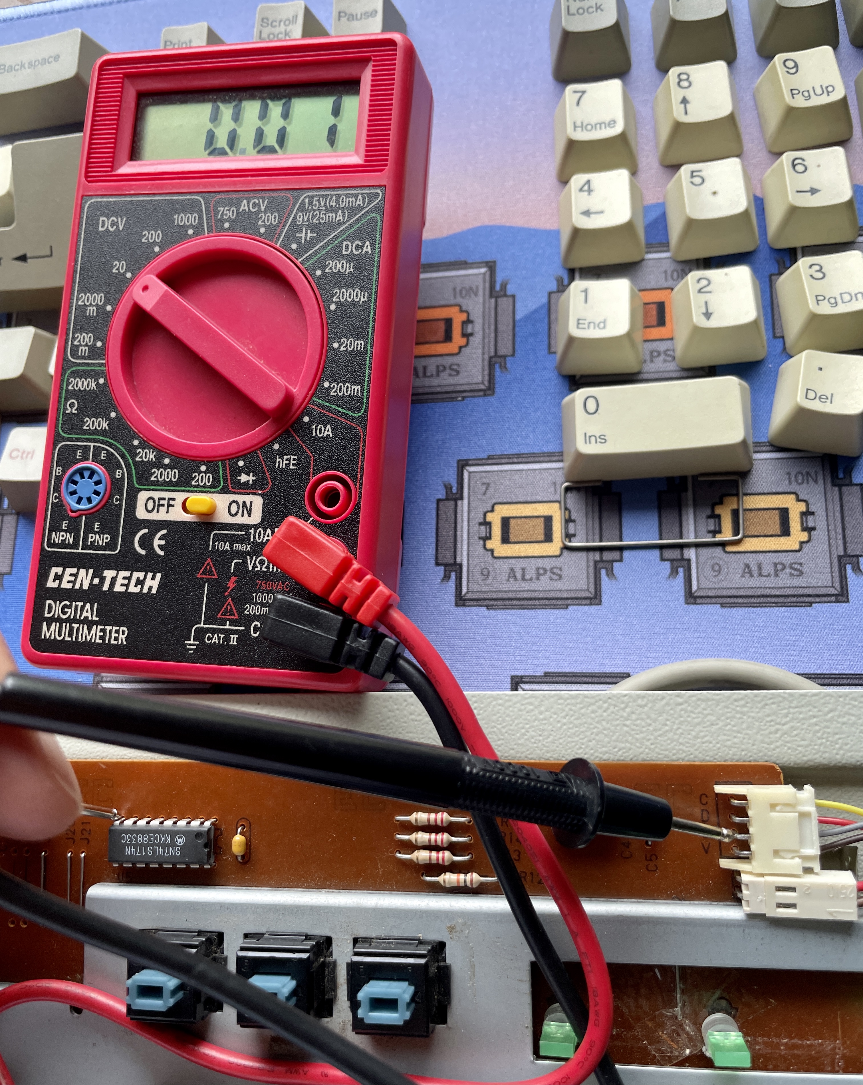

Update. I followed jmaynard's advice and tested the SN74L chip, looking to see if pins 16 and 8 had +5 volts. For reference I included a picture of the SN74L chip below and marked pin 16 in a red circle and pin 8 in a blue circle. If I misinterpreted please let me know and i can remeasure.
SN74L chip
SN74L chip
I measured the voltages by placing the common on the multimeter to the ground or "G" as indicated on the connector for the main (bottom right of the picture below) wire and placing the red terminal on each pin in the SN74L chip. The pictures below show my method and results for measuring each pin. I measured +5V on pin 16 and almost nothing on pin 8. Below are pictures of my measurements. Would the low voltage reading on pin 8 indicate a problem?
Pin 16 measurement
Pin 16 measurement
Pin 8 measurement
Pin 8 measurement
