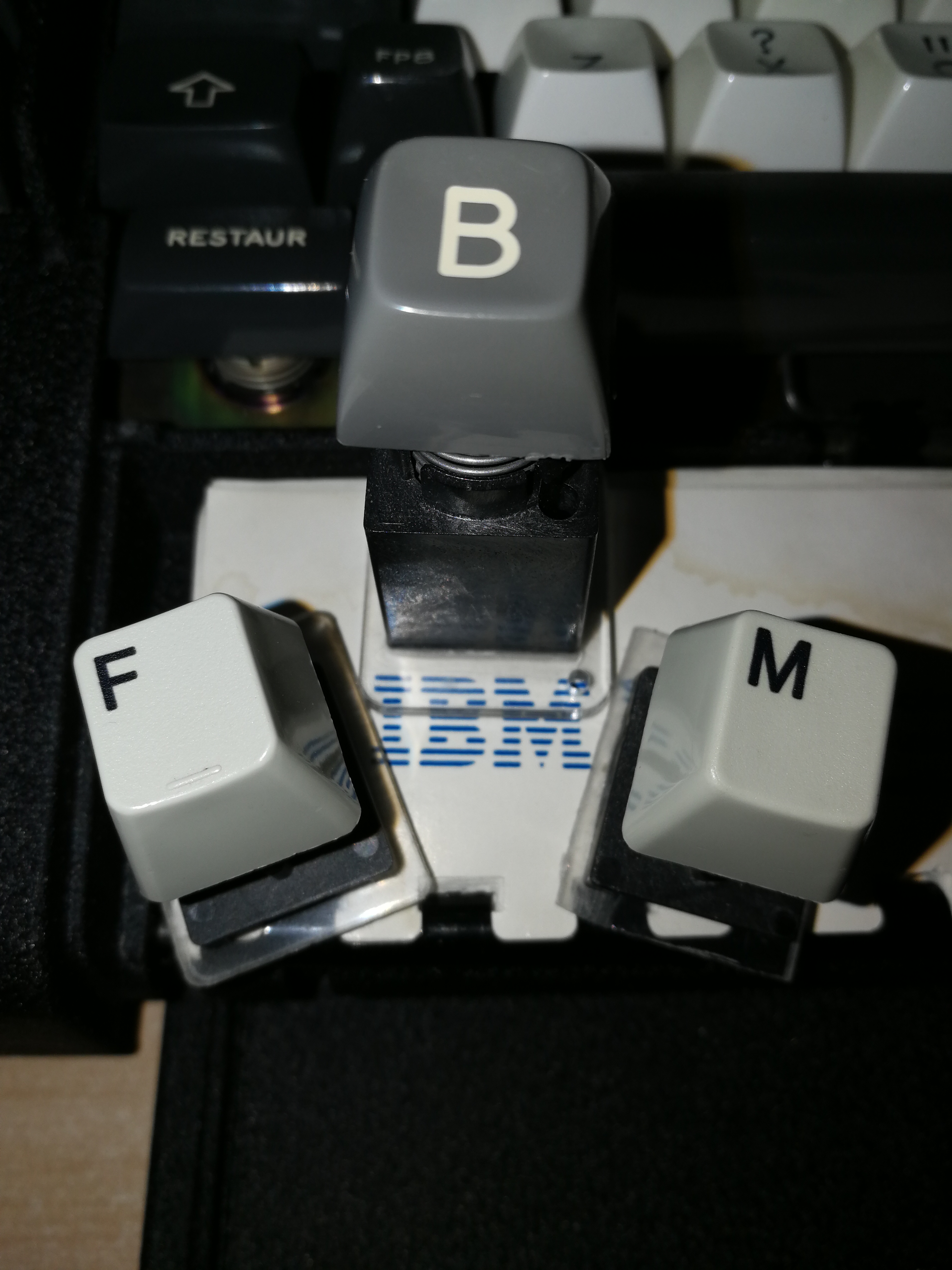

1. Noise Level or Audible Feedback
I remember my early days at work, when the overall sound in the open spaces was a different one than these days. The last time I went through our office (yeah, this is now some time ago due to Covid), it was mostly quiet. A voice here and there, but that is it. The early days had this mixture of people on phones, printers and copier machines in the background. Maybe a fax machine was ringing. You also got the keyboard sound that was so distinctive of the era. The keyboard clicking wasn't louder than the average office space if I recall correctly.
Was it an important design feature to have not only a haptic but also a audible feedback? Was it designed to sound in a specifc way and did you spend time on adjusting it?
2. Nomenclature
I am explaining the Barrel Plate Sandwich with its parts in the document and I used nomenclature that I felt is most descriptive, but I wanted to hear your thoughts on it and what the original "names" have been.
Find attached to this post the page I am referring to.

I have been using a 3d printer with a conductive filament to print beamspring capacitive elements. I have also tried copper tape and a conductive paint for model f capacitive elements that I printed in photo resin. The model f reproduction used plastic Torayca ASHT-18A with 18% carbon.
1.
Do you happen to remember what plastic the beamspring and buckling spring elements were as well as the conductive material?
I would think something like graphite would work but given the capacitive nature I wonder if that would create dust etc that would mess up sensing. As graphite itself is quite lubricating and it could flake off. I would guess that the f flipper was likely a self lubricating type of plastic. When you cut a model f flipper it almost shatters like pencil lead. My 3d printed beamspring elements with the conductive plastic worked perfectly and were sensed even by the original PCB.
2. Idollar flipper shape
We can see in this post from user idollar.
viewtopic.php?t=9715
How the model f flipper has several variants. Round, notch and cut corners. They are seemingly interchangable. They have even been found in the same keyboards with no pattern or reason for their use. Do you know why these variants exist? Did different factories make different ones?
Why do the springs have slightly different angles between the variants.

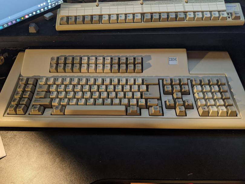

Do you know anything about IBM 9002
viewtopic.php?t=13319
Specifically the XT with integrated top membrane area? Did you even see or design similar pads of membrane switches.

Where were beamspring boards made? My 3278 case for instance said "IBM 1977 Canada."
12.
Did you design the spacebar stabilization system of the F XT keyboard? The space bar has a underbarrel stabilization spring that require disassembly to reinstall. Why was that method chosen over the exterior wire stabilization like on earlier beamsprings 3277, 5251 etc.

Hi Dick, it's an honor to be talking to you!
I have two questions for you.
1) What were the priorities for you and your team during development of switches? Was it overall keyfeel, cost effectiveness, durability, or something else that took priority over everything else?
2) What are some of your favorite stories from your time working at IBM? I expect you must have had some real high notes working there!
Thank you again for answering my questions, I am a huge fan of your work! My 122 key Keyboard F still gets loads of use, even after so long!
