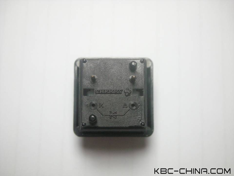

I did some stalking research while I was waiting for a response from ysb8433 in this thread, I found out that he posted a very detailed documentation of the switches he owns here, but it's in Chinese and you have to be registered for an account to see pictures. I tried to register but for whatever reason it's refusing to send me an account verification email, maybe it'll go through later. By the way, Parak, that's an awesome find! Congrats, you're the first person ever to have a confirmed M9 switch! ;)
EDIT:
You just have some sort of mongo M9, as normally the stem is nowhere close to being that tall.
I'm pretty sure it's standard, if you look at the datasheet, pg 26 bottom right hand corner, you can see how one of these switches has an LED that is hidden out of view inside of the keycap. Specifically, it seems like that switch is a M93A-12RW. Finally this stuff is starting to match up now! :)

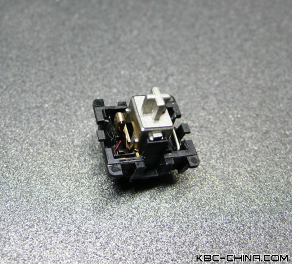

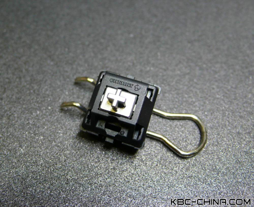

I decided to try and give the "likeykeyboard" website a shot again, and I managed to get it working. They have a HUGE amount of undocumented switches, I downloaded the webpage and tweaked the html a little bit because the images weren't showing. Here's some pictures from that post that were especially awesome. This is significant enough that we should really find someone to translate this, it's in Chinese. The zip of the webpage is attached.
A metal-stemmed MX switch!

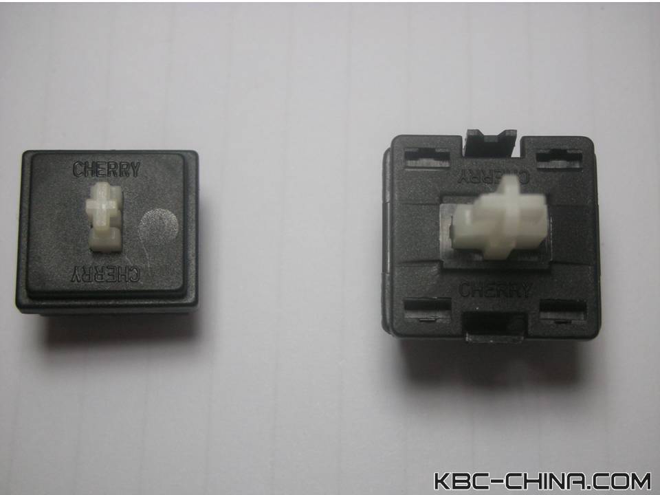

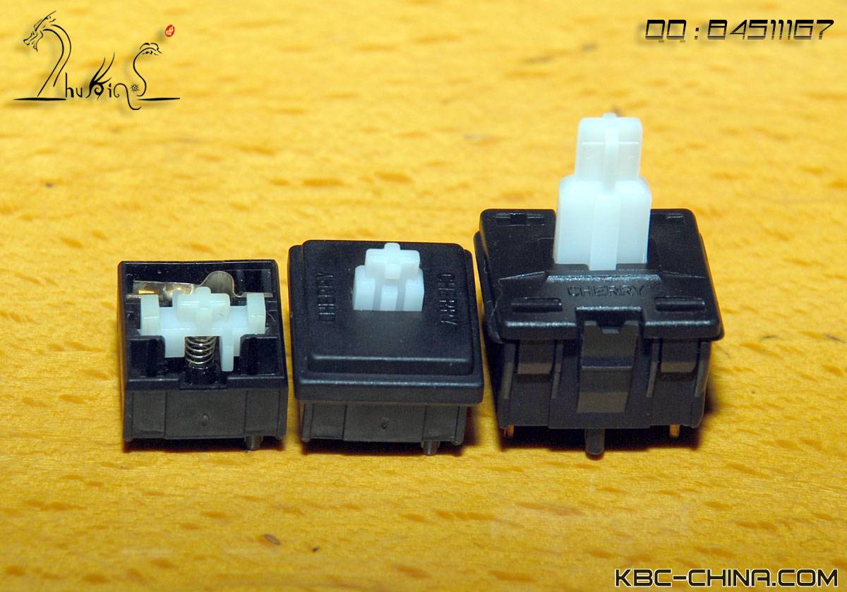

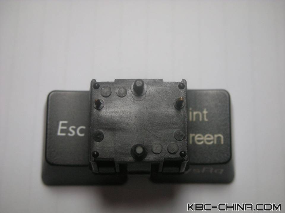

Alright, sorry for the post spam, I found another thread that shows a bunch of different types of M8 switches, and an M9 switch without an LED, as seen earlier in the thread. I'm not sure if they know that it's an M9 switch, I don't think they have the cherry manual for it... they probably think it's an M8 switch. (from this thread.)
EDIT: Forgot to attach a zip of the webpage.
CherryM8.zip
(4.92 MiB) Downloaded 238 times
From left to right: M8 w/o top, M8 w/ top, M9

mintberryminuscrunch: would you be able to confirm visually which internals match which branding, i.e. how do your Hirose Cherry M8 switches compare to the German Cherry M8 switches? My suspicion is that the ones with the unusual internals are a modified Hirose design, and that the ones that match the Cherry catalogue photos are the German production runs.
Just a single photo of each switch showing the top view next to the bottom view, with the base branding visible, would be fine.
Thanks.
06 Feb 2014, 02:17
I've just added a couple of recognition diagrams to the M8 page:
http://deskthority.net/wiki/Cherry_M8#Recognition
I've drawn them the best I can from the photos available, and a lack of any measurements (photos have perspective skew that messes up drawing diagrams).
They are at least adequate for the existing purpose. The diagrams should also go in this section [wiki]Switch recognition[/wiki]; maybe one day I'll figure out all the different mounts and knock up a bunch of diagrams accordingly, but I would rather have the existing diagrams corrected first before I spawn a load of new ones that would need correcting likewise.
Let me know if there are any exceptions to this Germany/Japan split.
