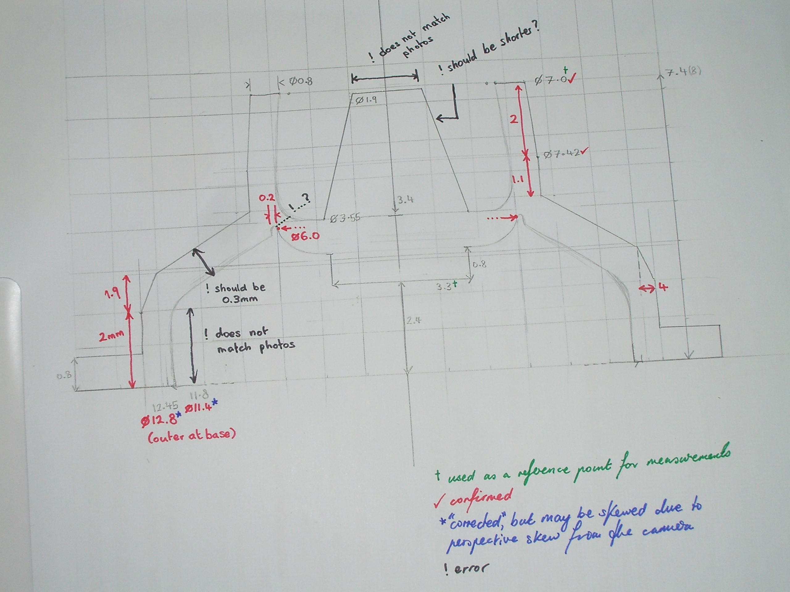

Daniel Beardsmore wrote:So you mean that the outer wall of the upper well is 0.8 mm, while the outer wall of the lower well is only 0.325 mm?
Yep - although I was just being a smart-arse with the 0.325mm guess. I honestly have no idea how thick it is and I don't wanna destroy the dome to find out. It's really thin though - maybe even less than .325
Daniel Beardsmore wrote:z is the diameter of the holes in the bottom membrane, but for some reason I got mixed up between bottom and top.

Posted: 28 Jul 2013, 00:18
by Daniel Beardsmore
This is the most sense that I can make out of the photos and measurements. It doesn't look anything like the photos at all. ("Confirmed" dimensions are those taken from the photos, taking one of your measurements as the reference point, and ignoring perspective skew.)

Posted: 28 Jul 2013, 00:53
by 002
I might just send you one of the domes and you can check it out for yourself. I think what you've got looks pretty close.
I should still have you address so i'll pop it in the post next week.
