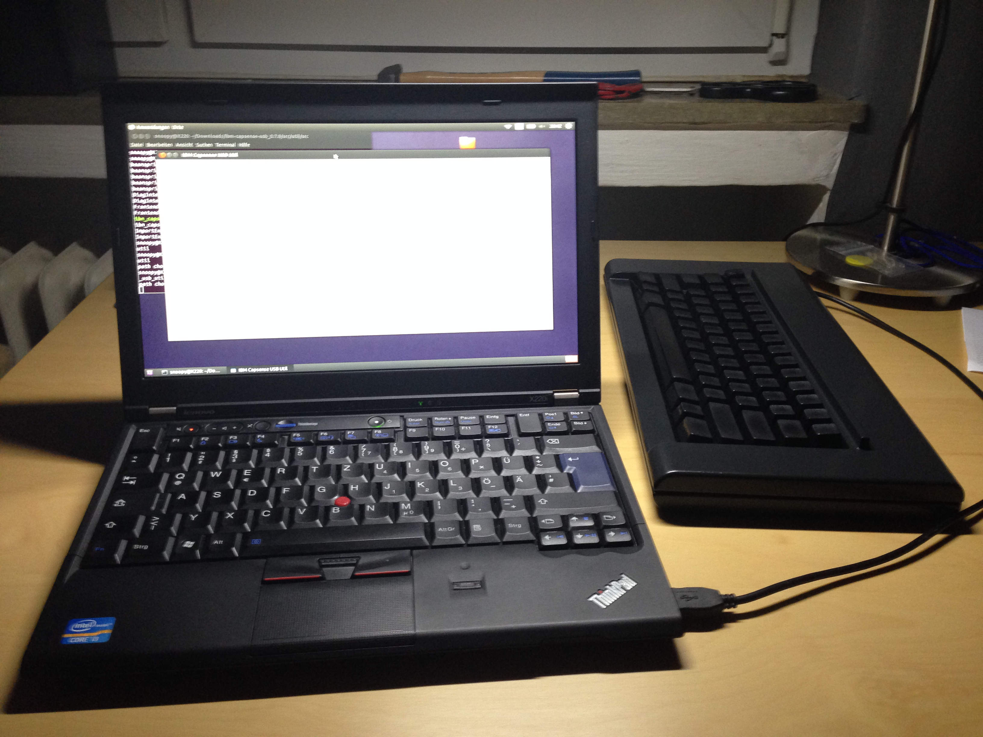

by snoopy
finally I can talk to my Kish... (no chance getting that util run under os x)
- Talking with my BlacKish
- IMG_2261.JPG (490.07 KiB) Viewed 24775 times

some first impressions of my BlacKish:
Ingredients:
- powdercoated RAL 7021 (case and plate)
- new foam
- xwhatsit Model F rev2 controller
- blank black unicomp keycaps
- depth black bs clickclack (finally it has a suitable home)
- wcass spacebar stabilizer
ToDo:
- floss mod
- new usb cable
Big thanks to tinnie, wcass, xwhatsit, monster-toys, and of course cc.
