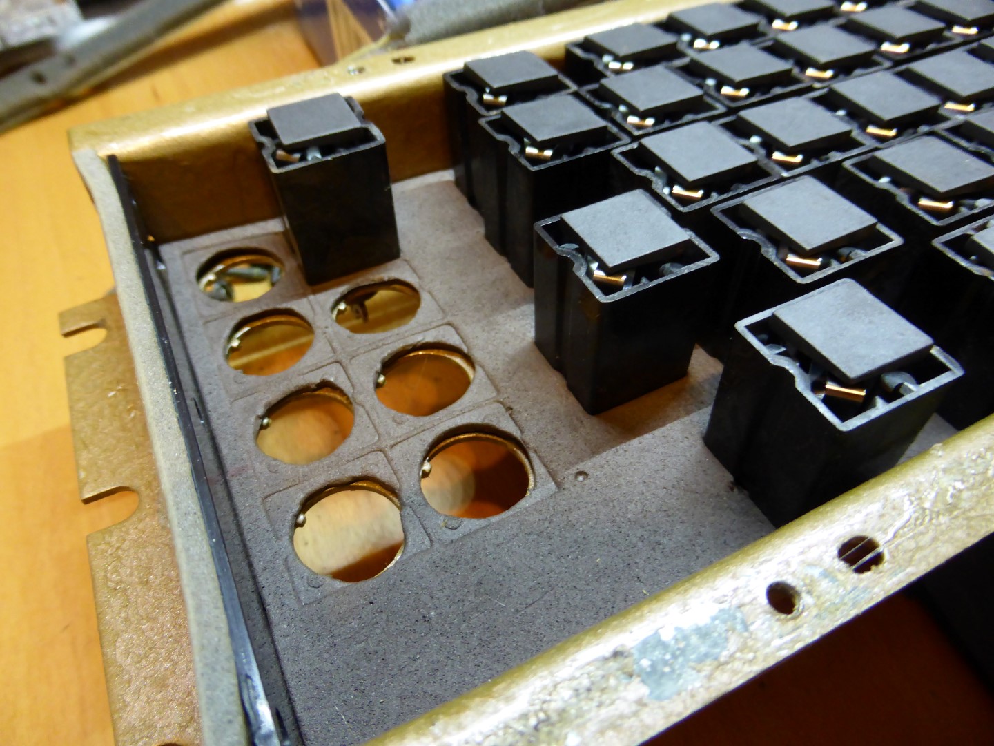

Posted: 25 Sep 2014, 02:09
by Halvar
Some more pictures from the rest of the restoration.
This was how the plate looked after disassembly:
Rusty plate with IBM foam
P1000843 (Large).JPG (406.9 KiB) Viewed 7578 times
Rusty plate upper side
P1000839 (Large).JPG (345.2 KiB) Viewed 7578 times
After an overnight bath in vinegar, the rust was completely gone. I painted the plate with a brown varnish. I would not do that again because a) it didn't turn out looking that great and b) the paint layer turned out to be too thick around the switch holes and I had to scrape it off partially to put the switches back in. Moreover, the paint didn't stick very well, seems like it would have needed sanding of the surface or a grounding.
I cut out the holes from 2 mm rubber foam that I got in an art supply store (where black was sold out ...). I basically just used the plate as a canvas to mark the holes and cut out round holes with a pair of nail scissors. Some of the holes in the picture turned out too small, so I had to do it a second time cutting with a larger diameter. The holes in the rubber foam that I used in the end had holes the size of a Eurocent coin (16 mm), which is a tiny bit larger than the holes in the plate.
As you can see by comparing with the picture above, my rubber foam is much thicker that the original IBM foam, and I would go for 1 mm or 1.5 mm thickness if I had to do it again. With 2 mm thickness I had to press the switches in with more force than I would have liked to apply on them.
rubber foam
rubber foam
P1000860 (Large).JPG (321.4 KiB) Viewed 7578 times
more switches in rubber foam
P1000863 (Large).JPG (338.78 KiB) Viewed 7578 times
PCB and switches before reassembly
IMG_20140816_182025 (Large).jpg (379.24 KiB) Viewed 7578 times
The PBC surface didn't look too great even after cleaning. It didn't become smooth like its back was, but stayed rough like someone had sanded it. It worked without a problem though. I also cleaned the surfaces of the fly plates from particles with a soft cloth, careful to not apply any pressure which would either send the fly plate flying quite literally (I did have to search for one under the table), or more often lat it get stuck in a way that I would have to take the whole switch out and unstick it.
After reassembling everything, plugging in the controller, finding the right threshold for the controller (147 for this board, see xwhatsit's controller thread for my post about that and my layout file), it now works very nicely and the key feel is great. I didn't bother yet to replace the contamination shield on this board.
Good luck to everyone who's still in the process!
Done!
Done!
IMG_20140921_111716 (Large).jpg (248.4 KiB) Viewed 7578 times
