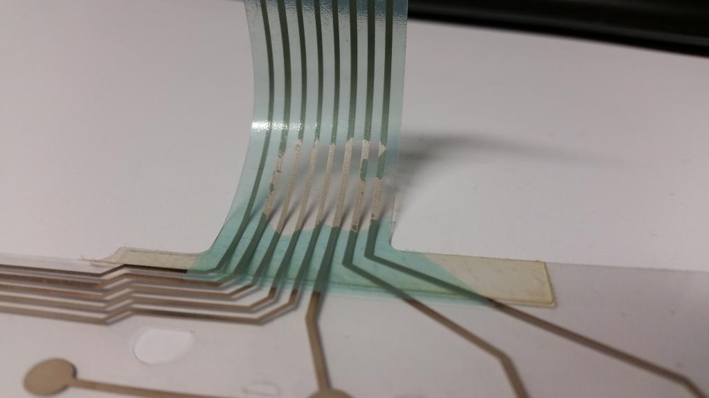

(nudged by idollar, I'm posting a recap of my experience here for reference)
One way or another, my model M got into the following state
The damage is in the most logical and unfortunate place - the apex of a ribbon cable fold. Luckily, only one trace was affected, and it affects only two CTRL keys. As I have CTRL and CAPS swapped I could have left it as is, but that would have been lazy :). Conductive ink would not help here, and I suspect neither would copper tape. Luckily, someone on geekhack already stumbled on the same problem - https://geekhack.org/index.php?topic=52 ... msg1165269 - and I deciced to follow suite.
In short, what I did is:
- I took a small strand of thin copper wire, around 20 mm in length. Mine was from a broken iphone charging cable, but any bare wire would do
- I cut a bit of the paper adhesive tape (the same one recommended to be used when taking out springs) - it is transparent enough so you can see the wire through it, but seems to me more durable. I made it little shorther than the wire, and I put the wire on it in such a way that a piece of wire was hanging over one side
- I then took a scalpel and gently scraped some 10mm on the controller side of the cut, on the "outer" side of the fold. You need to be really gentle here, as the plastic film is very thin and you just need to put the blade to the ribbon and apply no pressure at all while scrapping to get to the trace.
- I then placed the part of the tape with the dangling wire over the scraped part of the ribbon, and checked for continuity with the end of the ribbon cable. I didn't get it right the first time, so I scraped a bit more
- In the end I got it right. When scraping, check for color. Plastic gives the trace a green tint, but when the trace is exposed, it is more silvery.You will know you scraped too much if there is no silvery tone and you reached the plastic on the other side.
- I scraped on the other side of the cut, and since it was not easy to check for continuity, I relied on my eyes, and when I was confident I got to the trace I taped the wire on that side too
- I connected then ribbon cable to the controller, and then keyboard to the computer, and voila - CTRL goodness in all it's glory
- I then added another piece of tape to cover the dangling wire and add a bit more strength, closed the keyboard, and had no issues since *knocks on wood*
Hopefully this will help someone in the future. It may sound a bit complicated maybe, but if I managed to do it, then anyone else can as well 8-)

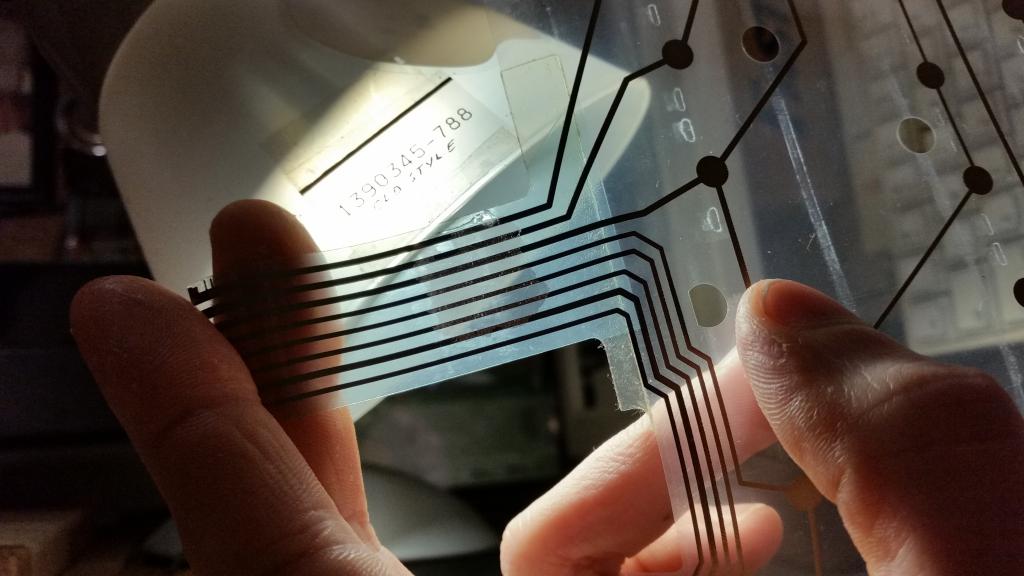

phosphorglow
15 Apr 2016, 01:22
So a silly idea popped into my head and I just had to try it.
Scratching away the conformal coating will work in a pinch, but invariably you wind up scratching away a bit of the silver trace as well.
Sooooo - what happens when you superglue a piece of mylar to the conformal coating, let it dry, and then peel it off?
Well, in my test piece I more or less ripped it off instead of gently peeling, but it left me with a patch of bare traces and very minimal removal of conductive ink. Just a few pits, but they all still have continuity.

I'll play around with it some more and perhaps even narrow it down to a few traces instead of a big patch. But it's promising.

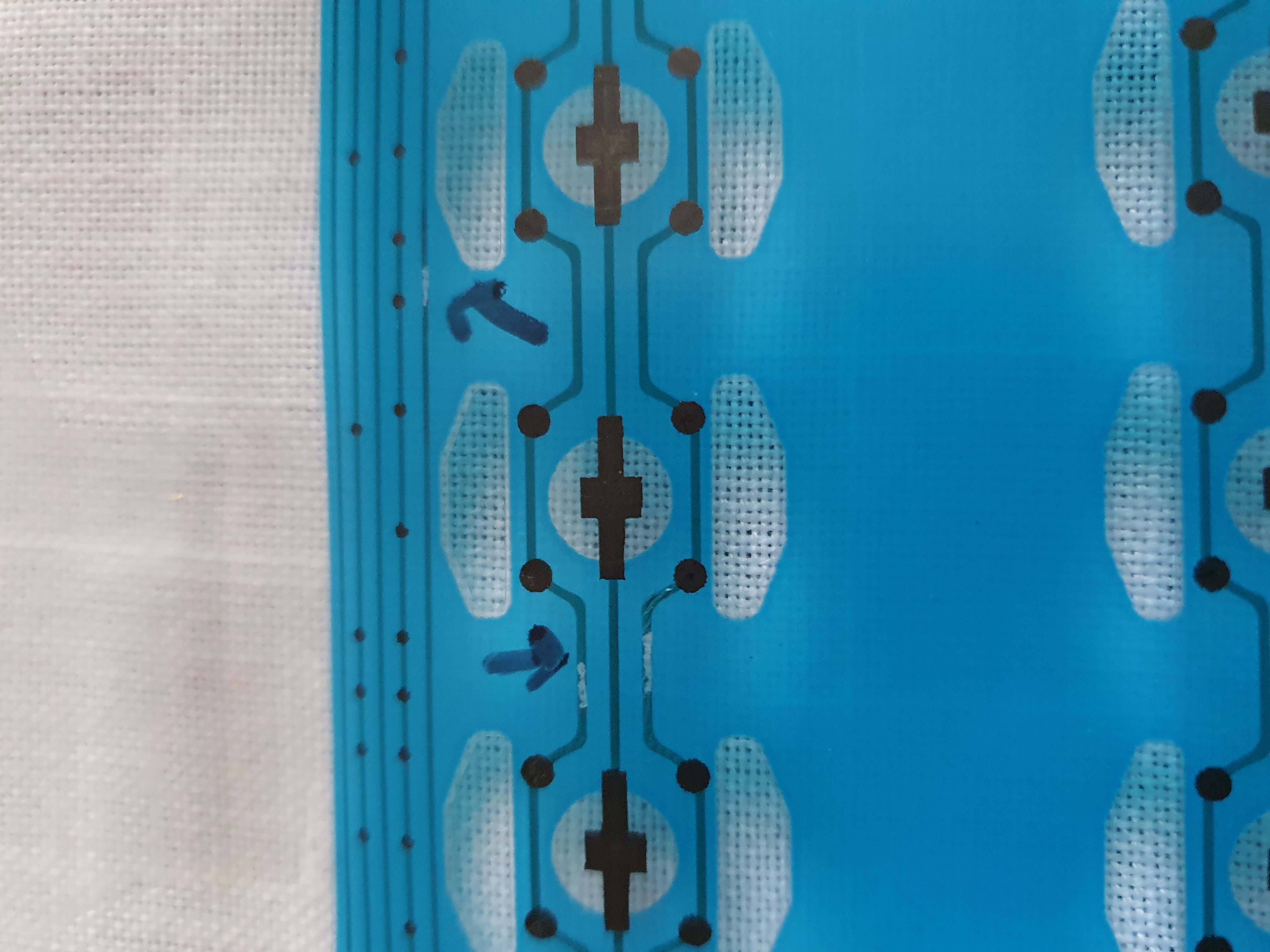

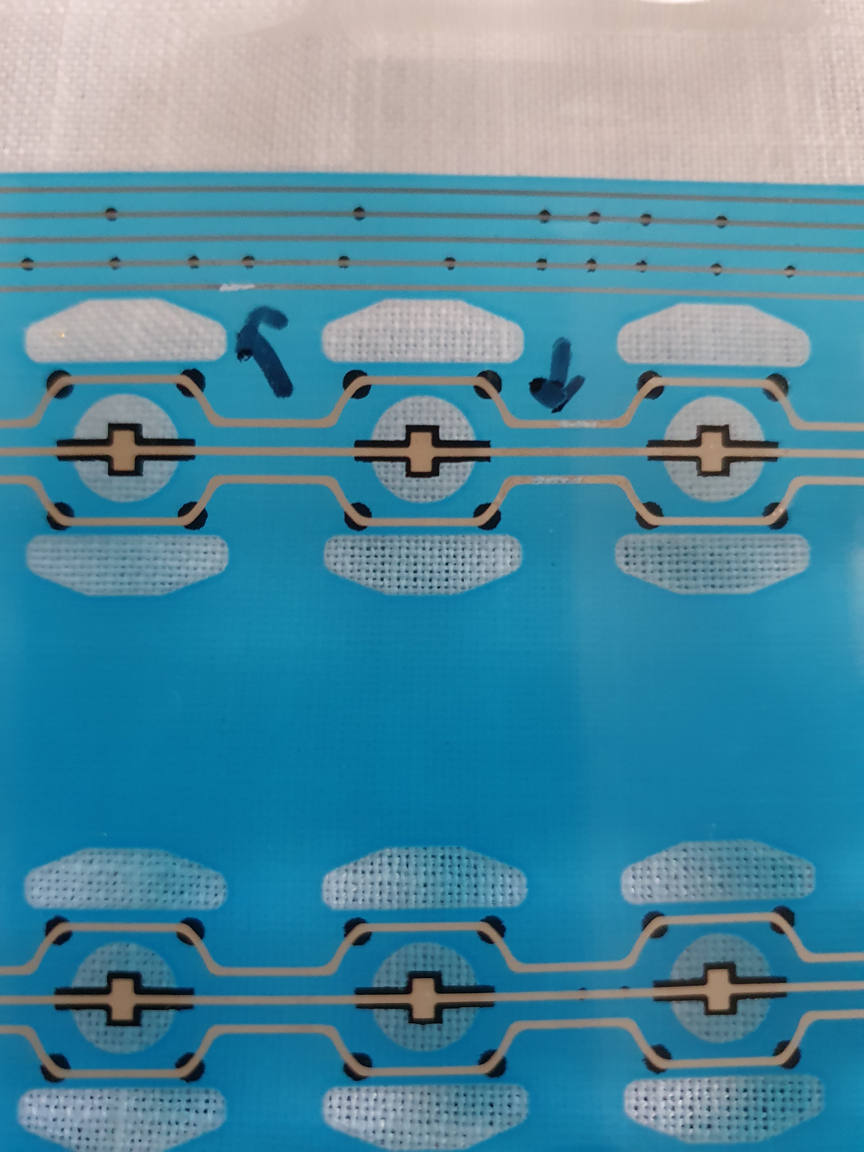

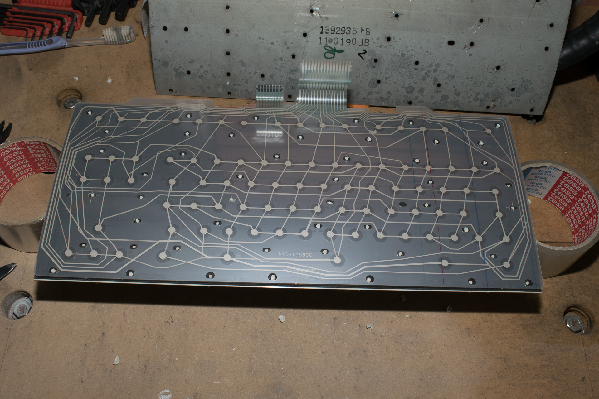

I don't feel like making a separate thread for this, so I'll just put it here. I screw modded my SSK last week, and I noticed that compared to usual membranes that I saw, it has an additional switch position. It's positioned between up arrow and end keys
It's visible on the left side, sorry for the noisy, flowery background :P
I looked around the web for screw/bolt-modded SSKs, and in one log a picture of the membrane is visible, and it has that same switch position. I wonder if it's an SSK thing, or if it's more related to date of production. In any case, it's quite weird, since as I would then expect switch positions to be present left and right of the up arrow key.
drevyek
24 Sep 2016, 00:48
I looked around the web for screw/bolt-modded SSKs, and in one log a picture of the membrane is visible, and it has that same switch position. I wonder if it's an SSK thing, or if it's more related to date of production. In any case, it's quite weird, since as I would then expect switch positions to be present left and right of the up arrow key.[/quote]
My Epsom Q203A with Fujitsu Peerless had the same pattern, with added contacts in the nav cluster. Not sure what the purpose is though- may be to allow for 5-key nav clusters?
chzel
24 Sep 2016, 14:26
I just searched my photos, and I have this photo of my second SSK from when I screw-modded it, and it doesn't have the extra switch location...So definitely not an SSK thing...

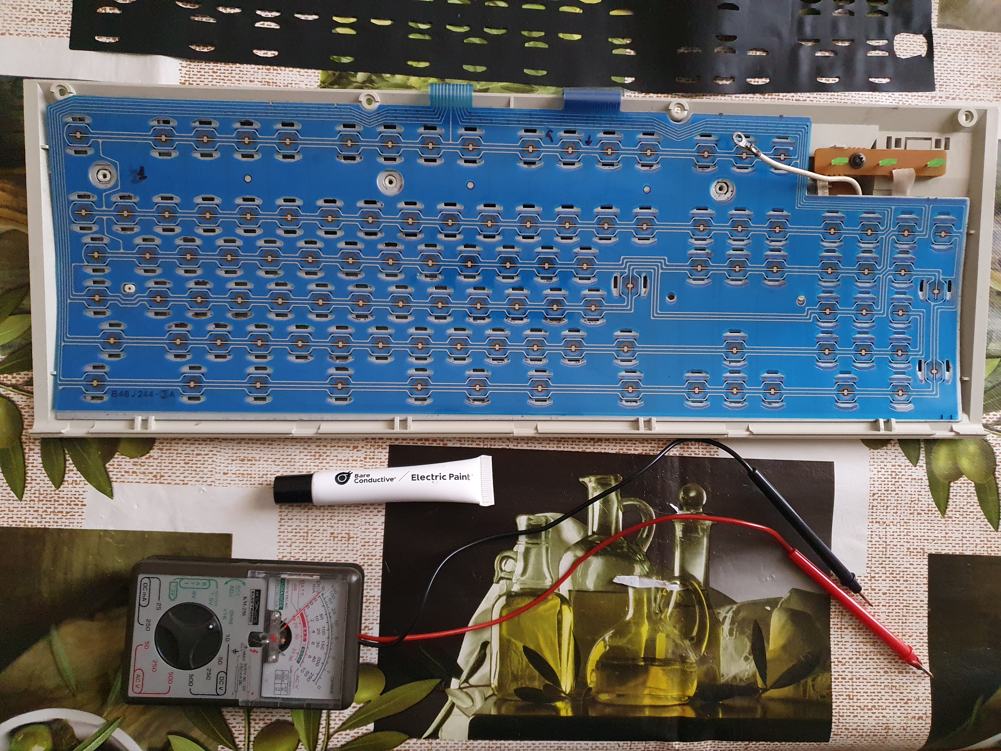

IBM 79F0167 JIS

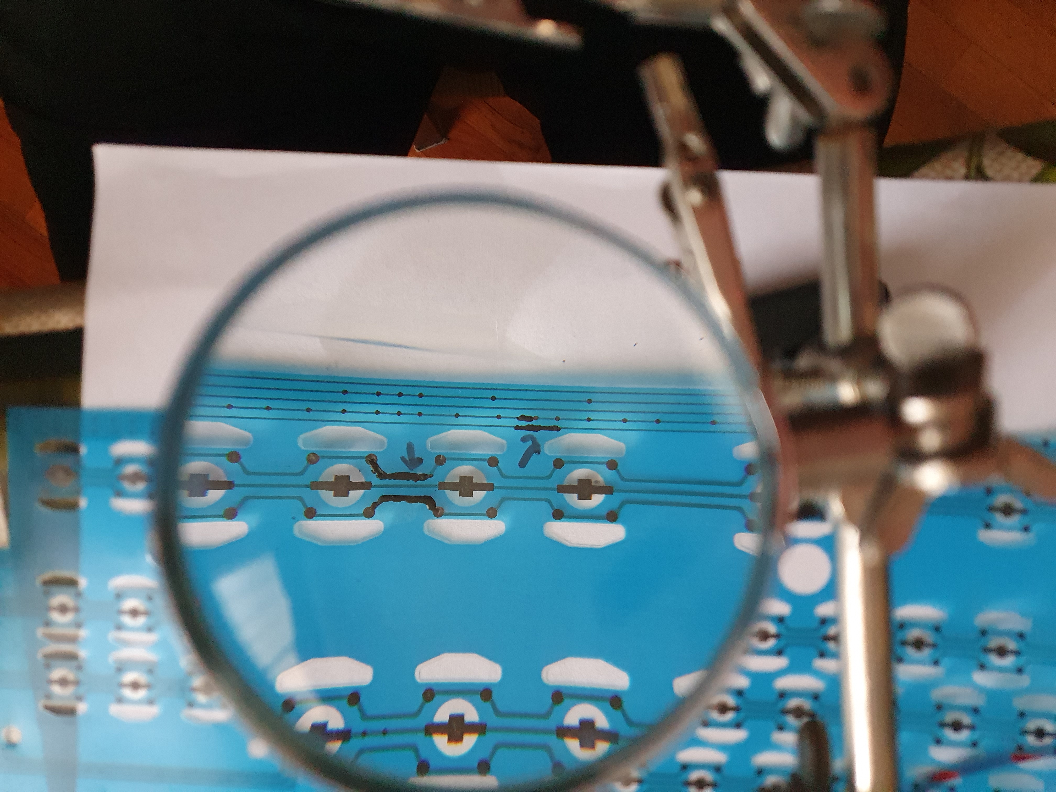

I have to thank i$ again this month for the second time. This i$ post inspired me to go on and investigate further about an issue I had on my new IBM 79F0167, which I acquired on buyee.jp a couple of weeks before Christmas and received in time to put it under the Xmas tree. I got it for a reasonable price since it was sold as defective. The first row keys didn't register (ESC, F1, etc.).
This IBM keyboard sports the unique Brother buckling springs and it can be considered a sort of hybrid Model M/F (here, there is my first thanks to i$) but with something more in my humble opinion. If you wanna have a closer look at IBM 79F0167, i may recommend Jacob Alexander's exhaustive photo album.
Instead, here follow some pics from my log about how to repair a JIS Brother BS membrane with electric paint in a minute and live happy.
