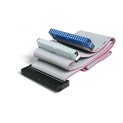

IDE hdd to motherboard cables are available in massive quantities from the recylers, for about $1 per pound. They will be used, but are usually in very good shape. Length will vary from a few inches to more than 12" though, so this might not be a good answer.
Posted: 08 Jul 2016, 21:57
by lot_lizard
elecplus wrote: IDE hdd to motherboard cables are available in massive quantities from the recylers, for about $1 per pound. They will be used, but are usually in very good shape. Length will vary from a few inches to more than 12" though, so this might not be a good answer.
Good to know. We could always shorten the cables if needed, and add our own connectors too. I haven't spent too much time looking, but assuming the header pins are female on the PCB/controller (opposite of what I think we would want), something like this could work as well male connector cable. We some searching though, we should be able to find the inverse (female cable connector with male headers), which would be ideal. All of this assumes that I$ thinks it makes sense. We want reliability first, and this capsense stuff gets tricky when you change path lengths

The 40-pin IDE cables with three female connectors are the ones we'll probably be able to find for a dime a dozen at recyclers. If 40-pin male IDE headers and these types of cables can be used, it would make assembly a snap for sure.
Posted: 08 Jul 2016, 22:16
by Techno Trousers
Actually cables like these might even be better than the recycled ones. Two connectors, and just 8" long, versus the 20-30" of the old IDE hard drive cables.
Posted: 08 Jul 2016, 23:03
by lot_lizard
Techno Trousers wrote: Actually cables like these might even be better than the recycled ones. Two connectors, and just 8" long, versus the 20-30" of the old IDE hard drive cables.
Cheap 30 pin variety with female connectors at ~75-100mm (3-4 inch) would be the goal. We will only need 30, and would be nice to not have 10 pins hanging off the side (standard IDE is 40). Appreciate the research. Something like I posted before is very close, but I believe the opposite of the connector we want. Female connectors on the cable would be the goal. Again... assuming I$ likes this approach. It might prove instable, and that is not ideal. Soldering also is not ideal in bulk, so we will wait and see his thoughts.

Digikey has these standard in 6" or 2" length; qty 250 for abt 88 cents each. http://www.digikey.com/product-search/e ... h-3006g-nd They can make them any length you want, any qty you want. 1 day lead time. The make them in house.
Posted: 09 Jul 2016, 01:15
by lot_lizard
elecplus wrote: Digikey has these standard in 6" or 2" length; qty 250 for abt 88 cents each. http://www.digikey.com/product-search/e ... h-3006g-nd They can make them any length you want, any qty you want. 1 day lead time. The make them in house.
That's the one... Price is nice as well. We'll see what I$ comes back with, but that is very promising
