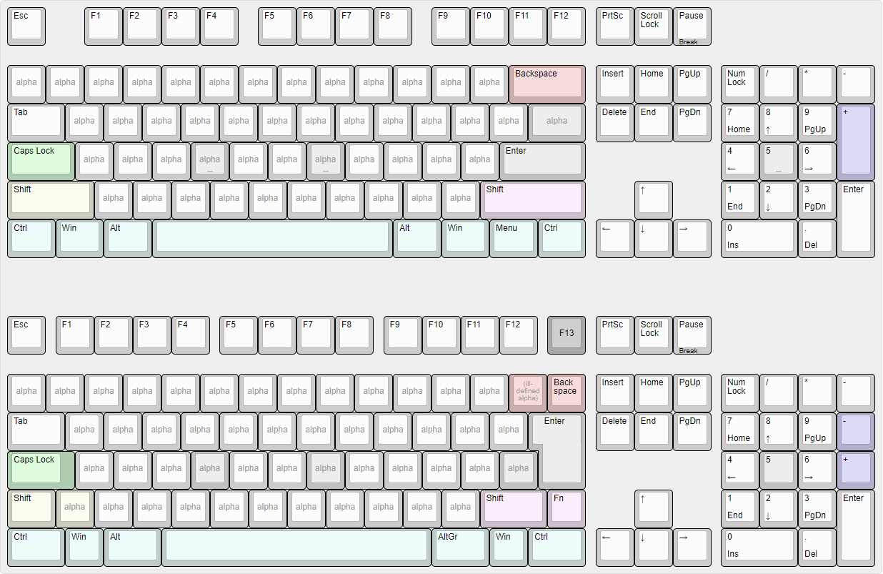

When it comes to typical MX-mount keycap sets, as they pertain to the full-size and tenkeyless form factors, very much all of the sets that are being produced nowadays fully support (with one exception, see below) the following variations in physical layout:
Universally or nigh-universally supported physical layout variations on modern MX-mount keycap sets.
In no particular order:
  1. Non-stepped Caps Lock OR stepped Caps Lock (the switch position underneath changes, so this needs to be taken into account!)
  2. 2.25U left Shift (ANSI, ANSISO) OR 1.25U left shift and 1.0U alpha (ISO, ISANSI).
  3. 2.75U right Shift OR 1.75U right Shift and 1.0U Fn ("HHKB-style" or "right-side Split"; "left-side split", as used in ABNT and JIS keyboards, is almost entirely unsupported).
  4. 2.25U horizontal Enter and 1.5U alpha above (ANSI, ISANSI) OR vertical 1.25/1.5U Enter and 1.0U to its left (ISO, ANSISO).
  5. "Modern" (1.25U×3 / 6.25U / 1.25U×4) OR "tsangan" or "winkeyless" (1.5/1.0/1.5U / 7U / 1.5/1.0/1.5U) bottom row.
  6. 2.0U Backspace OR two 1.0U keys (the right side one should be Backspace in this case).
  7. Homing OR non-homing F, J and numpad-5 keys (this does NOT affect the switch underneath).
  8. 2.0U numpad+ OR two 1.0U keys in its place.
  9. Normal function row OR the same plus an "F13" key crammed in (this one has decent support, but hasn't become "universal" yet).
Quite few sets will provide for one or two extra "macro" columns to the left of the main alpha block (typically M1..M5 or M1..M10, instead of the proper and good EF1..EF10). Exceedingly few sets will provide the F13..F24 keys (okay, F14..F24). BAE (not pictured) is barely supported, and if it's present, it's for plain BAE instead of Focus-BAE. TIE Enter (not pictured) is very poorly supported.
I'm skipping over 60%, 65%, 75% and other form factors, for the obvious reason.
So, given that Ellipse's stated objective is to mount MX-style keycaps on the beamspring switches, the known limitations in current custom sets should be taken into account.
What would I want? Within the given restrictions, for me ISO support is a must; "tsangan" bottom row is highly desirable, right-split Shift and split numpad+ are desirable; F13 and split Backspace I don't care for; stepped or non-stepped Caps Lock... can be decided by flipping a coin.

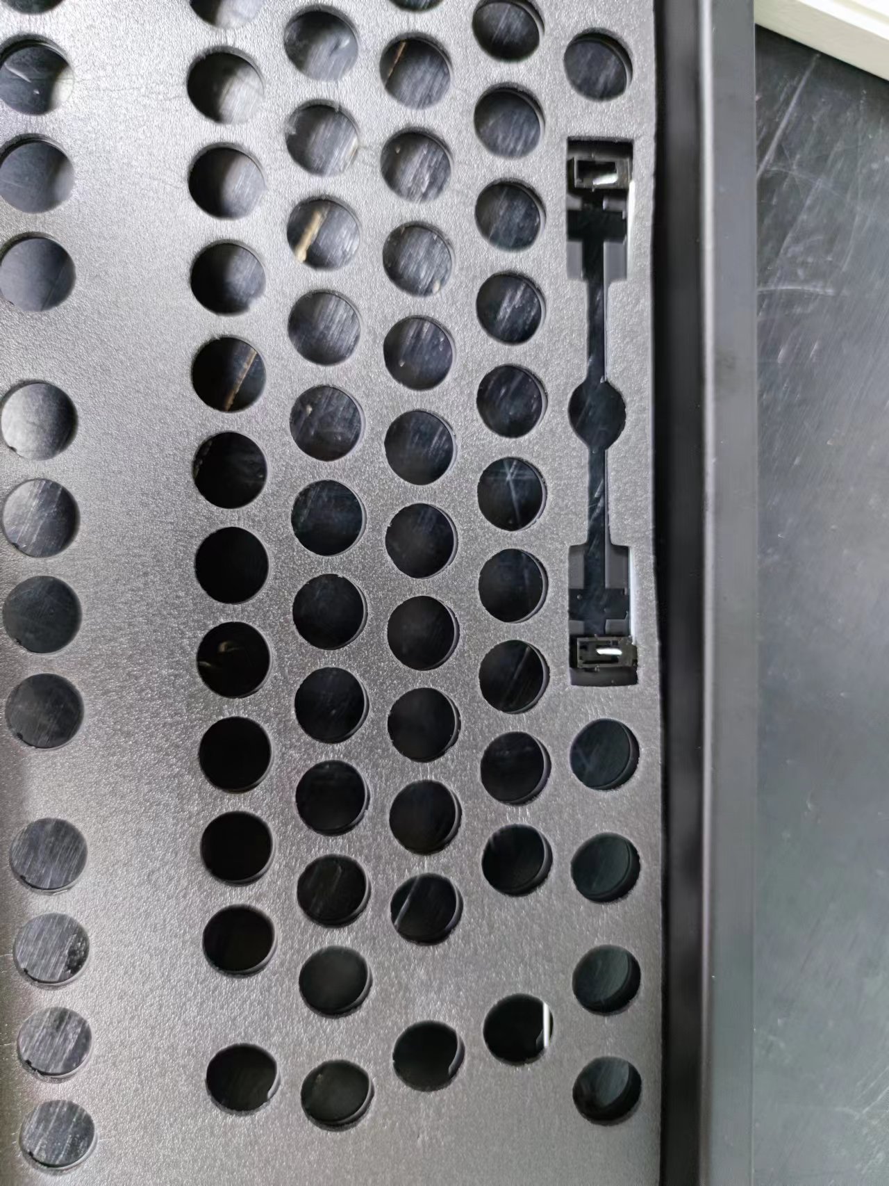

We are about 4-8 weeks away from me mailing out the remaining Model F keyboards in the backlog! A little over 500 keyboards plus many non-keyboard orders.
Here are the first photos of the prototype beam case and the top and bottom inner assembly plates. They will be making a full prototype with these parts before we proceed. As noted before this is just a test to make sure everything will fit together and work together. The design is likely to change (an angle to the case was added but not for this sample, etc.) and I'm not sure yet if I'm making molds for a few beam cases so you can pick a 3278 style beam spring for yourself or a 3101, etc. Each case style will also have different layout options ideally so there may be a 104 style and a less wide SSK style case.
These are just powdercoated smooth black for the tests as opposed to the bumpy original style texture expected on the finished products.

The third photo shows the new prototype foam installed inside the top inner assembly. The purpose of the foam is to reduce the reverberation sound and make it sound closer to the originals.

Those look absolutely gorgeous!
