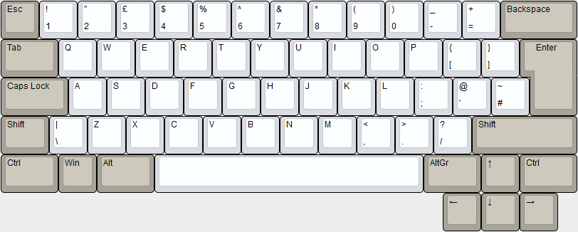

Maybe its a little late for suggestions, but how about something like this:
Shifted Arrows
Shifted Arrows
This way its not as wide as with integrated arrow keys and you could easily use some old Alps keycaps with it. Its not exactly easy to find a 1.75u Shift key for Alps. I would like it for Cherry MX, too.

I don't like the long row of unused space though
Broadmonkey
Fancy Rank
22 Feb 2014, 20:39
Plus it's not very comfortable to reach for the arrows that far down.

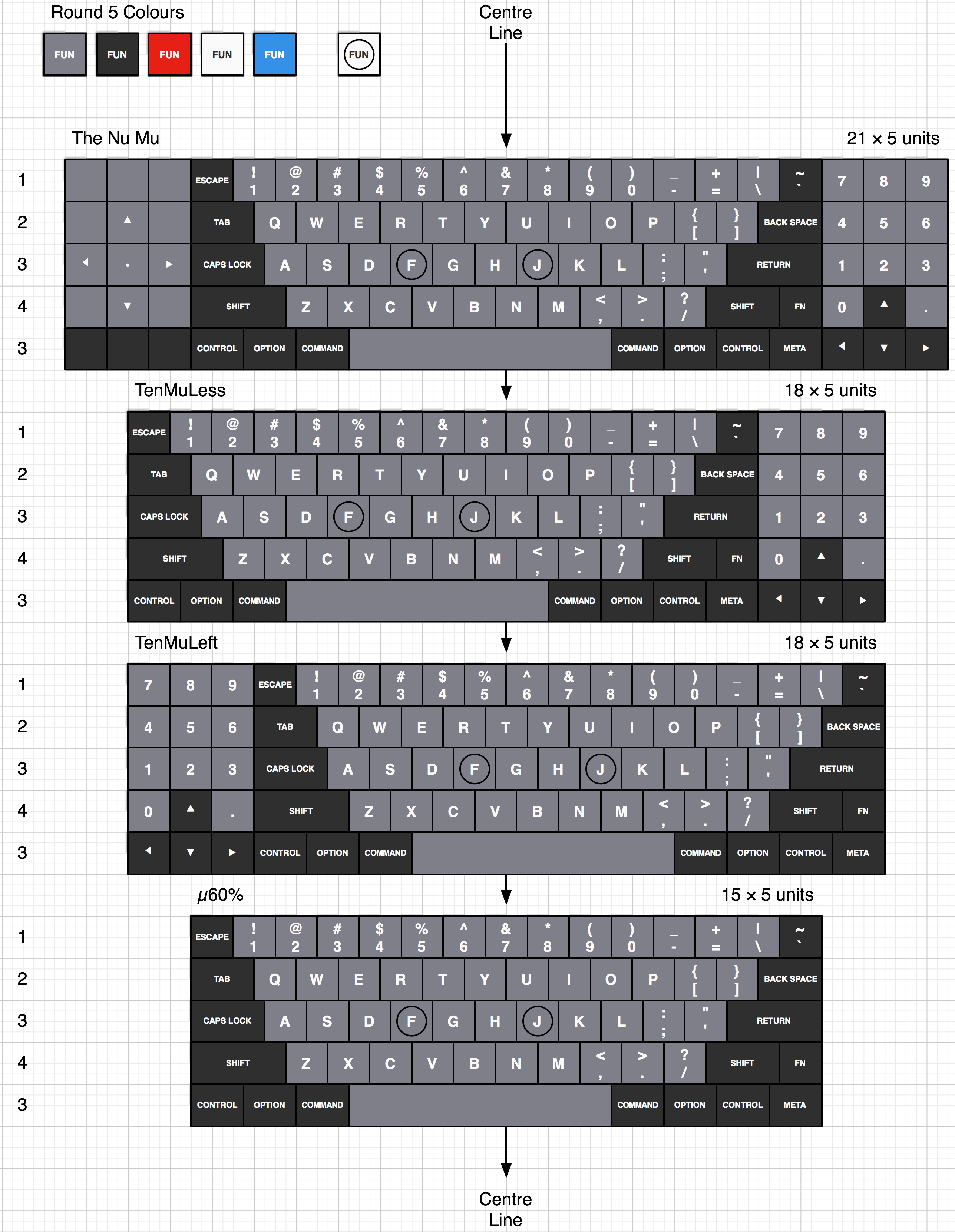

I like the look of a 40%, too, but the asymmetry puts me off. Thinking of which: here's a chart of the designs I've proposed so far, all lined up so you can see where their home rows are.
The Family Mu.png (820.27 KiB) Viewed 6056 times
The classic TKL is an inherently asymmetric beast. Not as bad as a traditional full size keyboard, but now I can see why I'm shuffling my SSK and Ducky sidewards. Trouble is, it's actually quite a challenge to lay out a keyboard with home row plumb in the middle. Adding spacing between the functional islands only makes things worse.
-[°_°]-
23 Feb 2014, 12:06
I don't really share the love for symmetry, but I like all your designs Muir. Maybe the first one is a bit too much though.
What do you think of adding a 0.25 gap between the main board and the side pads?
The 60% is a little out of standard, it might be a problem to source the backspace in future GBs

PS: if you like symmetry... why not something like this
23 Feb 2014, 13:41
You turned off your unit markings. I can't quite see what you did there.
Actually, what I really need to do is design with a smaller space bar again. I will have a few! And maybe think 40-60%.
-[°_°]-
23 Feb 2014, 13:43
I just redistributed 0.50u among 10 keys (increasing the gap between keys slightly). I doubt you can actually tell the difference.

More symmetry:
-[°_°]-
23 Feb 2014, 14:29
I might end up doing the mirror layout...

What is the mirror layout?
-[°_°]-
23 Feb 2014, 19:16
madhias wrote:What is the mirror layout?
olive
23 Feb 2014, 19:54
How about this minor change in the mirror layout, which I quite like by the way: put the ~/` key between Esc and 1.
I realise it's not a big deal if a Teensy pilots the keyboard anyway :-)
