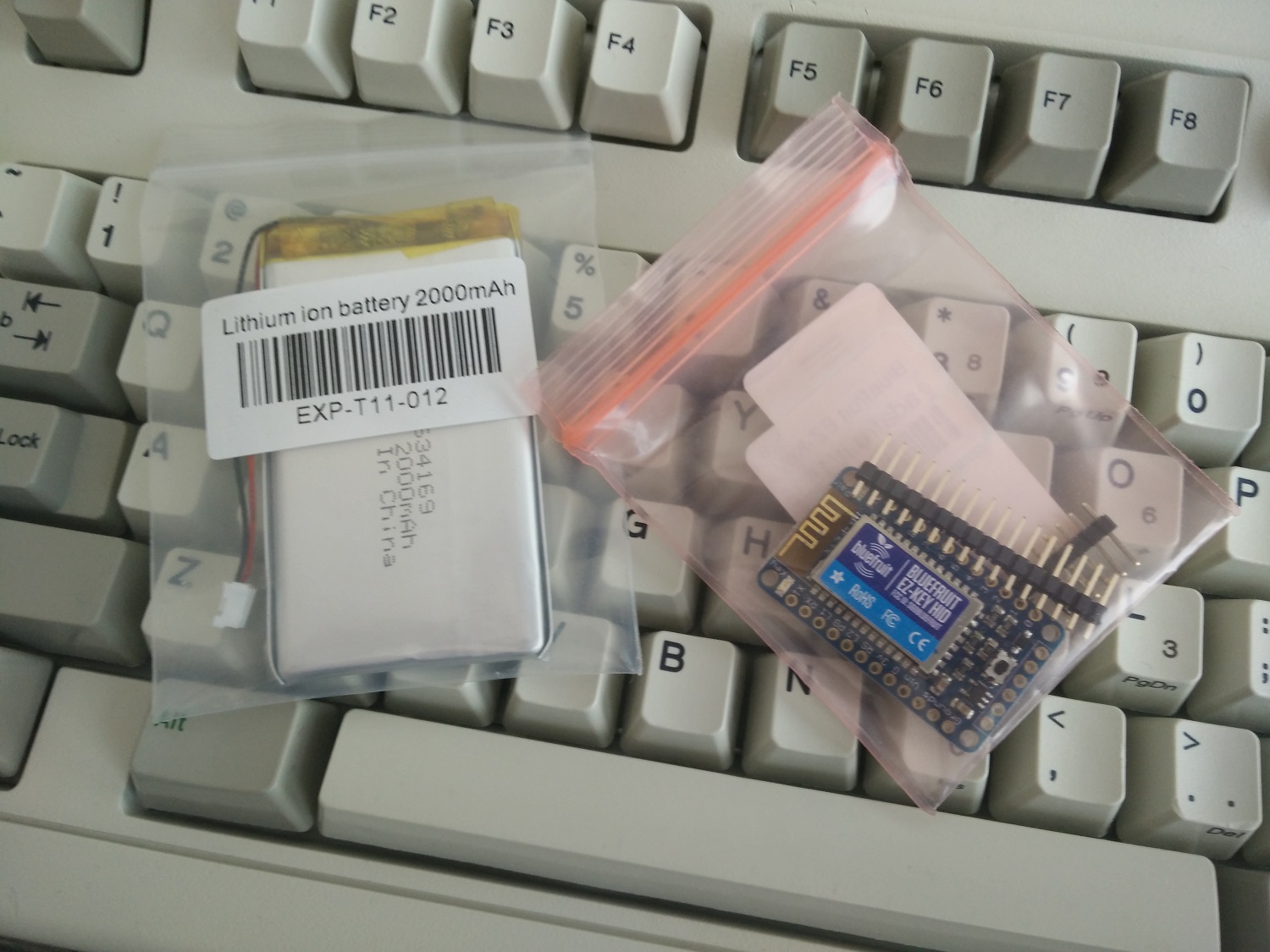

Got all the parts except the actual controller.

you call that a battery ?
THIS is a battery
http://www.batteryspace.com/polymerli-i ... 59156.aspx

phosphorglow wrote: It's the 1200mAh battery. Adafruit was out of the bigger one, but I looked at the dimensions and it was too big to fit in a SSK. This one fits nice and snug!
Now that I read the quote again, I hope I can somehow manage to put my 2000mAh battery inside the SSK. :?
Need more battery life! :geek:
29 Jul 2015, 16:48
Probably not a problem. An extender cable ought to do the trick. There's plenty of room in the SSK, if a bit further away from Phosphor's controller.
