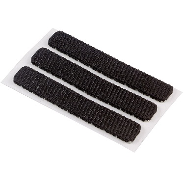

bocahgundul wrote: I want to ask a question, where do you put the anti shock tape for the spacebar hypersphere? like you said in updated topre silencing in GH. I'm interested to make the spacebar more quieter and what tape did you use. Thank you
I use something similar to this:
Available on Amazon:
http://www.amazon.com/Shepherd-Hardware ... 2802967011
I get mine at a local Carpenter Brothers' hardware store. They are called "Do-It" foam strips. They look like the anti-skid strips that are used on the bottoms of keyboards.
I cut small squares about 6 mm per edge and stack them until they are high enough to make contact with the underside braces on the spacebar when it is pressed down. I put these on each side of the central spacebar switch.
On the HHKB, I put just one of these squares on top of the circular spacebar shock absorbers that are already there:
