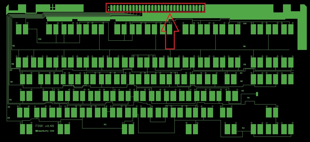

Some progress with the PCBs ...
The producer approved the PCB design. We can order !.
I had to made some modifications to ensure that the connector was seen as a PAD buy the manufacturer. I also added a silk layer to the top with the key distribution (rows and columns).

Status update of the order with pbcway.com
1.- The service is impressive. There is a person following the order that I can email ! It is always the same person so there is no need to explain again an again the history. It is the first time that I see such a good service.
2.- They have questioned the designed in a number of places:
  • 2a - the PADs where the controller will go were not marked as PADs in the Gerber file. The reason for this is rooted in the import process from the generic CAD tool (Deltacad) in the PBC tool (Diptrace). During the import, one can state if the import shall be done as "traces" of "pads". I used traces so our PAD was marked as trace and therefore would have been covered by the green isolation layer.
    PAD location explanation.jpg (155.32 KiB) Viewed 9369 times
    This has been resolved in a version 0.49 that I have sent them. I separated the PAD components in a different Deltacad layer that I imported separately into Diptrace. They confirmed that this trick did the job.
    2b.- the have also questioned all the PCB areas that are not connected anywhere.
    I have sent this explanation (included the typos):
    PADS explanation.jpg (95.67 KiB) Viewed 9369 times
    Hello,
    I know that is strange.
    The PCB is kind of tricky.
    SHORT VERSION
    I think that it is correct in the version 0.49. Please confirm that you will use the version 0.49.
    The PADS are isolated from the rest.
    The complete PCB shall be covered by isolation layer but for the connector that I have sent you (and I send again)
    LONG VERSION
    As I said, it is not a normal one. It is used to create capacitors between the rectangles on the upper and bottom layers. There are areas that are not connected. They are just sitting there, to act as capacitors.
    The PCB will be used to sense key presses of a keyboard.
    In any case (attached an image that explains also), each key is a pair of two PADs on the top layer (rows) and one on the bottom (columns).
    In the top layer, one (BIGGEST) of the two pads is disconnected. Isolated
    The other (SMALLER) is connected to the sensing row.
    On the bottom layer, the BIGGEST pad matches the disconnected one on the top layer.
    The complete PCB shall be covered with isolation but for the PADS on the connector that I have already sent you and I send again.
    Hopefully this clarifies.
    Please confirm that the version 0.49 will be used !!!
    Cheers
I have been told that an engineer with review the new version and the comments tomorrow.

Thanks for posting your explanation to their support. That actually helped me to understand how the capsense PCBs work (I've never dug into the science behind it--I just know I love their typing feel). :D

Yes, I was happy with the XTant boards that PCBWay printed for me. Delivery was quick too.
Sorry, I should have given you a heads-up about needing a mask layer if you create your pads in DeltaCAD. I usually create the through/surface pads in Diptrace - the mask is created automatically there.

chzel have told me that we miss a hole in the latest version. It got probably deleted by mistake with the latest changes. It has been tricky.
I have emailed pcbway to tell them about it.
The issue is not major: if they cannot change the order we can drill the hole manually or leave the screw out.
It will be good to have the hole in the prototype anyhow.
We will see ...

It seems that PCBway will use the version 0.50, which means that the missing hole will not be missing ;-)

Status update:
Date: 11 January 2016 at 08:39:05 GMT+1
Hi dear,
Sorry for the late reply.
I've sent version 0.51 to our engineer and mentioned the pads in the rectangle.
I think it is ok now.
Thank you for your efforts!
