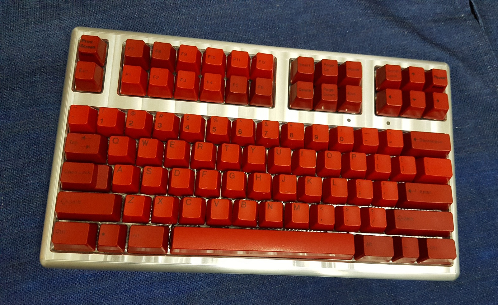

This has got CommonSense. Works wonderfully. Thanks!
Posted: 08 Oct 2018, 14:43
by njm
I just finished wiring this up and reassembled the keyboard. After a bit of tweaking the hardware parameters in FlightController it's all working perfectly!
I misread the wiring instructions initially, and thought that I had to wire up the last 23 columns (as opposed to the first 23). Luckily figured this out after wiring up only a few columns. Other than that, it went really well. My wiring is not the neatest, but seems to have done the job :)
Thanks DMA!
Posted: 08 Oct 2018, 18:05
by Sangdrax
The old way used to be that you wired them in reverse order but the firmware was updated where that's fixed now. I don't think the readme had been updated though. DMA adds so much cool stuff, I bet it's hard to keep up on all the documentation. Even now, he's been working on some really interesting controller stuff for magvalves that should be a pretty big gamechanger.
Board looks great though. How you liking it?
Posted: 09 Oct 2018, 00:10
by njm
Thanks Sandrax. Great work on your 3178 by the way. I think it was your post that gave me the idea to use CommonSense. I was was previously thinking of using an xwhatsit, but wasn't sure if it could be configured to handle 23 columns.
I think I might need to adjust my wiring a bit, as I'm finding it hard to close the case (there's not as much vertical space in there as I thought). I really like the board though, it has a nice feel to it, and it seems like the layout has potential. Interestingly the blank keycaps are not pressable, so I might swap out the one in the top left at least, for a working tilde key.
