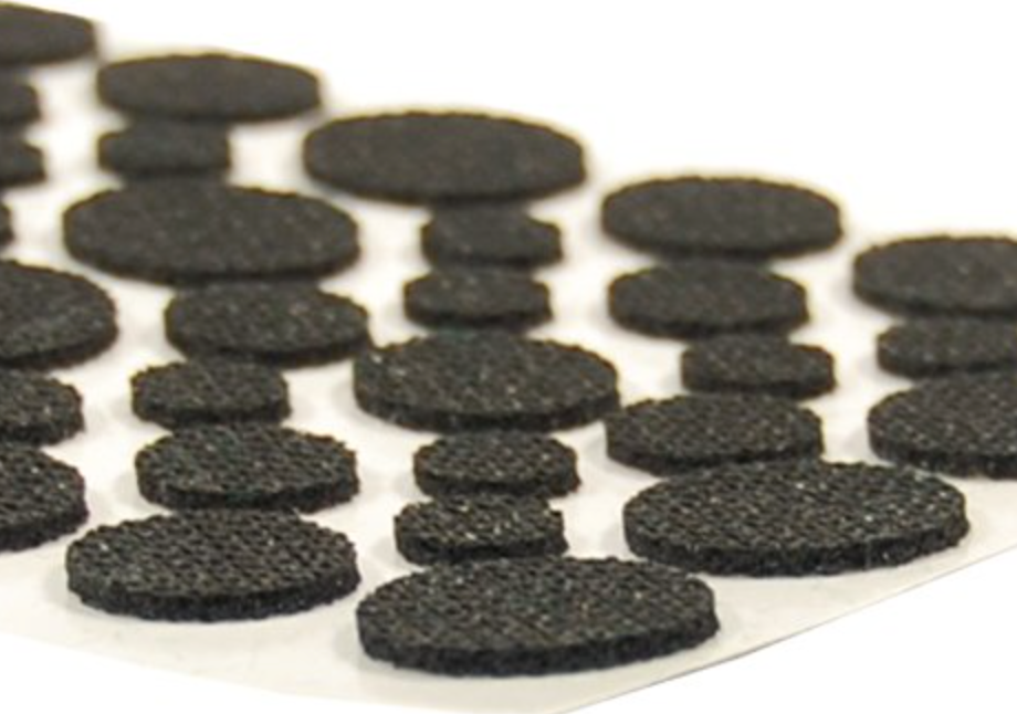

I just tried this (Hypersphere's) little spacebar mod, and I have to say there’s a massive difference. It’s elevated the spacebar to my favorite sounding key, where before it was the noisiest by a large margin. I didn’t even really know I was keeping score—there was just the faint feeling of dissatisfaction with something, and when I focused on listening, it was clearly the spacebar. Guess it wasn't much of a mystery; I was probably just ignoring it.
I had some anti-skid dots that are about the same diameter as the HHKB spacebar pads (on the “plate”). Mine are just a touch too thick causing me to strike the spacebar with a more force than the other keys (which leads to bottoming out a little harder on the other keys). I don't have a caliper for measuring thickness but I'd guess mine are about 1.2mm thick.
Maybe it will break in and become “just right,” but I wish all my keys sounded this throaty.
These are the pads I'm using. Something slightly thinner would probably be ideal, and you're probably better off purchasing these at a brick and mortar store than from Amazon but here's a link just the same.
[img]
[/img]
http://www.amazon.com/Light-Duty-Slip-R ... K5EB5QQZBQ

Thanks for being specific! The PBT spacebar on my HHKB is simultaneously my most and least favourite key. Must look into this fix too.

I left an external hard drive resting on my HHKB modded spacebar overnight hoping the weight might compress the self-adhesive dots I added on my spacebar landing pads. It didn’t help, and the reduced travel is still noticeable (and annoying) so I tried something different.
I used athletic self grip tape. It’s only about 1/4th the thickness of the adhesive dots, and the waffle texture seems to mute the sound of the descending strokes nearly as well as the dots. Still have the slightly annoying ascending stroke noise but this is a better compromise of feel and sound.
http://www.amazon.com/SelfGrip-Maximum- ... +grip+tape

Here is what I use:
1/2 x 2 3/8 inch foam strips:
http://www.neweggbusiness.com/product/p ... 003z-00069
These are $1.29 from Newegg Business for a pack of 6 strips. I get mine from a local hardware store. They are not as textured as they appear in the photo. I cut them into 1/2-inch squares and stack them as might be needed to provide the desired distance for absorbing the impact from the spacebar. On a HHKB, I apply them over the built-in shock absorbers. On a RF87U or NT, I apply them in layers as needed on the top of the plate equally spaced on each side of the central spacebar switch.

These foam strips, where did you stick them?

@seaworthy: Thanks for posting the annotated pic. This should eliminate any doubts about where to put shock-absorbing pads for the HHKB Pro 2 spacebar.
Likewise, for those who would like to do a similar ultra-simple mod for their RF87U or Novatouch keyboards, these do not have built-in shock absorber platforms like the HHKB Pro 2 has, but you would place the self-adhesive foam squares or circles in the same relative positions.

Man, I should have asked for some of that stuff from you along with the rings! What physical store did you buy them in? The shipping is more than 200% of their price here in California.

Hypersphere wrote: @seaworthy: Thanks for posting the annotated pic. This should eliminate any doubts about where to put shock-absorbing pads for the HHKB Pro 2 spacebar.
any idea how thick the shock pads (expecially for the novatouch) should be?
Also has anyone made any silencing adjustments to the (novatouch) case itself - in a german forum someone placed a bitumen mat inide the case at the bottom.

Muirium wrote: Man, I should have asked for some of that stuff from you along with the rings! What physical store did you buy them in? The shipping is more than 200% of their price here in California.
The price seems to vary quite a lot. Only today did I find the Newegg Business price, which is the lowest I have seen. I got mine at a Carpenter Brothers hardware store, where the foam strips are sold under their "Do-it" brand. I paid around $4.00. I have also seen them on eBay and Amazon at various prices, I think in the range of $4.00 - $6.00 or so.

Has any one tried this one?
http://www.amazon.com/Shepherd-Hardware ... B00004YOHX
It is actually cheaper than the newegg one (considering shipping charge) and has been cut.

suhaibin wrote: Has any one tried this one?
I have pack of the Shepherd Hardware anti-skid pads #9970 (38mm) that I purchased a while back. They look identical to a new pack of Everbilt pads I picked up this weekend from Home Depot. I found the price to be the same regardless of pad diameter, and since you're going to be cutting them up go big.
