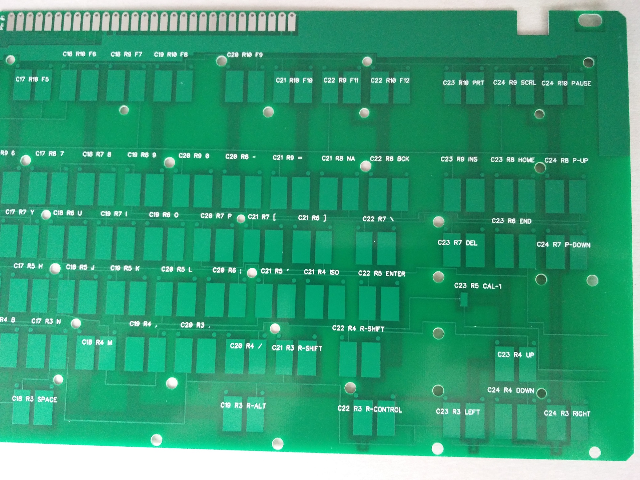

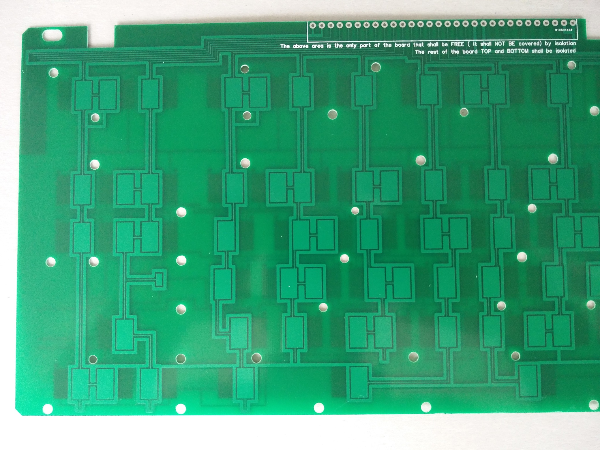

Posted: 20 Jan 2016, 19:59
by idollar
Steveenn wrote: ...March definitely isn't too much of a wait, sounds great!
The PCB have arrived :-)
Forgive me for the bad quality of the pictures, made with a telephone and sent to me. I was not at home today.
The version that they have used is the 0.51, the final and hopefully good one that I asked them to use. My fear was that with all the email exchanges that we had they would have used a different one.
It even has my instructions on how to set the pads printed in the bottom layer, including typos :-)
The holes are big, hopefully sufficient to cope with errors in the design.
I could not spot any error.
I will not have time to post better pictures until the week-end.
