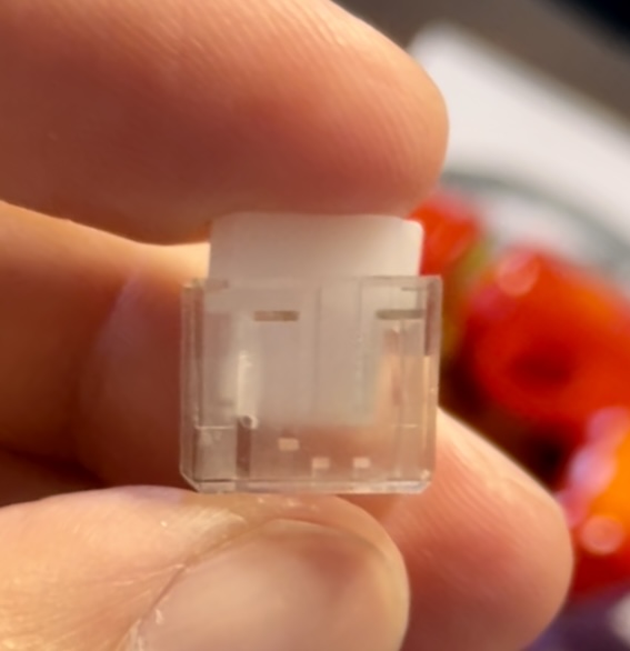

Sorry for the confusing post! The Matias slider was on the right side. I presumed the switches were alps because they looked, sounded and felt like genuine pine alps.
That keyboard is a Datadesk Mac 101-E. Below are some more pictures for reference. This was an eBay find with one picture that looked rough/dirty. Turns out it was perfectly preserved with two covers and the outside cover was dirty. Inside appeared NOS. The inner cover was a membrane plastic molded to the keyboard to cover the whole thing.
The stem on the left control key broke off and I wanted to see if Matias parts could be used as replacements for alps. I learned:
  • Alps sliders are bigger than Matias and won’t fit in Matias top housing
  • Matias sliders fit in alps top housings but are more wobbly but feel the same
  • Matias housings can’t be used with pine alps due to the smaller simplified switch plate
Genuine alps does not fit in Matias housing:
Hope this helps! If there’s anything else I can provide just let me know.
Thank you, that's great information on the mystery switches. They do indeed sound and feel like early Alps SKCM. I'm really hoping we learn the truth about these. I have four or five Datacomp keyboards with them, and there are other examples posted here in various places.
We need to compare the dimensions to genuine branded Alps switches to see if the parts interchange. That would help to confirm whether these switches were built using older Alps tooling, rather than being clones. I think someone suggested that Forward might have made these. Datacomp is another possibility, especially considering they have been found in Datacomp keyboards.
