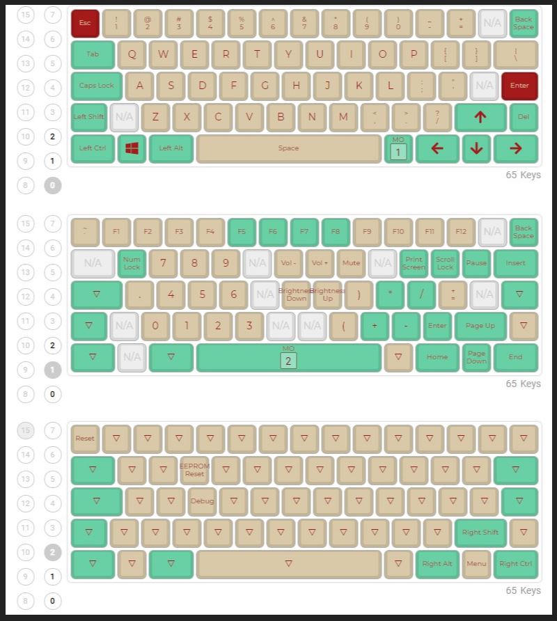

daijoubu
18 May 2020, 14:28
Just to share a layout I've made with the QMK.
My current layout is with 2 extra keys coming from split space bar + split right shift
qmk layout.JPG (109.29 KiB) Viewed 10398 times

tentator
18 May 2020, 23:24
Well the Screenshot above comes from the one pandrei is currently running yeah... Works great ;)

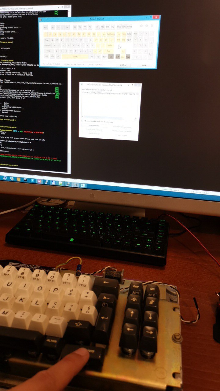

tentator
20 May 2020, 02:47
..tonight is QMK-on-Beamspring testing night!
I'm writing this for the first time for humankind on a 3278 with QMK on board! :D
Will post results tomorrow..
