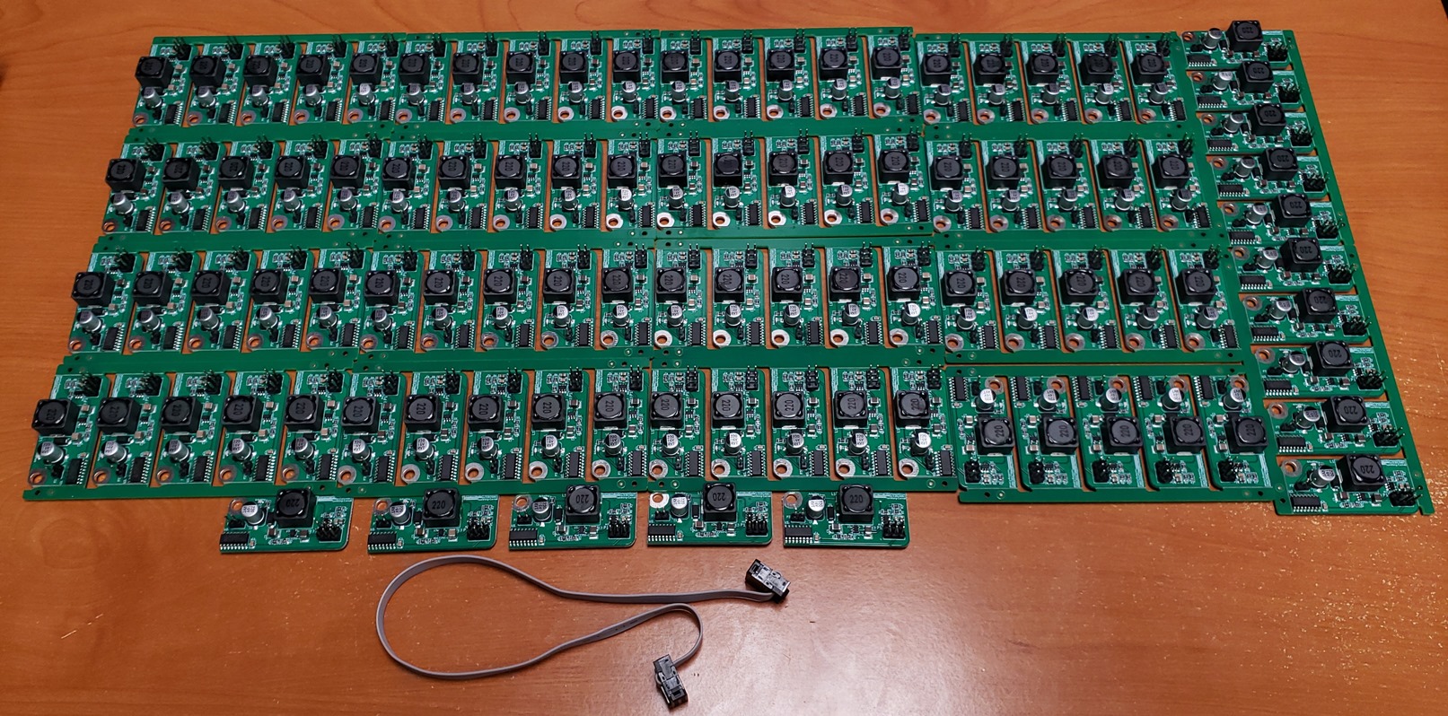

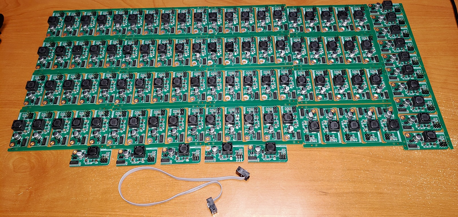

Admiral: the solenoid and solenoid driver are not included with anything so it would be a separate order.
Regarding the solenoid drivers, I have already sold out nearly half the whole quantity I ordered, in just the past couple weeks! They should be here by DHL Express in the coming week or so. If anyone wanted the solenoid drivers to ship ASAP (without waiting for beam spring controllers or the solenoids themselves) please let me know. The beam controllers should be shipping in about a month and the solenoids in about 2 months.

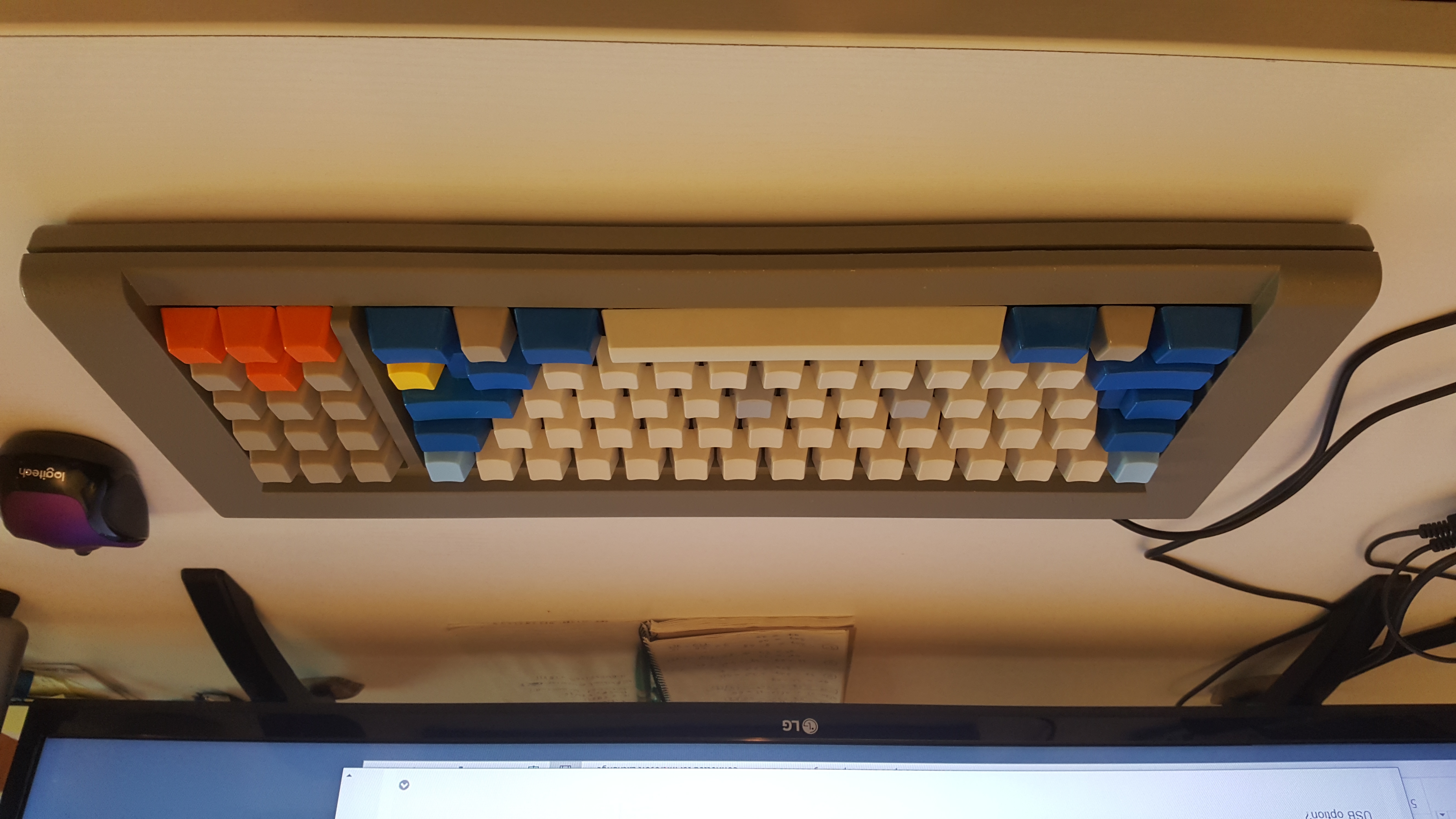

I had to have a "golden" key ;)   Like some of the old DEC terminals.
Today I got my industrial grey F-77. I also ordered blank keycaps from Unicomp
so that I can use it while waiting for the subed caps from Ellipse.
I could not possible wait to get dental floss: I just had to put the keycaps on
and try it out.
First impressions:

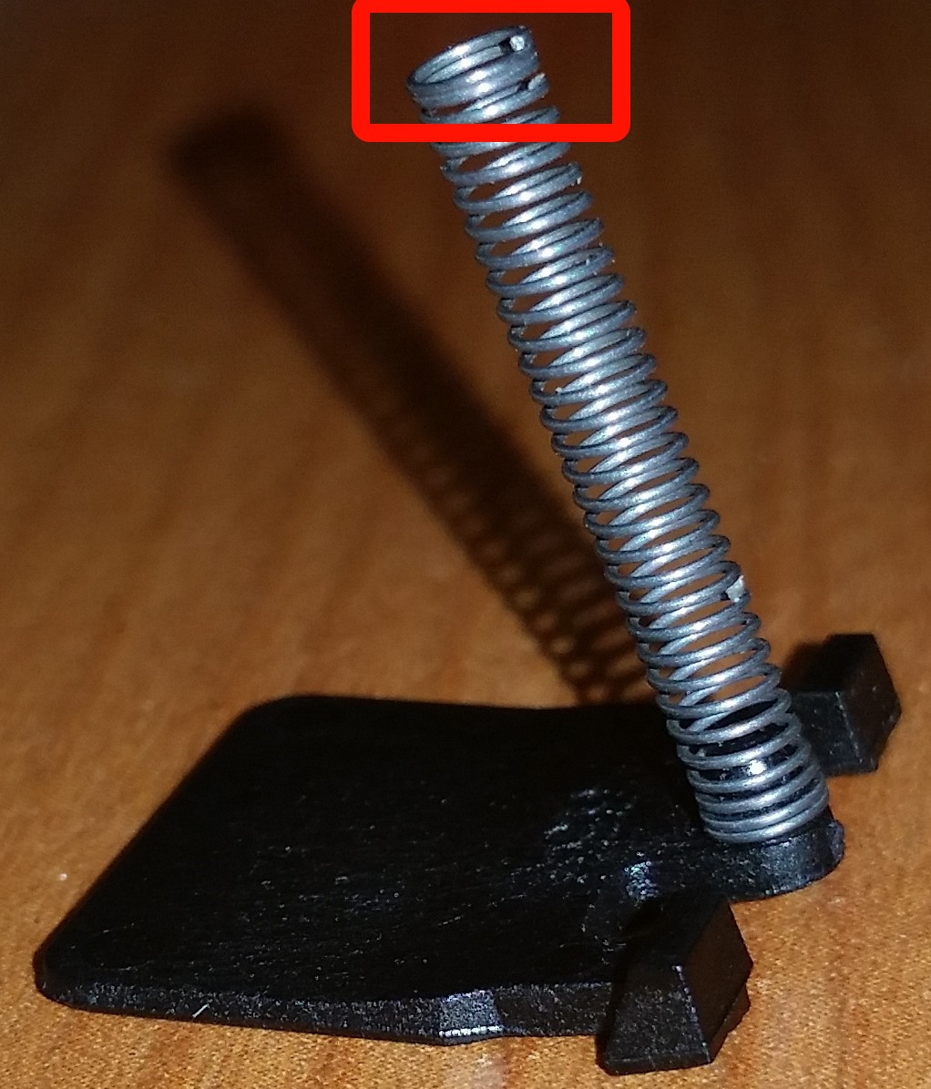

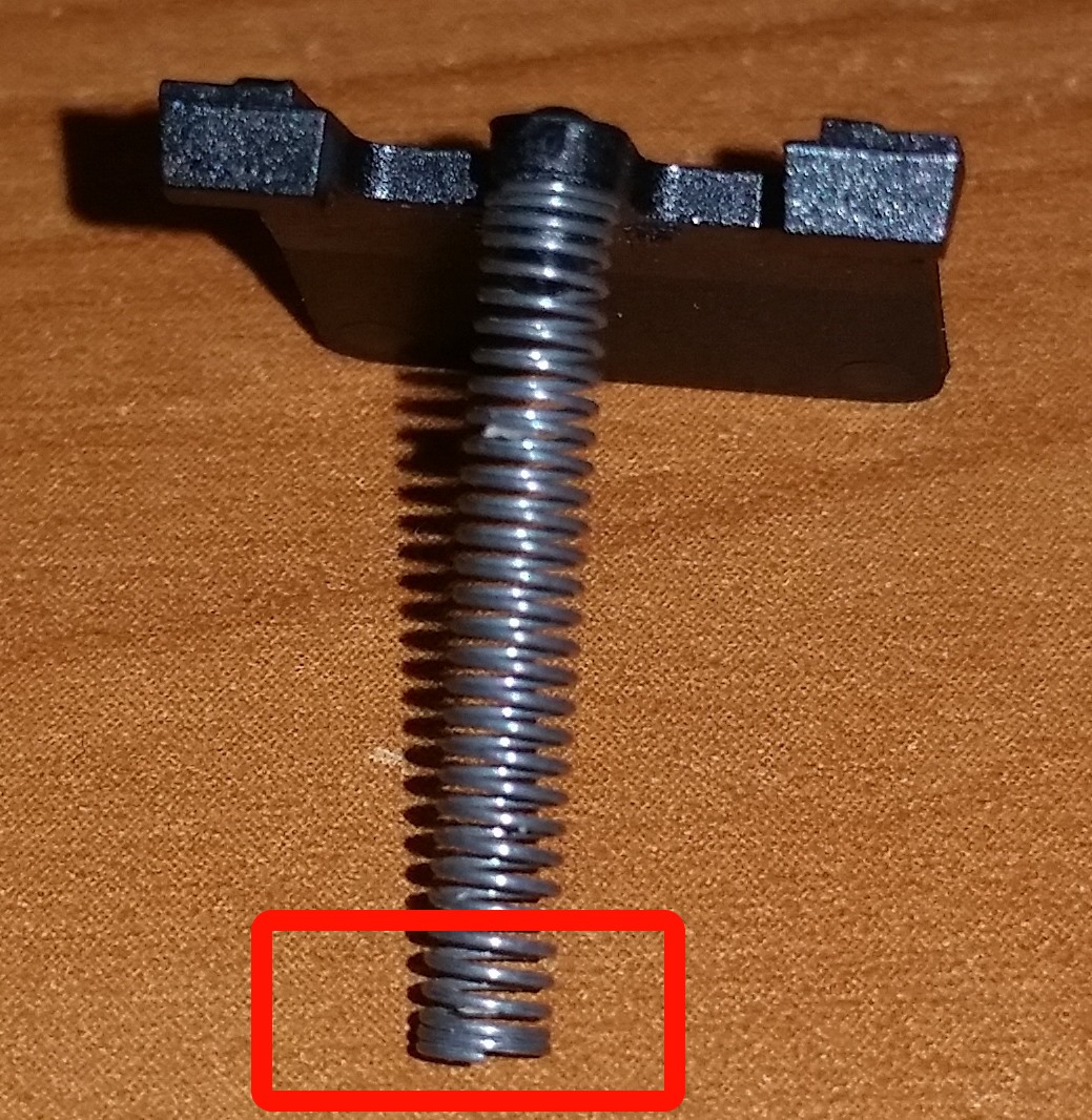

- function: all keys functioned right out of the box. No chatter and no
unresponsive keys. I noticed though that holding down the down-arrow
does not lead to a repeated down-arrow - instead I get one down arrow
scan code after I release the key. Re-seating this spring fixed the problem.
- build quality: Stellar. Unbelievable. Better than I remember this model-F AT that
I enjoyed using for a few weeks in '87 (computer lab of my college). Since '87 I
have not been able to even touch a keyboard of such fine quality. this is better than
I remember the F-AT. It is out of this world.
- key feel: no surprises here: much lighter than my Unicomp Model F. And yes:
crisp to the extreme.
- However: the unicomp keys caps create a "grainy" key travel feel and
the rod stabilizers of the left shift key and the return key don't really work. These
keys bind badly when pressed off center. I don't press these keys offcenter when
I touch-type - so it does not bother me too much. I hope (believe) that the final keycaps
will fix this.
- Sound: a class of its own. Not for everybody. I expected it from
what I remember from the F-AT and YouTube clips. But ... wow - hearing it in person
give this keyboard SUCH a vocal presence.
Do I recommend it?
It is probably not ideal for gaming and for office work it is probably too loud (unless
everybody else is a keyboard enthusiast).
But - if you are a typist and if you don't mind spending some money for a FANTASTIC
keyboard - then yes: this masterpiece of a keyboard reproduction is worth it - in my opinion.
I would buy it again. My Unicomp-M is a good board and my Mathias Quiet Click is a
good board too. But this Model-F puts them both to shame. Ellipse will go into keyboard
history :)
Compliments to the code author/maintainer of xwhatsit: skinny software - it does
exactly what is needed - no more and no less. No bloat and it also worked right out
of the box for me to re-assign scan codes to keys.

The xwhatsit solenoid drivers have arrived!

So I opened the assembly to be able to reseat the springs properly and ensure all spring ends are in the 12 o'clock position as shown in the video.
I wish I didn't bother. It's just worse than before. All the keys are barely tactile, even though the barrels don't wobble and the springs are in the proper positions.
Why...?
Ellipse
08 Jul 2020, 23:24
Wazrach that should only be done to a few keys at most, maybe 3 to 7 keys, in my experience. Your typing test video that you linked to earlier sounded great so I am not sure anything was significantly out of bounds. Also my QC secrets video specified stretching the springs and using tweezers to correct buzzing springs without opening up the keyboard. If you opened up the keyboard to adjust springs by hand, that was not what is recommended for bad sounding keys.
The assembly machines do precision placement of springs on the nubs and a bad placement causes a bad sound. You should leave a bit of space between the end of the spring and the bottom of the flipper nub. Maybe 0.2mm.
Below are photos of the correct end of spring location and spring-flipper positioning.
correct end of spring location for flippers and springs (1).jpg (349.69 KiB) Viewed 10638 times
correct end of spring location for flippers and springs (2).jpg (244.33 KiB) Viewed 10638 times
