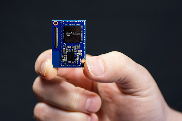

I've been thinking about the possibilities of using the Intel Edison. Imagine having wifi, bluetooth, USB (including host mode) and Linux inside your keyboard.

quantalume wrote: I've been thinking about the possibilities of using the Intel Edison. Imagine having wifi, bluetooth, USB (including host mode) and Linux inside your keyboard.
Wouldn't that take a felt eternity to boot?
Posted: 27 Oct 2014, 04:04
by quantalume
Arakula wrote: Wouldn't that take a felt eternity to boot?
It's pretty fast since it's a stripped-down version of Linux without a GUI. I haven't actually timed it yet though.
