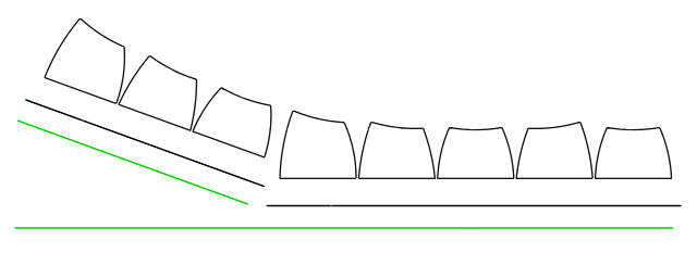

15 Dec 2013, 13:09
I've re-thought the Hyper7 and came to the following solution:
The front is on the right and the rear is on the left.
Using sphericals on a flat 8-row design leads to the problem that the last 3 rows are too low down and difficult to hit without touching the keys in front of them.
The 2-PCB-design has the advanatge that the keyboard can be shorter by at least 2 units, because the controller area and the traces leading to/from it can be below the 3 extra rows.
The angle of the 2nd PCB is at 20 degrees, so the angles of the key tops are:
33 27 20 13 7 0 -7 0
Now, that I know how to do it, I can draw the PCBs again ...
:roll:
