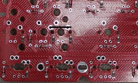

I sent a message to the maker (since I have the same problem), he said he forgot to put the wire to the 1800 shift. So we all have to wire the 1800 shift to the original shift. Sorry about that. :/
DanielT
29 Aug 2014, 14:59
No problem :) The first one who does that should make a photo of the hack, this way we have it documented :D
L.E: looking at the PCB I think I see where the missing trace is:

MrMen
29 Aug 2014, 15:16
It's really simple doing it like I did. I took only 10s.
Here are the pictures.
http://imgur.com/5g6pC9J
http://imgur.com/Dykhs6s

DanielT
29 Aug 2014, 15:23
So I was right about the position :D It's a really simple fix. Thanks for sharing :)
