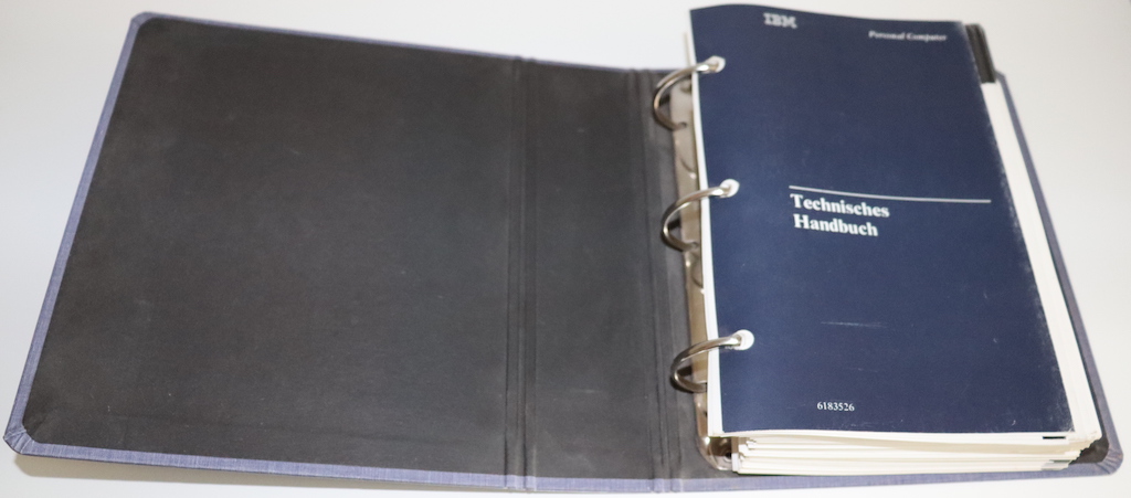

I constantly make changes and updates to the PDF (link: http://www.linux-tin.org/ModelFManual.pdf)
For those who are interested, the IBM technical manuals from the 1980ies did look like this (here one in German):

darkcruix wrote: 17 Aug 2020, 13:25 I've played around with content and design language of the original IBM Technical Reference manuals and wanted to share a very early draft version of what I would enjoy owning.
Obviously I used information that is out there already (referenced in the footnotes) and added my pictures and graphics.
For the moment, I create it for my own joy, but wanted to get some feedback, if there is some interest out there in helping to add content, correct things, help in the design, correct any references I missed, etc

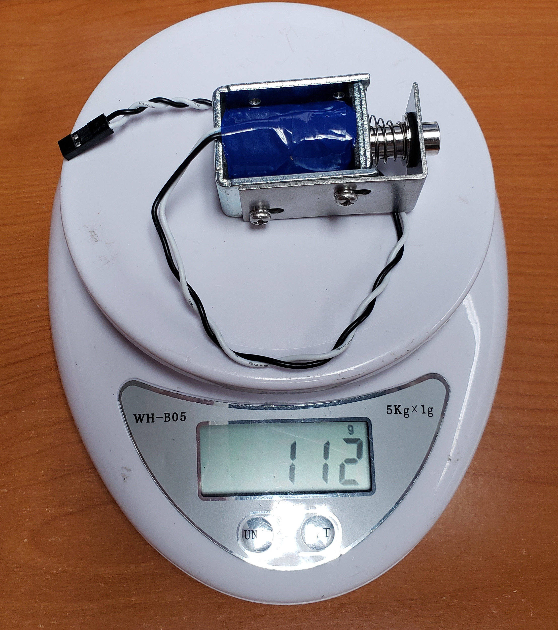

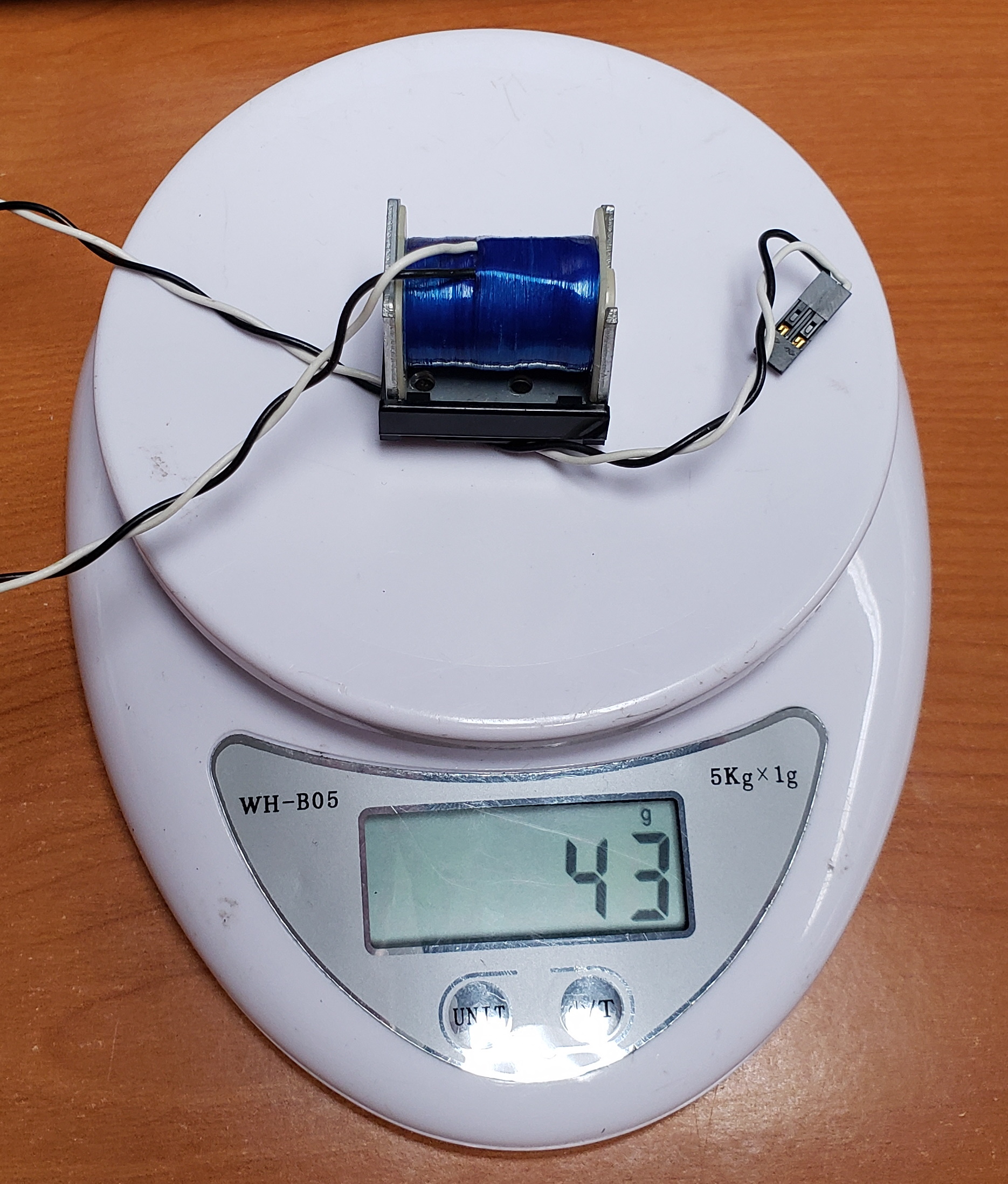

A few of the production solenoids arrived and they are excellent!
The solenoids are more than double the weight of the original IBM beam spring solenoid in one of my 3278 keyboards.
The adjustable stroke of the new solenoids works well. At full stroke (5mm) the solenoid is at its heftiest. The solenoid was also well engineered and was able to keep up even at full stroke with my typing of 90 wpm without noticeable queueing of clicks (I prefer the 5mm maximum stroke setting. The factory default setting is 0.5mm which produces a more comparable stroke to the original solenoids). It was set to 25ms extend, 50ms retract in the xwhatsit controller settings.
Currently 90 solenoids and 106 solenoid drivers have been ordered. Both are still available to order!

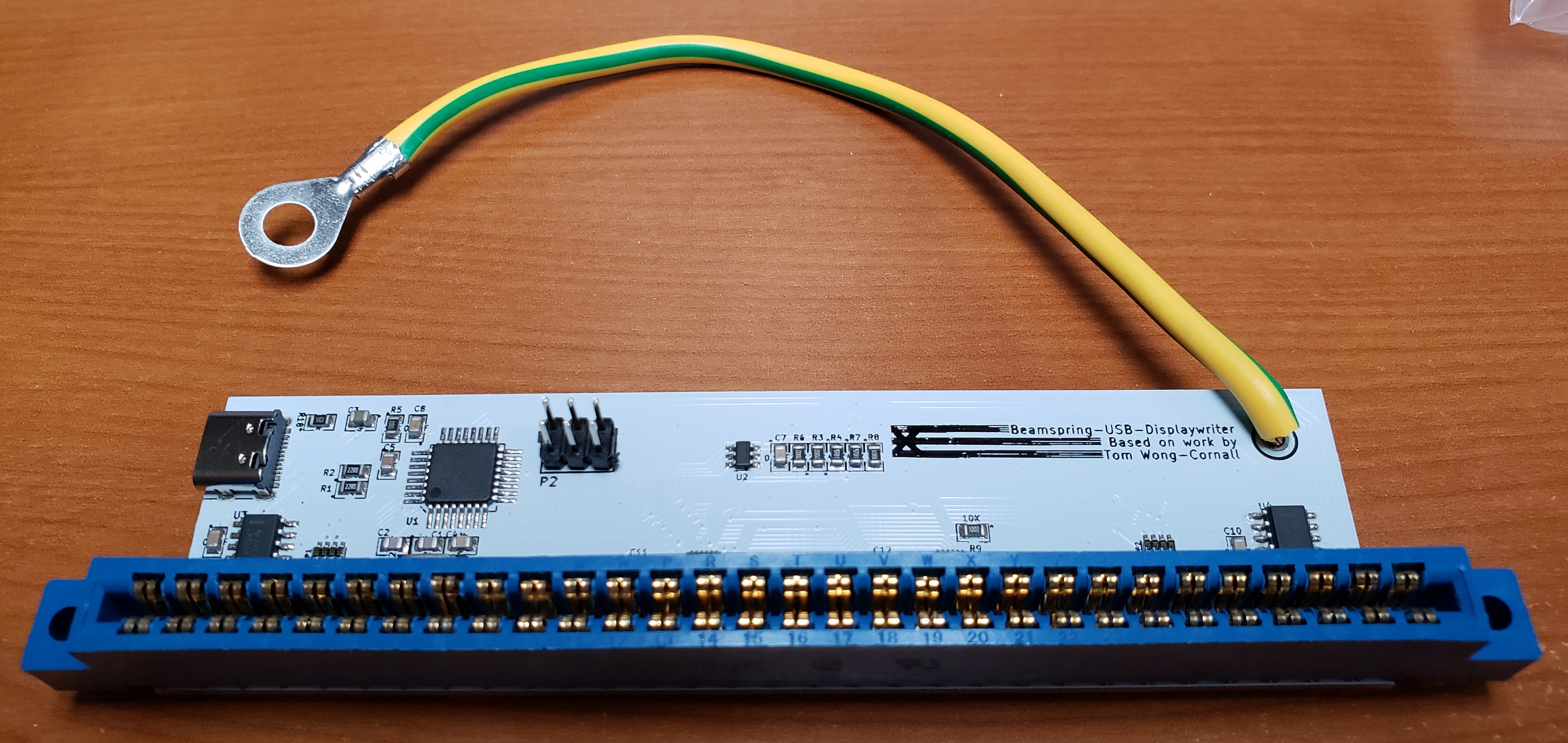

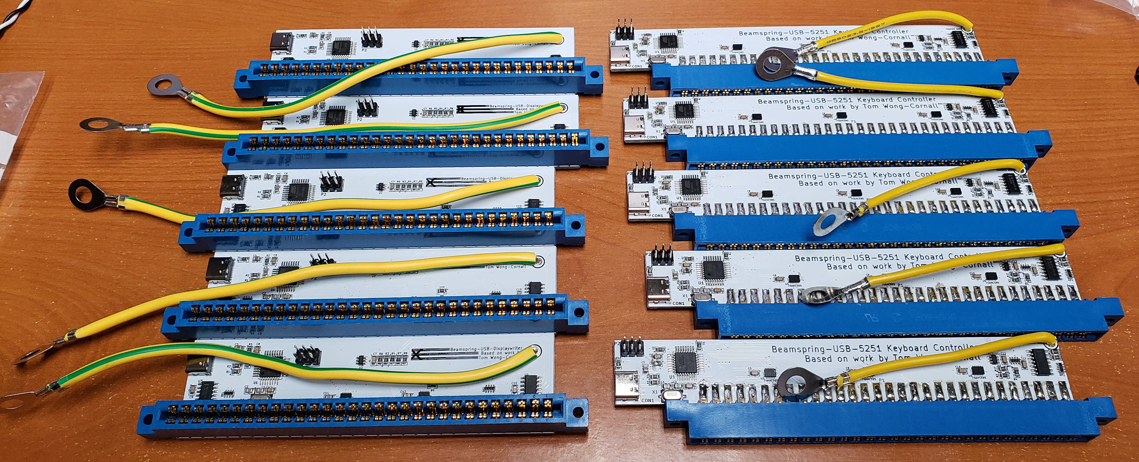

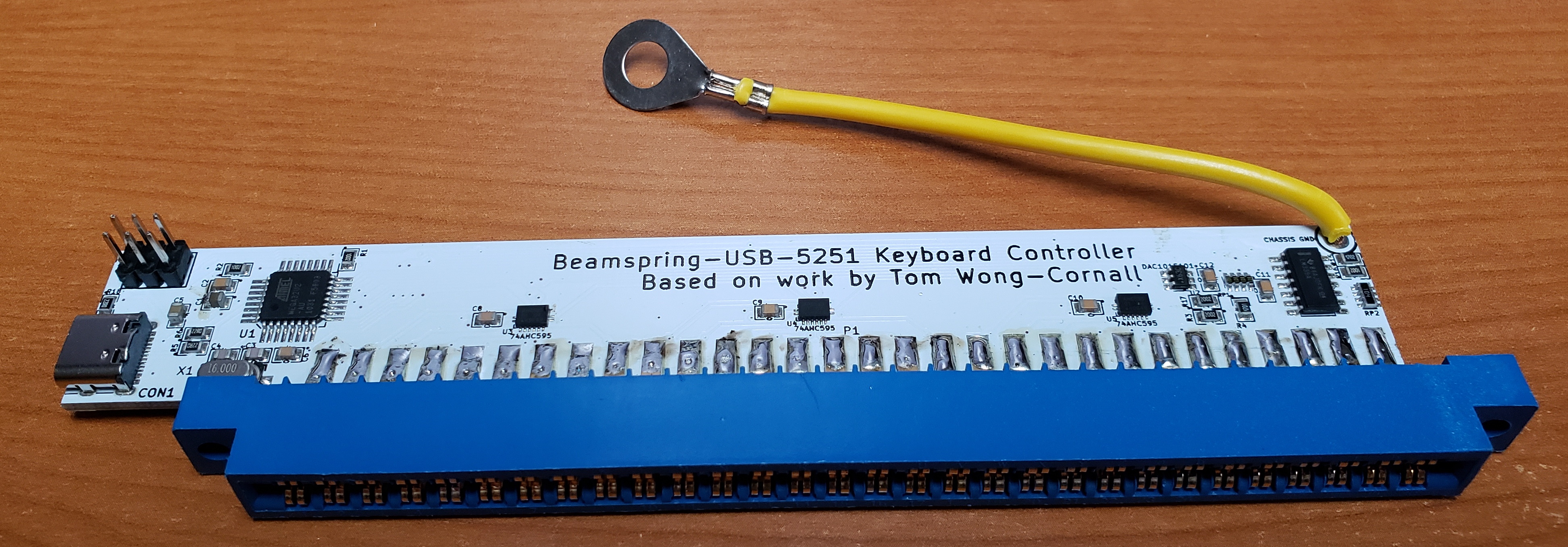

Also a few of the new USB-C beam spring and beam spring - displaywriter controllers arrived!
They all have tested good, except one which has a bad row (not sure if a component is bad or if some reflowing will fix the issue - any recommendations from SMT soldering experts out there?).

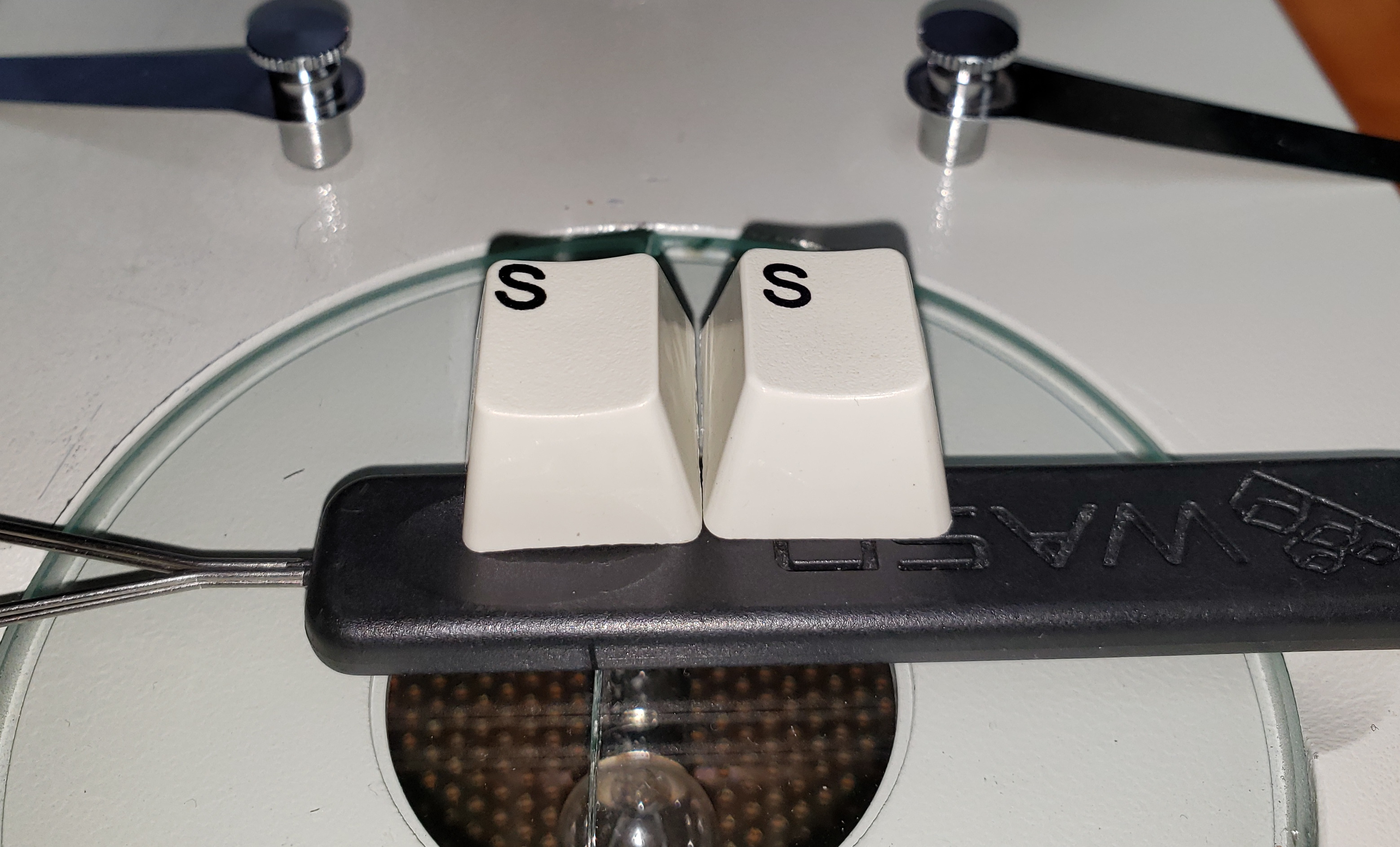

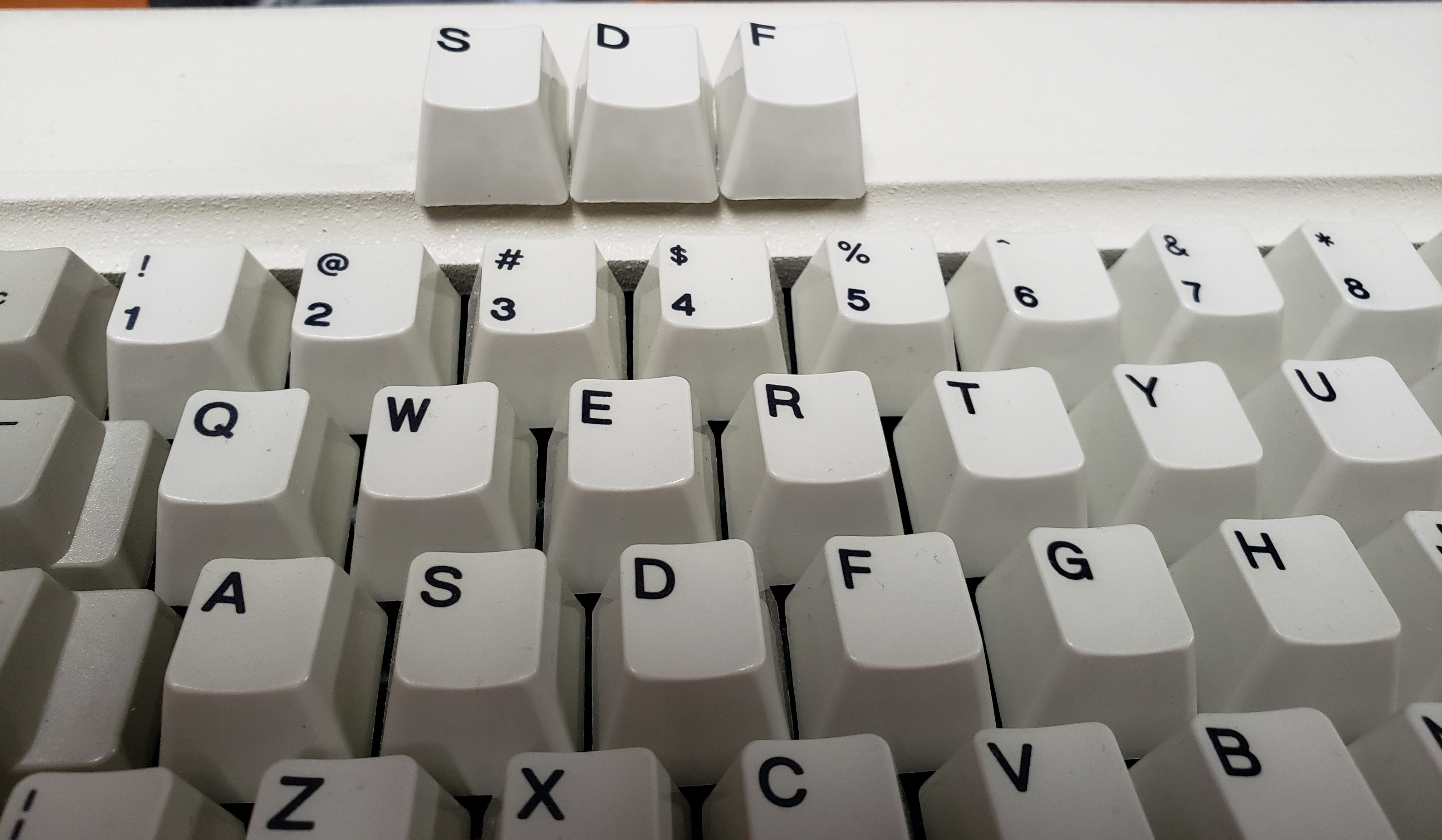

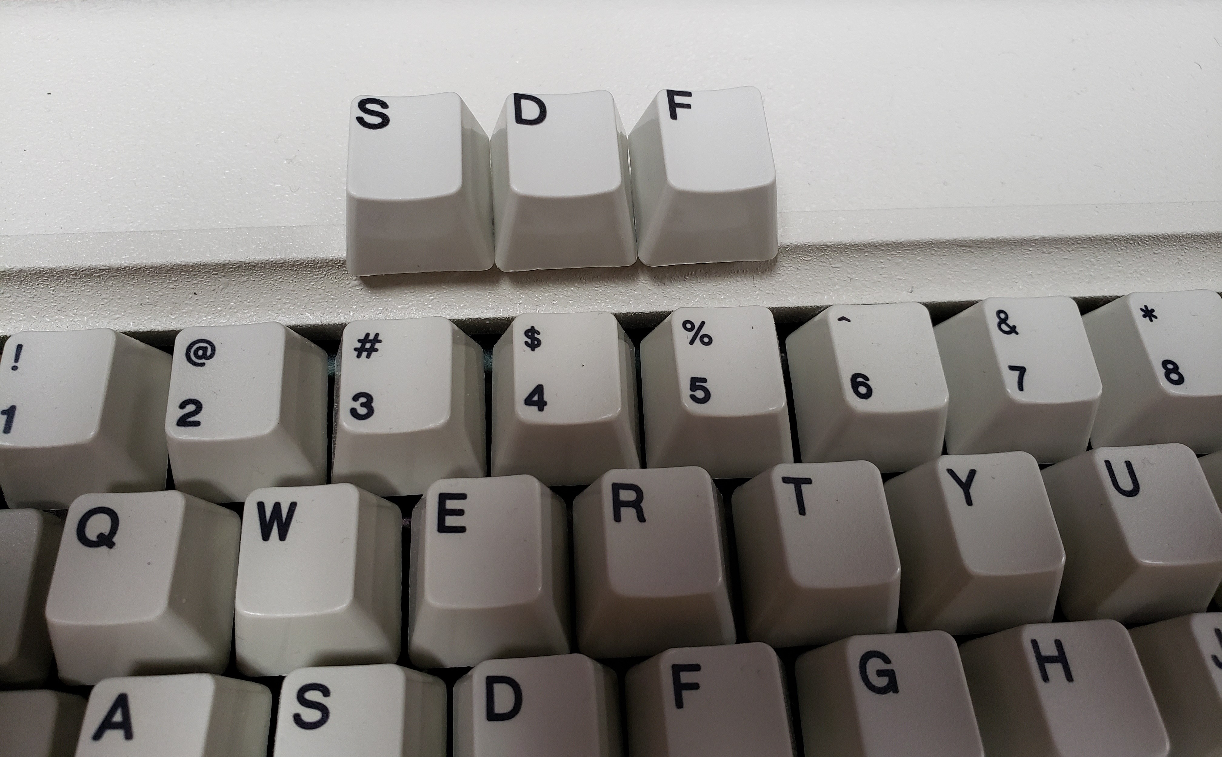

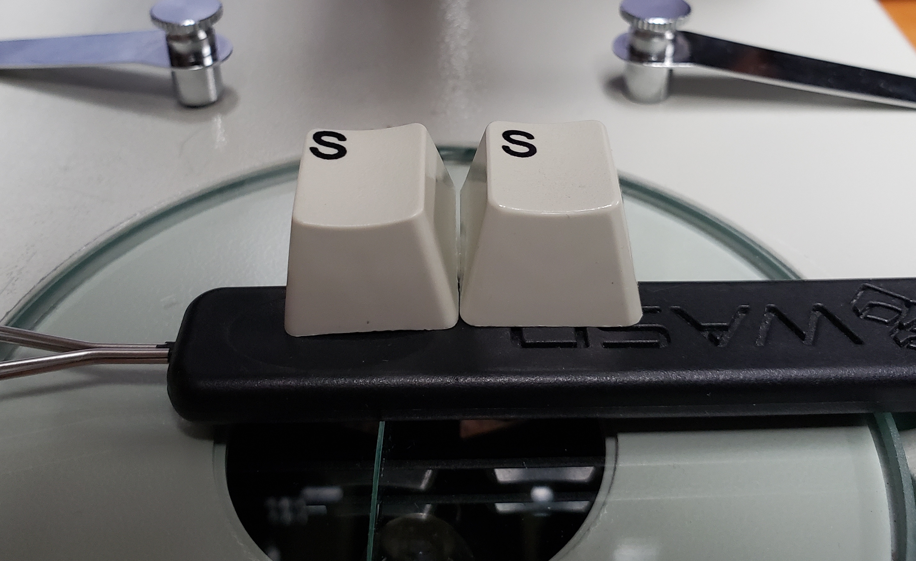

Dye sublimation update - excellent progress:
The factory has done an outstanding job with the latest key samples. They seem to have perfected the various variables to get a good quality result.
On my Meiji stereo microscope it is almost impossible to tell the difference in sublimation quality (sharpness, color quality) from my top reference standard F122 from 1984. I was surprised that there was nearly zero off color bleed / dye migration in the new samples, while even my '84 keys had a tiny amount of this only visible on the scope.
Right now you can tell the difference from the originals due to the poor legend alignment which is far from approved.
I have just approved the sublimation quality of these samples. The next steps are for the factory to work on the alignment which involves more work on the jigs.
Below are some (slightly out of focus) phone photos below - hope to post some high res scans from my Epson V700 soon. It compares the 3 new S D F key samples to original IBM XT keys (installed on the keyboard) and the S key borrowed from my reference F122.
The legends are a bit too thick and will require adjustment to match the originals.

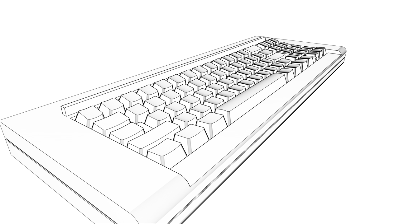

OxC0FFEE wrote: 18 Aug 2020, 20:58
Zcool31 wrote: 15 Aug 2020, 23:22 Shaders are awesome! Was screwing around with them and got this effect.
WOW. Something like that would make a lovely inside front/back cover, or multiple glamour close-up in that style in between sections.
Glad you liked it. The model used there was horrible. I couldn't find any 3D models of the Kishsaver, so I did one myself.
All the dimensions and angles are rough guesses, and the keycap shape is slightly wrong. I'd appreciate corrections.

Ellipse wrote: 19 Aug 2020, 02:01 Also a few of the new USB-C beam spring and beam spring - displaywriter controllers arrived!
Ellipse, I have a 5251 with an xwhatsit controller I bought on ebay. While it works, it's exceedingly finicky. Any tiny jolt or movement of the keyboard and there's a decent chance that keys or rows will stop registering correctly, and I have to re-seat the controller pins. While I wouldn't call it loose fit, the connection between the controller and the keyboard PCB isn't very tight at all.
Is this a common occurrence, or does that sound like something that could be remedied by a replacement controller? They're pretty pricey, so I'm trying to avoid that if possible. I've also considered wire-soldering the board to the controller, but that's not an ideal solution.
I was going to PM this question but thought someone else might benefit from the exchange. Thank you sir.
Ellipse
20 Aug 2020, 05:18
Lagomorph the new USB-C beam spring controllers have card edge connectors that are tighter fitting to the beam spring capacitive PCBs. The fit of one of these new controllers is properly tight to my 3278 beam spring controller. The older controllers were a bit looser fitting, maybe due to using molds that needed retooling, though I never had an issue with a loose connection.
Also you have to dremel or file down the edge of the right side of the card edge connector for some models but not for others because of the shape of the IBM PCB. Yes for the 3278's and not sure on the others.

Zcool31
20 Aug 2020, 15:07
Fixed the keycap shape. The spacebar now has the proper hump.
