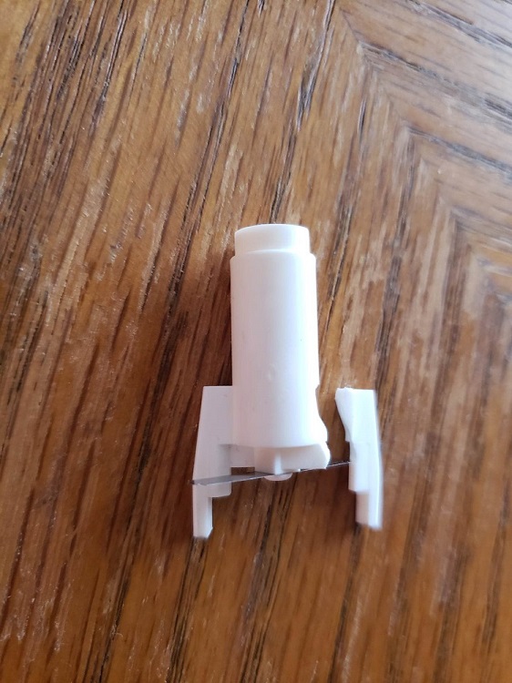

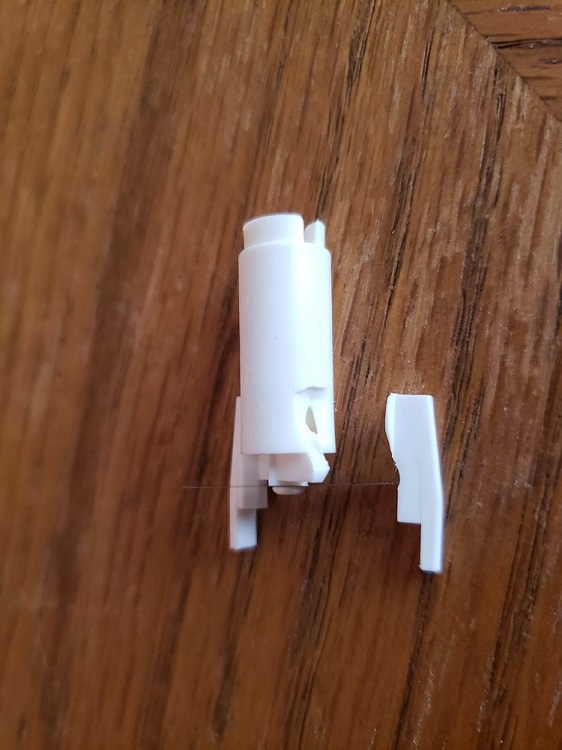

@Ellipse. Are the R1 switch stem legs prone to breakage during shipping or from mounting keycaps with too much force? It's rare but I've seen the legs break off during shipping and noticed the compact R1 stems have less material to reinforce the stem legs (less material relative to IBM stems).
- 327873258_1567331300398105_2096527335999875835_n.jpg (133.8 KiB) Viewed 37542 times
- 327347544_911396226653928_2852161015698614960_n.jpg (106.81 KiB) Viewed 37542 times

Mods: This needs a NSFW tagtron wrote: 15 Feb 2023, 17:50 @Ellipse. Are the R1 switch stem legs prone to breakage during shipping or from mounting keycaps with too much force? It's rare but I've seen the legs break off during shipping and noticed the compact R1 stems have less material to reinforce the stem legs (less material relative to IBM stems).

@JP! I didn’t mean for the post to come off as inflammatory, the stem legs are easy to fix with super glue. I’m just curious if the stem leg breakage I've experienced is primarily due to old/brittle plastic or a potential issue with shipping any beamspring keyboard.JP! wrote: 15 Feb 2023, 18:19Mods: This needs a NSFW tagtron wrote: 15 Feb 2023, 17:50 @Ellipse. Are the R1 switch stem legs prone to breakage during shipping or from mounting keycaps with too much force? It's rare but I've seen the legs break off during shipping and noticed the compact R1 stems have less material to reinforce the stem legs (less material relative to IBM stems).![]()

Yes, I know of at least one example where a leg ("beam barrel part B" - the white color plastic part) broke off in shipping while installed in a module, so it can definitely happen to both original and reproduction beam spring keyboards. I show this particular example in the beam spring setup video posted some weeks ago.
The roughness of shipping in recent years is one main reason why each beam spring keyboard is getting free modules as part of the mini first aid kit for beam spring keyboards, plus I replace broken modules under the limited warranty as described on the product page.

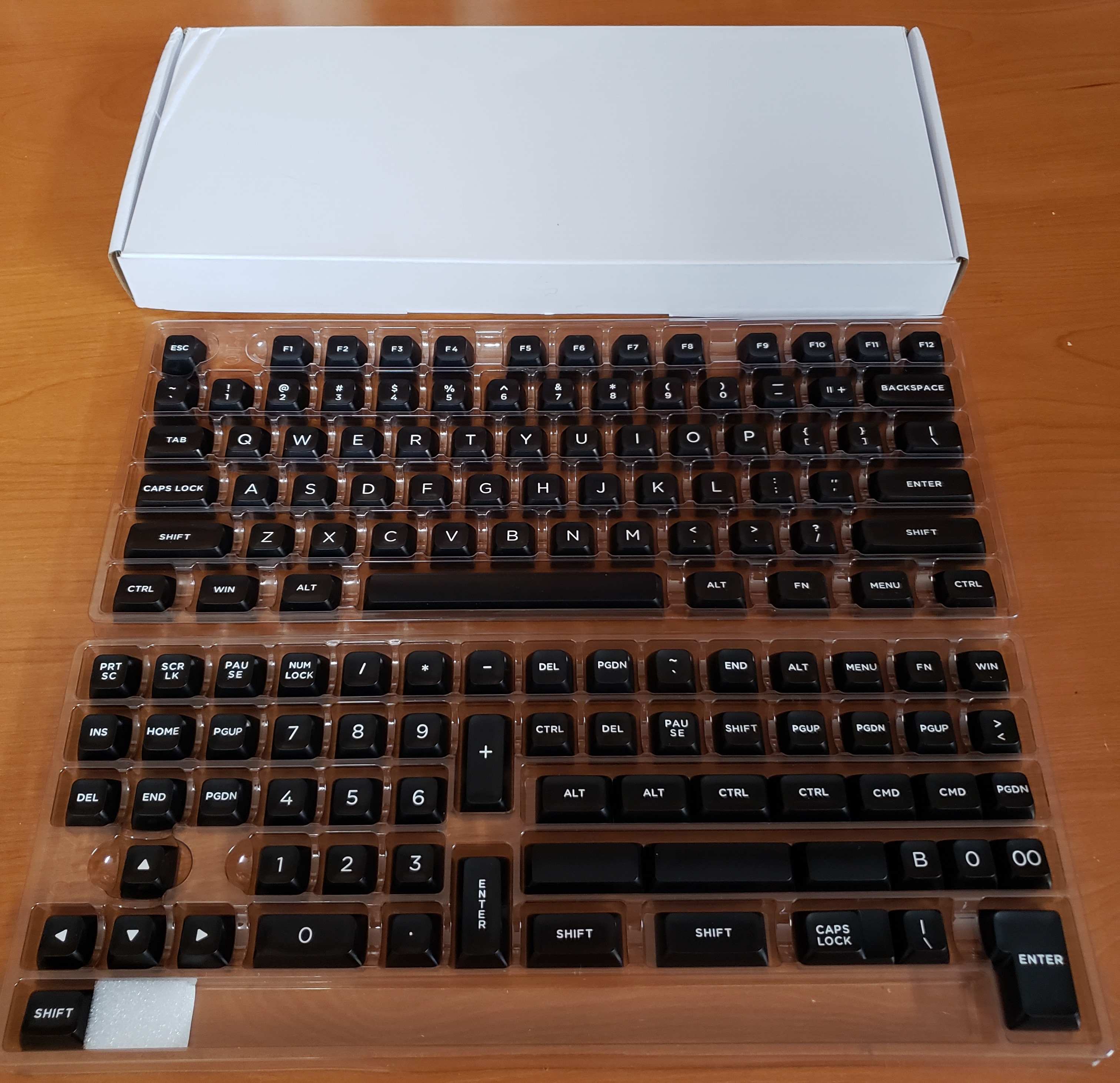

The custom double shot PBT set with all black keycaps and white text came out nicely - this is the finalized production set (the prior set had additional sample keys not part of the set, as noted earlier):
This set is available separately in the shop for other MX keyboards as it is a standard Cherry MX compatible set.

As noted earlier the keys are a custom profile not in line with any standard MX keycap profile. As shown in the photos the keys are quite flat relative to each other but do vary slightly in row height, from about 9.5 to 11.5mm from what I can see. So I guess they would be called very slightly sculpted? You can see the relative key heights in these photos of the keys installed on a new beam round 1 board:

They are offered in the same case colors as the compact F cases (industrial gray, black, off-white/beige, dark blue, light blue, and red). For the other colors the tooling and paint mixing costs would be several hundred dollars so I would recommend taking the case to a local powdercoating company if you'd like another color.
Regarding keycap colors the minimum order quantity is 1,000 sets per color scheme, which is why there are only two color schemes (total 2,000 key sets).

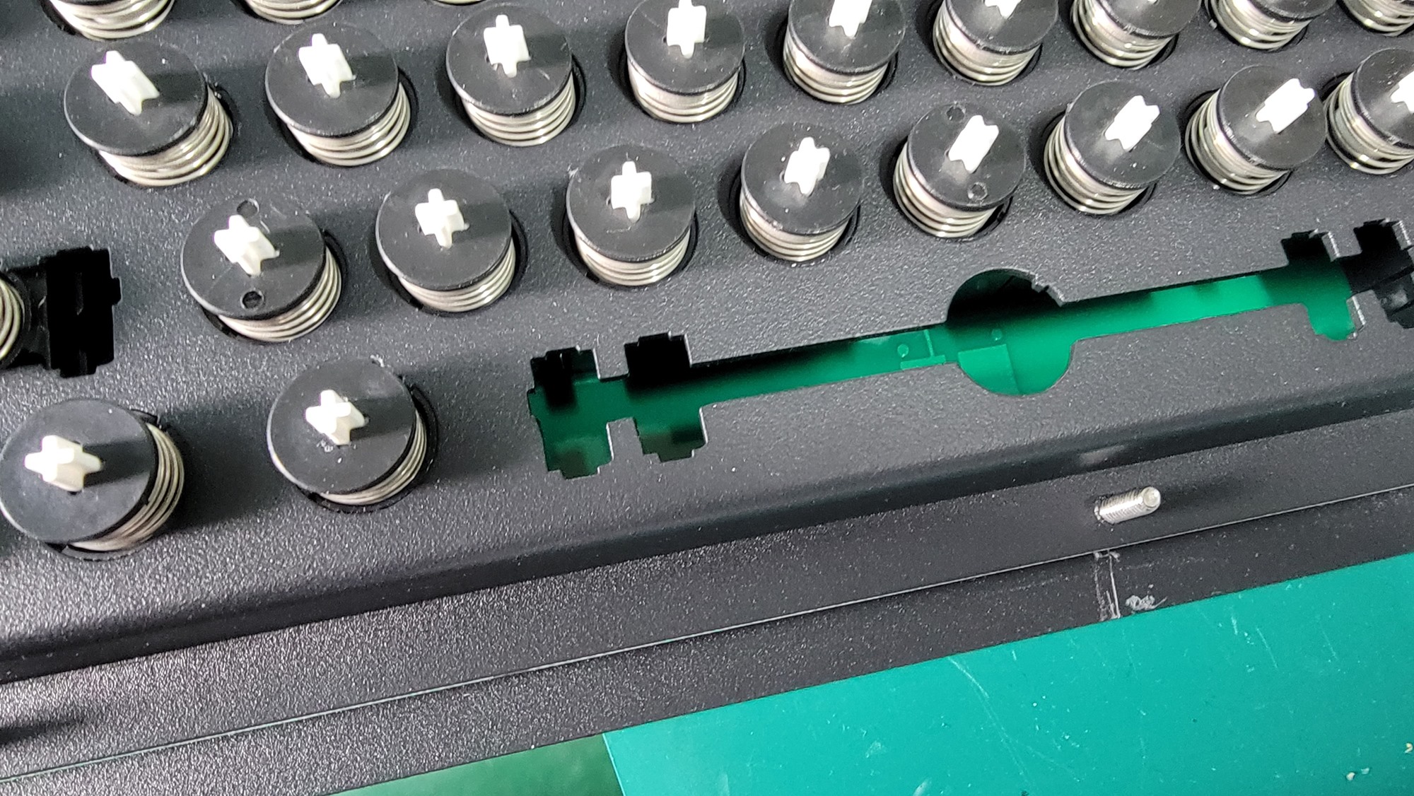

Important Keycap Removal note (not in the setup video), now that the beam spring Round 1 boards have started shipping:
I use a wire key puller with gentle rocking motion and have no issues removing the caps. The keycaps cannot be pulled up fast in one motion. If you are using a lot of strength to pull them straight up or twist them, then you will most certainly break the modules. One user reported that they broke a number of their modules this way.

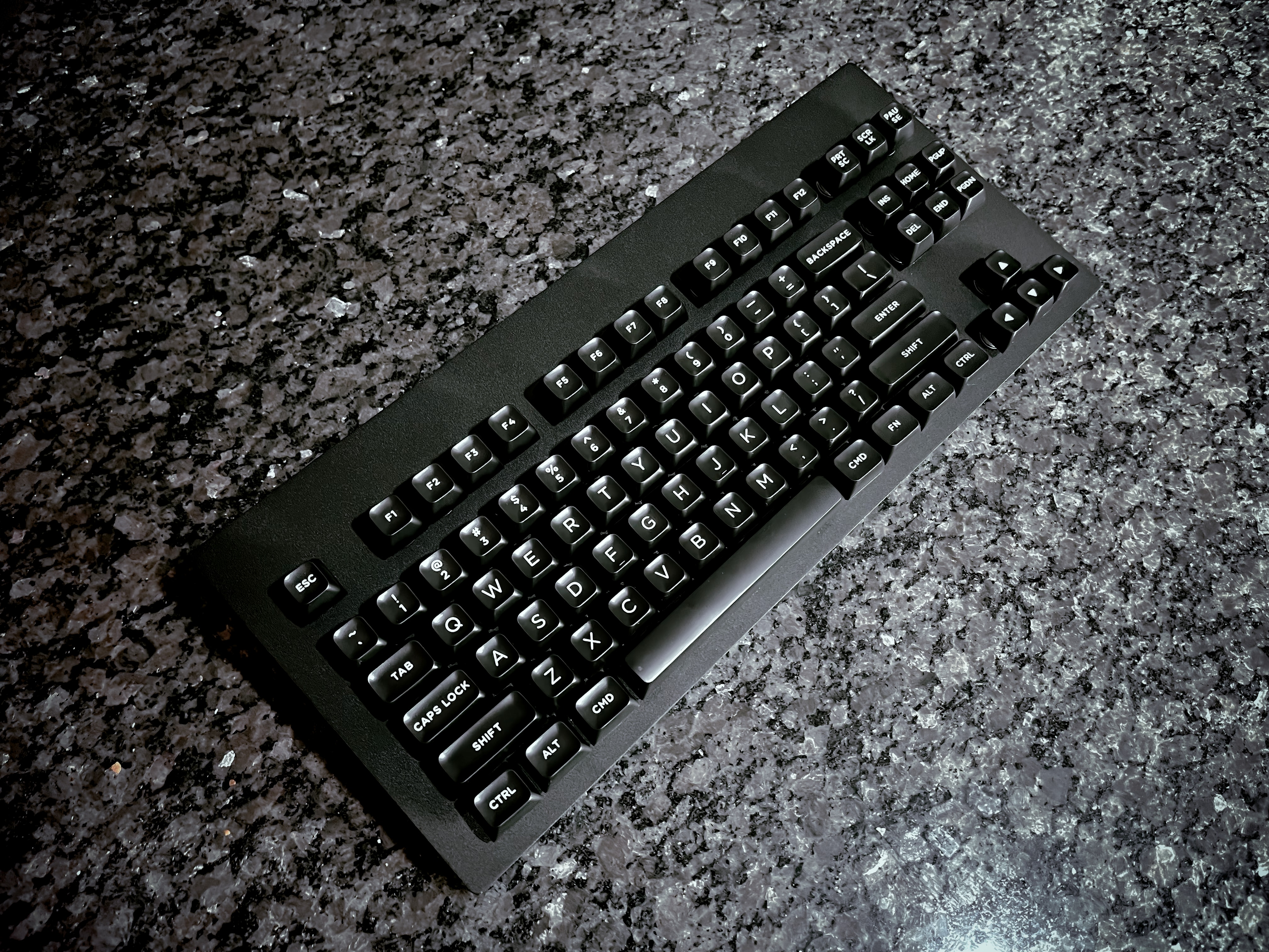

Rena
- Location: USA
- Main keyboard: Tope Realforce R2
- Main mouse: Glorious Model O
- Favorite switch: Topre
Shipping:Ellipse wrote: 23 Mar 2023, 18:30 Great Rena! The first photo of these boards out there! Please do share your experience following the setup video and setting things up. How many switches needed replacement? How is the key feel? Did you notice any shipping damage to the box or contents?
Everything arrived safely/without damage, there were a few dents/scratches on the main shipping box but nothing alarming or noteworthy. Key caps in the separate boxes were all undamaged and packed securely.
Setup experience:
The setup experience was great, I might have been lucky, but I tested each pre-installed switch several times and had no issues with stuck or off feeling switches so I didn't need to replace any of them or do the wiggle method. Adding the keycaps was an easy process. I did have to remove and swap out some key caps for my layout and I was very careful to wiggle back and forth until they came off instead of pulling straight out. Plugged it into my PC and everything was good to go!
EDIT: Since using this I have noticed some keys that felt off a bit, using the wiggle method in the video has solved them though.
Key feel:
I'm not great at reviewing switches but my first thought was "Wow!", this is the type of feeling I was hoping for when I purchased the Model F77. The Model F is still great, but I can see why others consider this a "step up". Each key feels distinct and "heavy"(?). It does feel like you're typing on a typewriter. I think it will take a few days to get up to speed with it, I'm not as fast as I was with the Model F, but this definitely feels more "fun" to type on if that makes sense at all.
I also enjoy the sound a lot more than the sound from the F77. It's louder I think but it doesn't have a "ping" sound that the F77 had.
